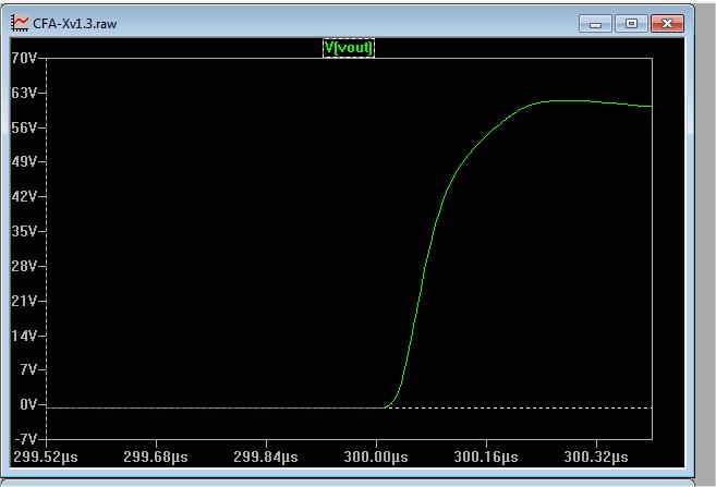

At 10p/22k shunt , the sim says 50V in .05uS (1 kv !) of course , with the input filter and a non- ringing output, 300-400v is enough ... but it CAN do it (1k).
NO other sim can go that fast 😀. I like - (it simple).
PS - builders have said that faster sounds better , who am I to argue ?

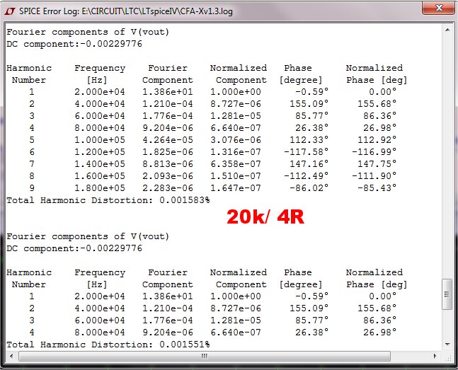

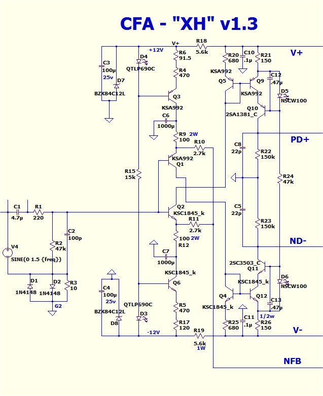

Yup - I'm on the PCB now !
(below) is the optimum circuit.
below 2 is 1k
below 3 is 20k.
On both , first 4 harmonics thd IS nearly the same as
all 9. This must mean almost NO H5 + .
5 ppm at 1k/ 100v p-p is really good for this simplicity level. 😎

In order to improve noise performance I would lower R2 to 10-22 k and decouple D3, D4 since they have quite high inherent noise voltage. 😉

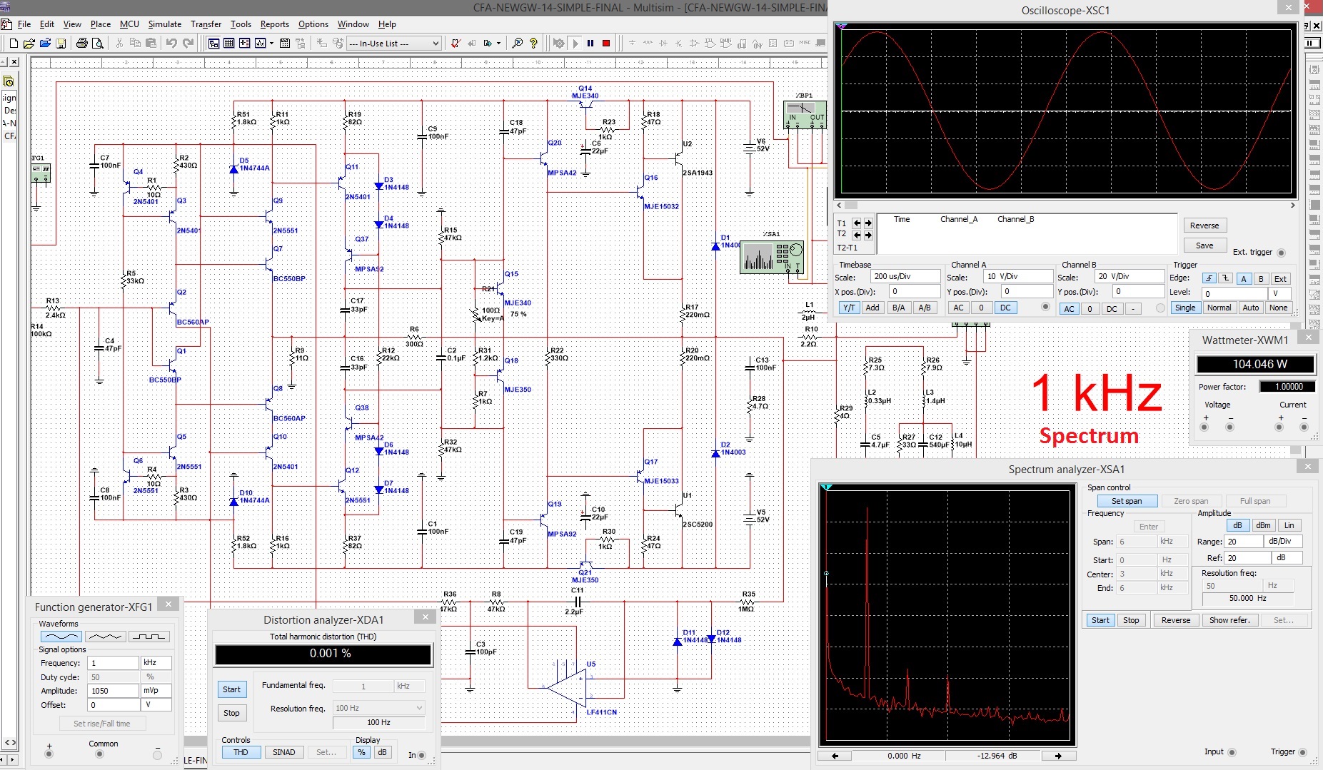

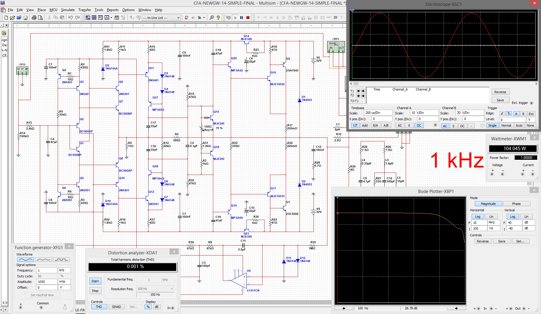

Just make sure you drive it with a decent signal source since its unbuffered!

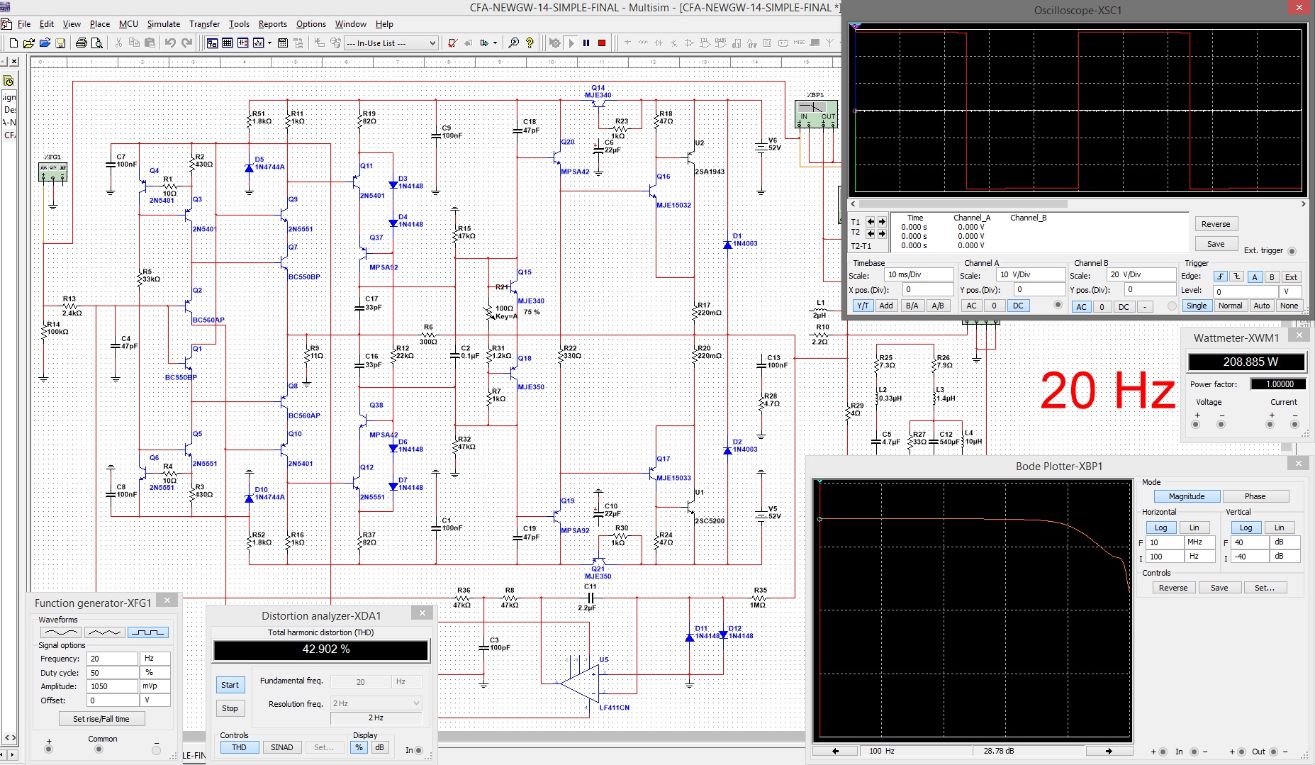

Could you show some simulated data, distortion, loop gain, square wave...?
OK, here are some simulations:
4 pictures with sine wave 20Hz, 1kHz, 20kHz, 50kHz
4 pictures with square - same 20Hz, 1kHz, 20kHz, 50kHz
1 picture with 1 kHz spectrum
1 picture with open loop (no compensation either)
It will be possible to audition the prototype open loop - linear enough for decent sound 😉

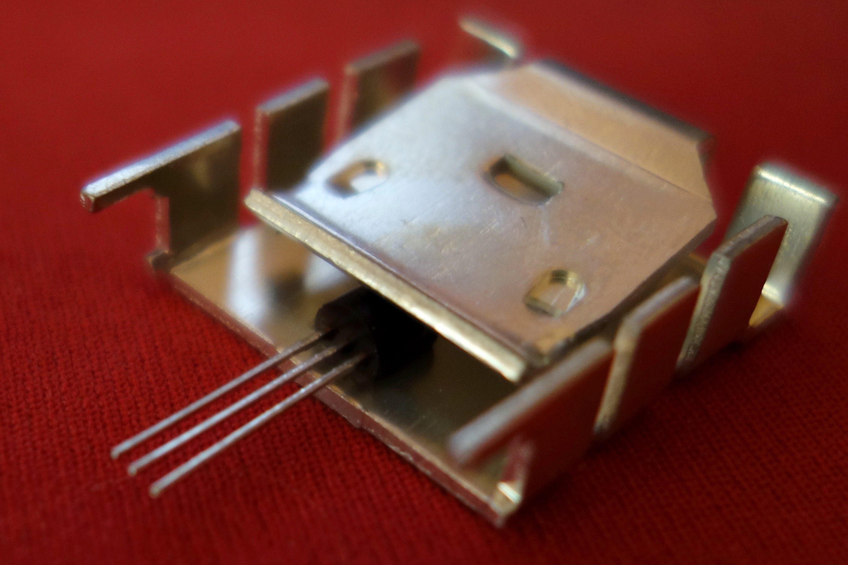

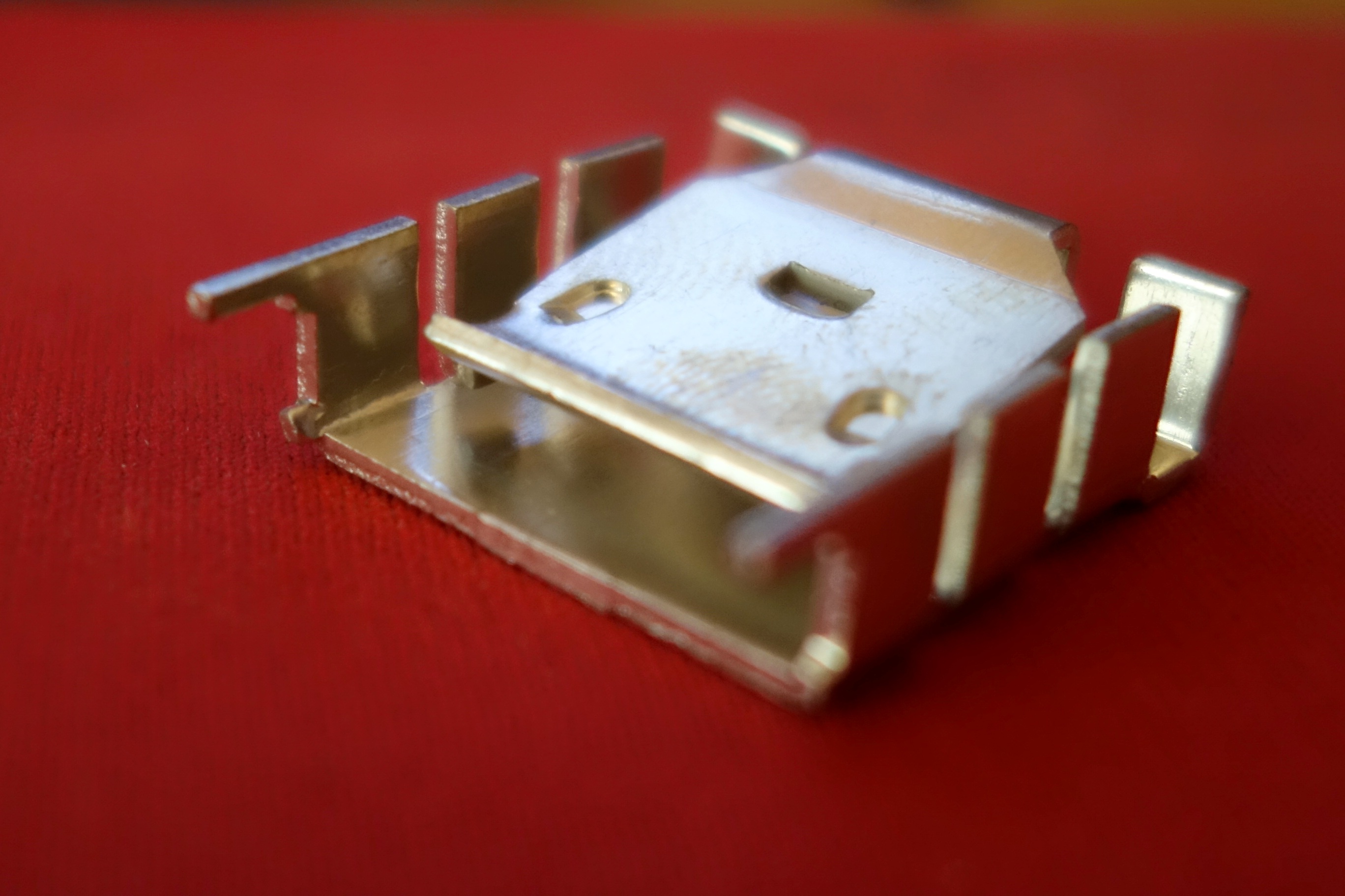

It is difficult to find heat sink for TO-92 device. Or you can make it your self, but I can not....
Last summer I've got excellent small aluminium heatsinks from Poland.
Works perfectly with both TO-126 and TO-92.
Strongly recommend something similar...
