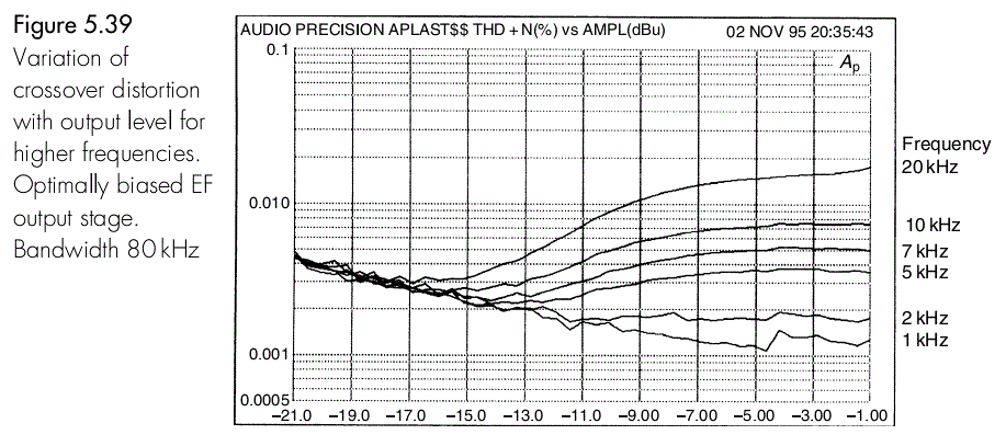

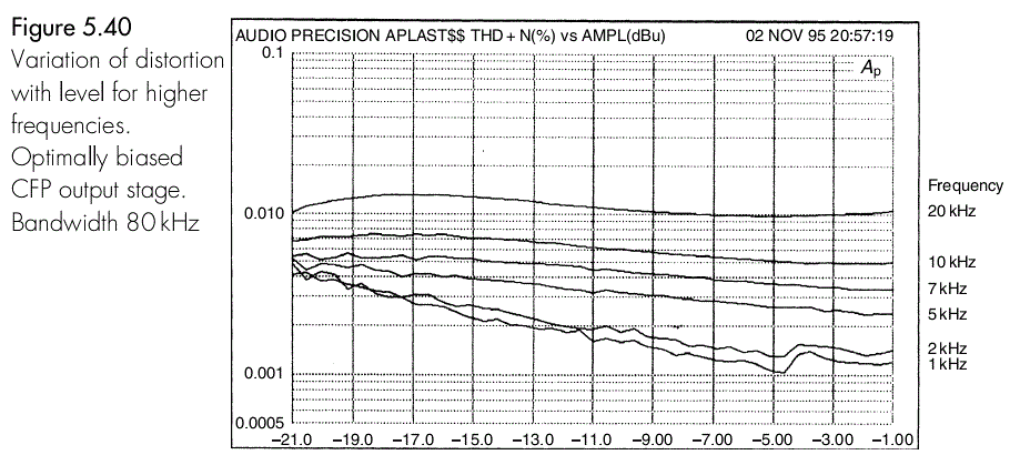

Also CFP amps have poorer performance at lower levels. The 2 pics are from Self's 4th edition. Can anyone with the latest 5th edition see if he's done anymore 'real life' work on this?
Better still .. has anyone here done any 'real life' work on this?

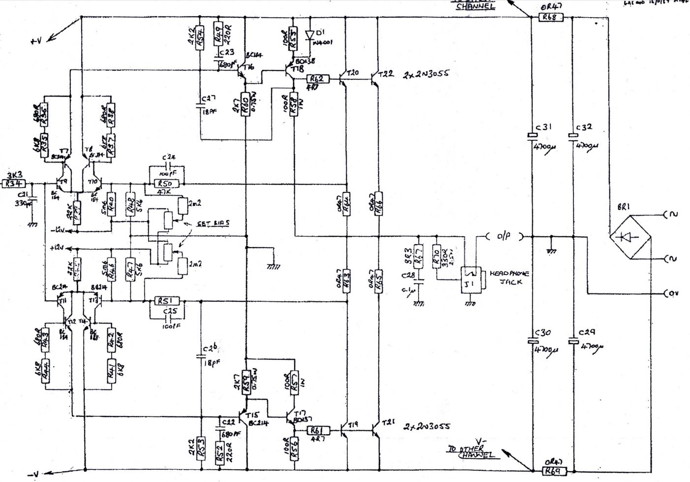

Musical Fidelity B1
Alternative approach to bias management.
Musical Fidelity A1 / B1. No thermal feedback (thus no inertia related to it). Instead - OPS current sensing. Separate global NFB loops and individual bias setting for each shoulder.
Not sure this is the way to go, however - interesting approach...
The A1 is a Class A amp. Easy to set & maintain bias. Dunno what a B1 is but the circuit looks like it is AB with huge bias. Again no problem. See Self for 'how to'.

There are EF2 amps which don't do this and I've designed one or two myself to get around this.
Self is worth reading for the tools to design this but he doesn't get all his priorities right as far as bias thermal management goes. Bob Cordell also has good stuff on this.
I've never seen a CFP amp that doesn't suffer this. Marshy's 'low THD valley' is too narrow to sit there under all conditions. I'm sure Bob has also seen this phenomena.
EF2's 'valley' is much wider and easier for mere mortals to get right.
