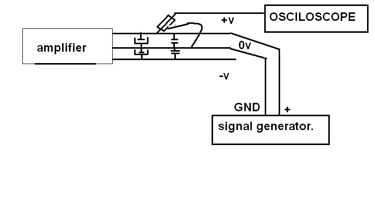

This is how I do it: Just take an amp you have sitting around with both film decoupling and large reservoirs on the board, drain the reservoirs, and inject a square wave from a signal generator across the rails. The circuit doesn't need to be on for you to observe the resonance. Just don't send DC into the input of your signal generator. Probe across the rails with your oscilloscope and watch the ringing. You may have to turn the signal generator voltage up to get a clear trace. I used 10V with a 50R output impedance which is 200mA. I also used the offset voltage function to check if the ringing changed with some bias voltage - maybe slightly.
I did this with a TDA7297 kit gifted to me by a friend. It came with a 5mm 100nF decoupler and a 2200u reservoir. The resonance was 3.3MHz. I damped that and sibilance decreased. I replaced the cap with a 5mm 1u decoupler on the same pad, so inductance was the same, and then damped that with a 100V/47u Nichicon VR (it was the junk cap that worked based on measurements). I have another chipamp I damped with 50V 4.7uF caps; it had 5mm 100nF film decouplers and long traces (inductors) between them and the 220uF reservoirs.

Do you mean something like this?

What I wonder though is whether these resonances ever occur in the typical audio power supply.
Jan
Absolutely. How do you put an inductor and capacitor in a loop without damping and NOT get a resonator? It can and does happen all the time. Now if the only caps on your board are a 22uF lytic and a 1uF film cap, then the film will probably be damped well, and I've seen boards like this, but usually people put reservoirs very close to the amp and this is what closes a low-resistance inductive loop through the film cap.

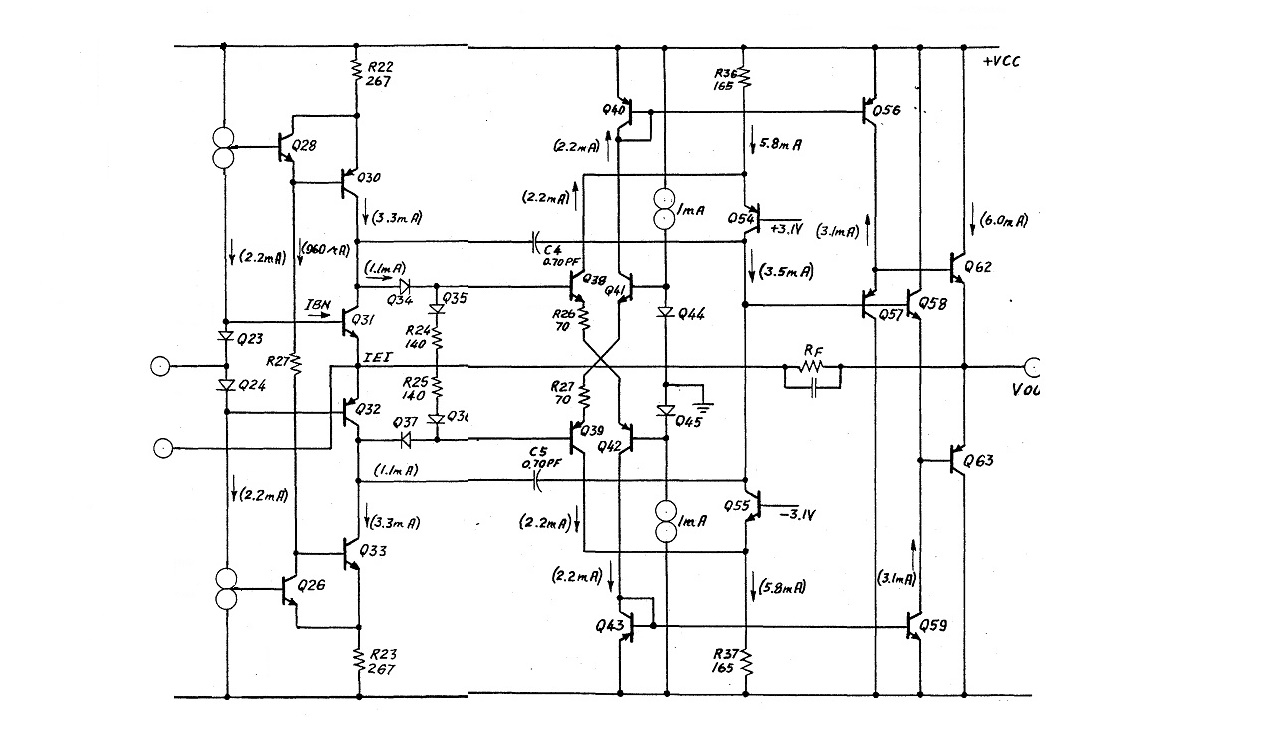

Anyone tried any enhanched type CFA topologies ?? So far only bog standard stuff has been shown.
How about this ?? , Scott should recognise this.
