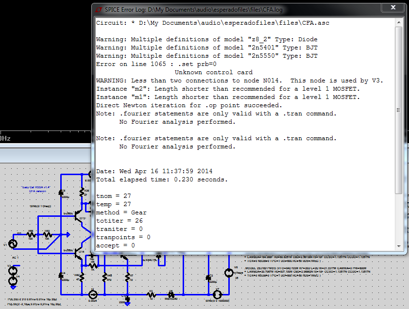

I pointed out that these sims are relying on models that you aren't linking properly for clean LTspice installations, have circuit probelms
http://www.diyaudio.com/forums/solid-state/218689-cfb-topology-superior-why-20.html#post3207545
you still don't have it right - this computer is only a month old - so my LTspice is new, no mods to its libs

Yeah, those LFET models are bad, they aren't the right format for LTSpice. Use Cordell's K1056/J162 models.
