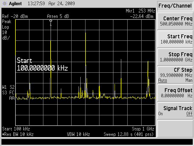

I was shocked a few years ago at how big the oscillations on my cascode circuit were. I would never have seen this without a wideband scope (180 MHz at c. 800~900 mV pk-pk)
So this is whay I am interested in Keantokens findings - of course its a different mechanism (PSU ringing), but I think some quite strange things can go on in an amplifier - and this is especially so with modern high ft devices.
Murphy was hereI was shocked a few years ago at how big the oscillations on my cascode circuit were. I would never have seen this without a wideband scope (180 MHz at c. 800~900 mV pk-pk)
Feedback shunt capacitor needs to be 'right'.I was shocked a few years ago at how big the oscillations on my cascode circuit were. I would never have seen this without a wideband scope (180 MHz at c. 800~900 mV pk-pk)
Keantokens findings very much need to be noted in this capacitor application.

In most cases it does affect the sound. In the early version of my CFA project, I had a slight (low level) oscillation @ 12.8 MHz. You definitely can't hear this oscillation itself, but what you can hear - the sound becomes "harder", less natural @ "highs". Such oscillation affects temperature regime of OPS, increases probability of shoot-through currents, etc.
Conclusion - any oscillation, whatever the frequency is, has to be addressed and eliminated.
I use 200MHz oscilloscope for watching the output until I am sure the circuit is rock stable...
Exactly. And, with experience, we are able to recognize such a behavior by this typical color of the sound.You definitely can't hear this oscillation itself, but what you can hear - the sound becomes "harder", less natural @ "highs".
