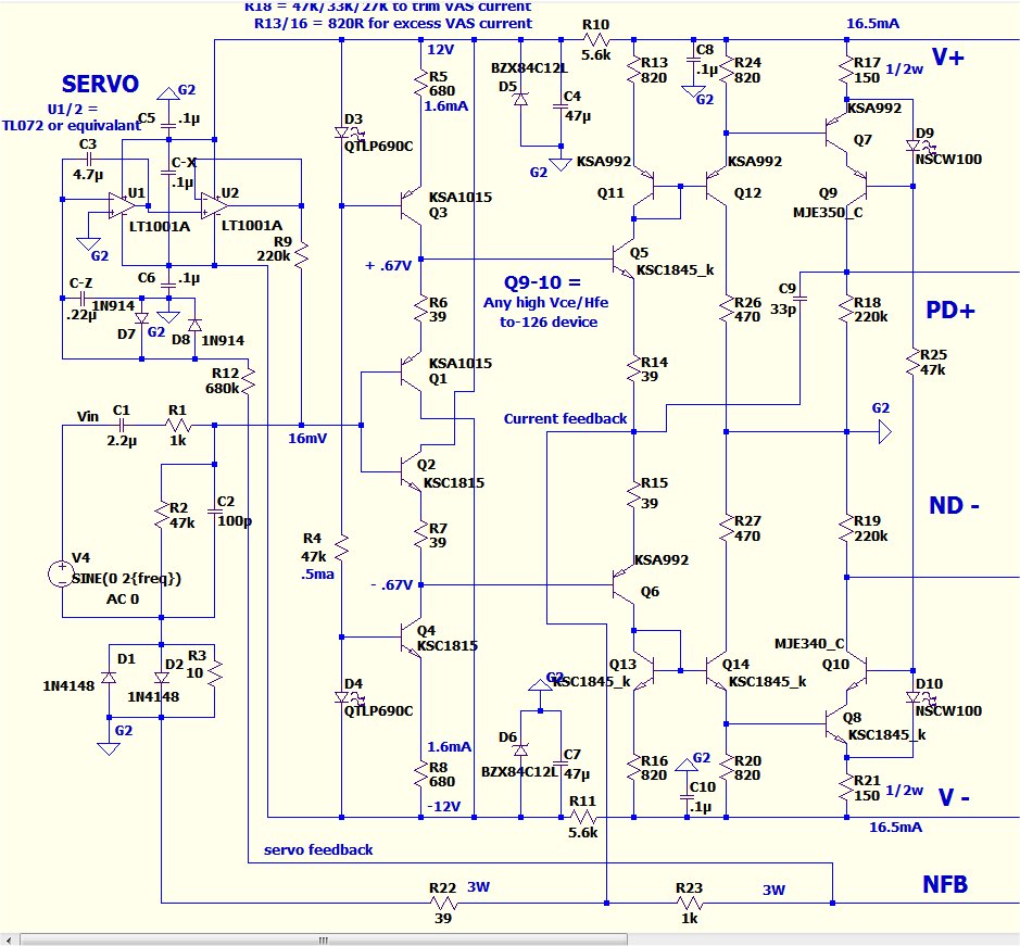

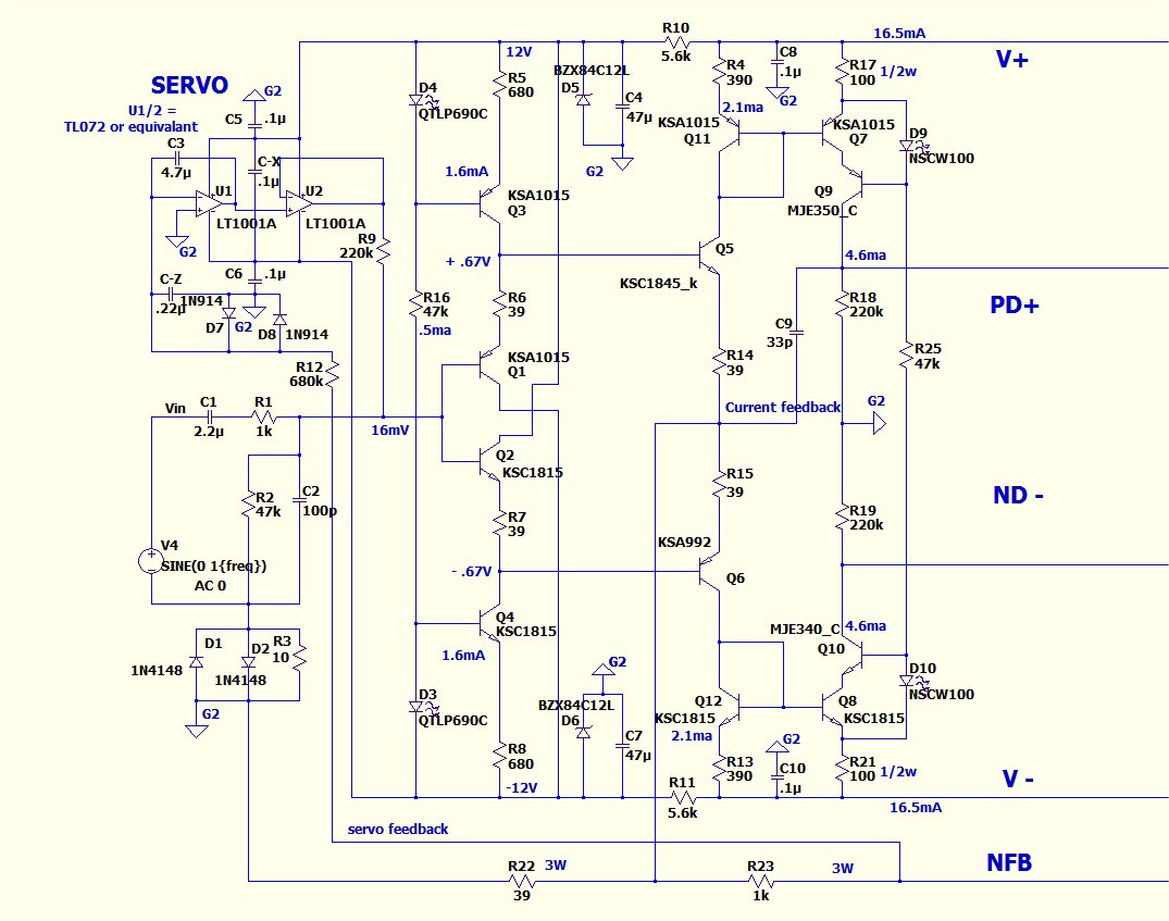

YES , I am now looking to improve on my last design.
I added your CM's (as in your PDF) ,to my known working 2 stage
CFA. (the NAD/nx - below).
Adding Q11-14 brought very little to the table ... +1db psrr ...
all else is the same.
Is there something radically different out there ?... maybe I
should hit the op-amp datasheets (the "hunt") 😀 .

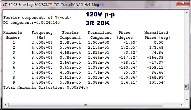

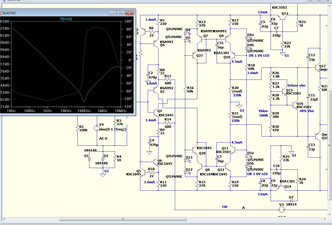

This DID bring something to the "table". In fact , exactly what I wanted.
Lower LF and HF THD at 120V p-p/ 3R loads. That's what i'm optimizing
my IPS's for these days .... as that is what is wanted. 😀 (below 1)
I can't really find any fault with (below 2) ... who would hear 28ppm
at this "ungodly" power level ? All "hail the "NX" ... very robust
design/topology - scales real nice! (82V rails) 😱

Hi OS,
I've lost track.... did you use the triple-mirror? Results were???
The ppm for THD --- just as a point to reach for -- because its a challenge -- is .001% or less. 0.01% is too easy.
Not because its audible... it isnt as a number by itself. Its just a marker.
THx-RNMarsh

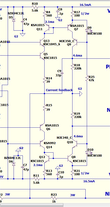

Oh , you like it simple. I didn't "kill anything" ??
I like it a' drippin' with parts ... 😀
Build the VSSA 😀 ...
check out below , 14 devices.
Let me explain ....
Q5/6 and 1/2's Vbe cancel each other. This happens pretty well
on the "simple version", but with the Q13/14 "new cascode"
All these devices can be the same (ksa1015/c1815).
Use ksa992/c1845 for both the "new cascode" and the CCS's
these will also cancel. Hawksford has almost 0 co-efficient.
All is set for polar to tropics 🙂 .
PS - just 4 .37c$ mouser devices... why the drama ?
I know this will work ... because it already does (in the real world)...

That one , based on the VSSA .... has really lame LF performance. ASK NAF
he says ... " built VSSA , bass is lacking ... NAD-S has the best bass by far".
VSSA 20hz thd is 100's of PPM. And the offset floats all around at LF , as well.

With my 5-pair sim ... I get about half 28ppm (12-14) ... the OPS
is a "player" with these power levels.
As a reference , I have the genesis class A OPS. I have swapped
these iPS's to IT , and they are down to 2ppm /.0002%.
I have noticed that these CFA's are SO FAST that they actually can
try to correct the X-over distortion of my EF3. Distortion stays
lower even if the OPS is not optimally biased.
