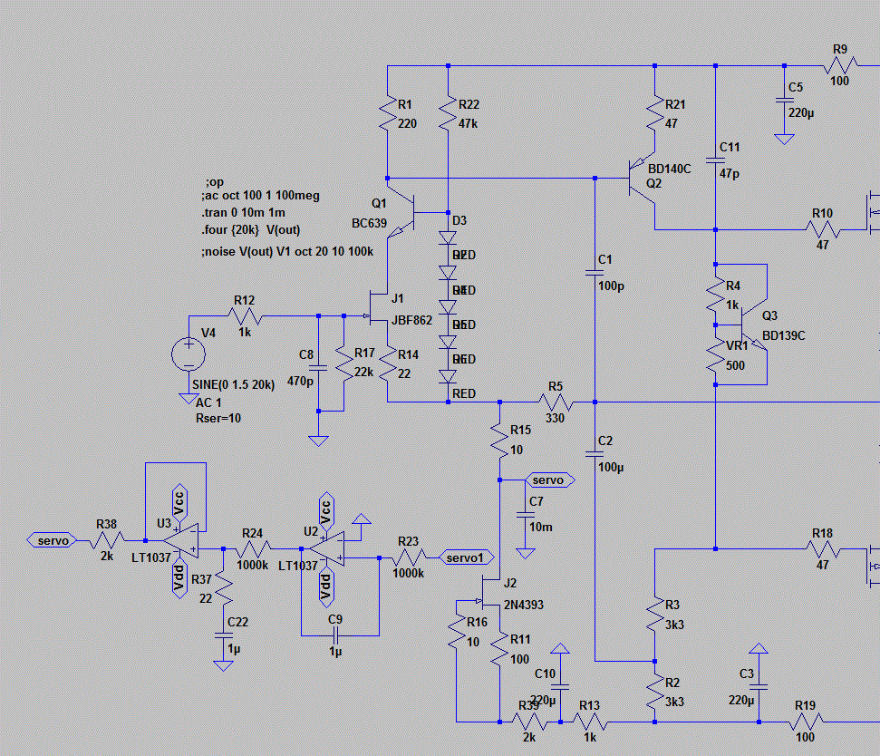

CFA-simplicity
Does under 0.05% at 20KHz/50V.
Very nice jfet cascode front end. Now were getting somewhere. GRH

This DID bring something to the "table". In fact , exactly what I wanted.
Lower LF and HF THD at 120V p-p/ 3R loads. That's what i'm optimizing
my IPS's for these days .... as that is what is wanted. 😀 (below 1)
I can't really find any fault with (below 2) ... who would hear 28ppm
at this "ungodly" power level ? All "hail the "NX" ... very robust
design/topology - scales real nice! (82V rails) 😱
