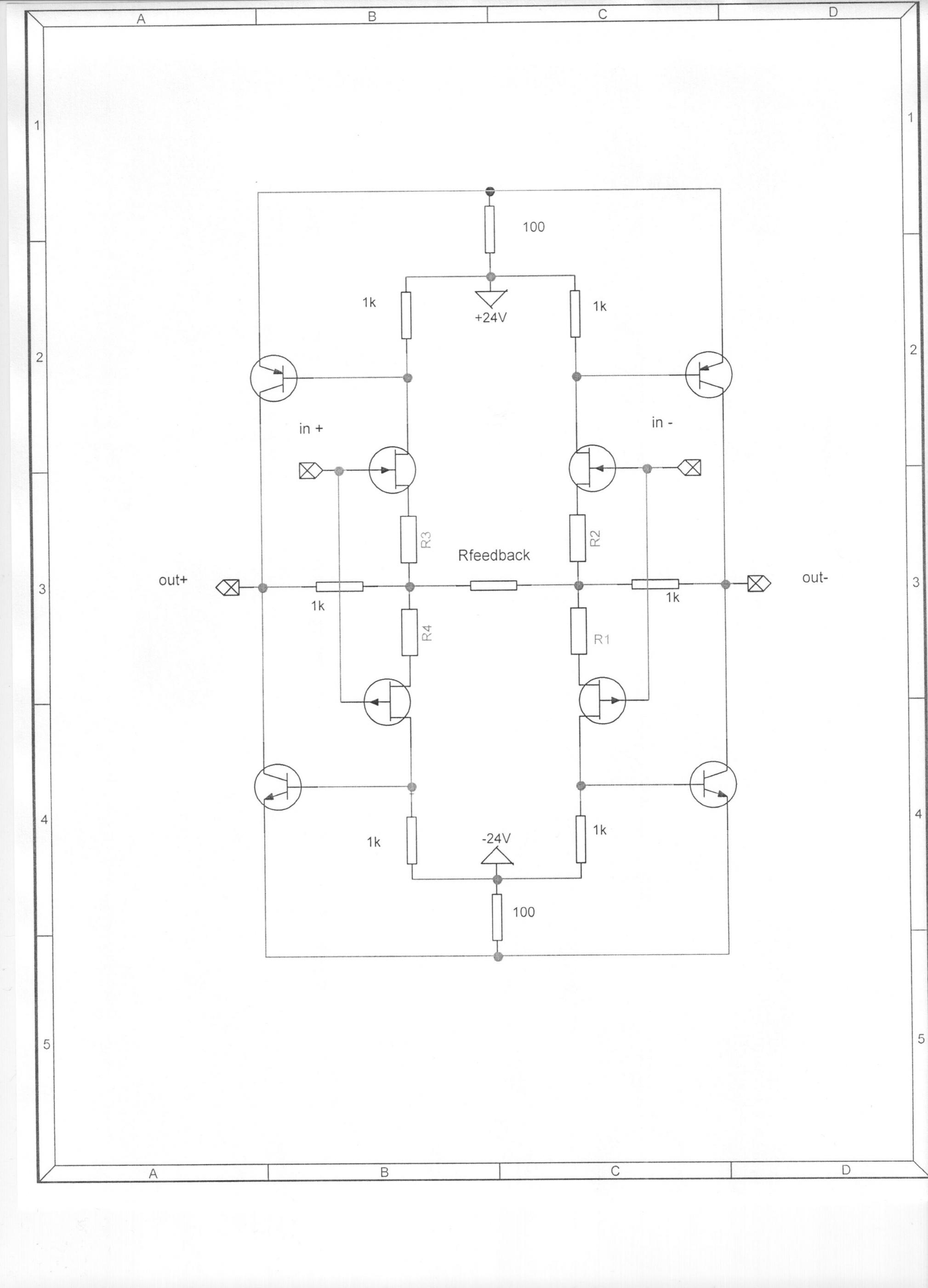

No, it is not. The inverting input node impedance is Rfeedback/2. If the jfet would be replaced by a bipolar (with appropriate changes to the biasing), then the impedance would be approximately Rfeedback/2 || R1/4 which is lower, but not necessary hugely lower.
But the CFA aspect is given by the fact that the open loop gain depends on the feedback network, here OLG~[250ohm/(R1/4+Rfeedback || 500ohm)]/[(Rfeedback+500ohm)/50ohm]. Something that never happens in a VFA.
You really need to learn how to break a feedback network and calculate the feedback network loadings. The equivalent schematic is attached.

Not sure what you are talking here about. JC's topology is not even remotely to what I have built.
I was only trying to show that while this topology has all the attributes and properties of a CFA, Mr. Curl itself calls it a VFA. That is in fact correct, because for the range of closed loop gains used in audio, the CFA specifics are long gone.

It has not. -IN input impedance, without global NFB applied, is high. In CFA, -IN input impedance is low even without feedback.
No it is not. You can't consider in JCs topology Rfeedback only as part of the feedback network, it's part of the open loop gain as well. Hence, being always there, it also determines the inverting input impedance.
Anyway, you are not going to tell me that if the jfet would be replaced by a bipolar, that would change from VFA (high inverting input impedance) to CFA (low inverting input impedance), isn't it?
What do you call JCs topology, then? Halo JC-1 or anything else? Halo JC-1 is a VFA undoubtedly.
The attached schematic, that I already linked to, and that was posted by Mr. Curl in his thread.
