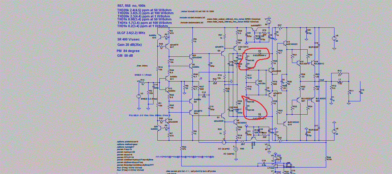

Three days later, I guess everybody now understands why I am not posting the schematics :rofl:.
Go on. Post it. There are loads amps on this forum with zillion devices. Though some have better THD than yours, anything new is worth looking at. eg how you achieve the zillion V/us slew
Perhaps you could quote the brand and the model of one of those 30 years old amplifier able to do 800W/4ohm, with the same level of distortions, using only 14 active devices in the front end?
I would be curious about the specification and the schematic, in particular because 30 years ago, modern RET power bipolar devices with Ft=30MHz did not exist.
Much more interesting (cos not Unobtainium) would be your schematic.

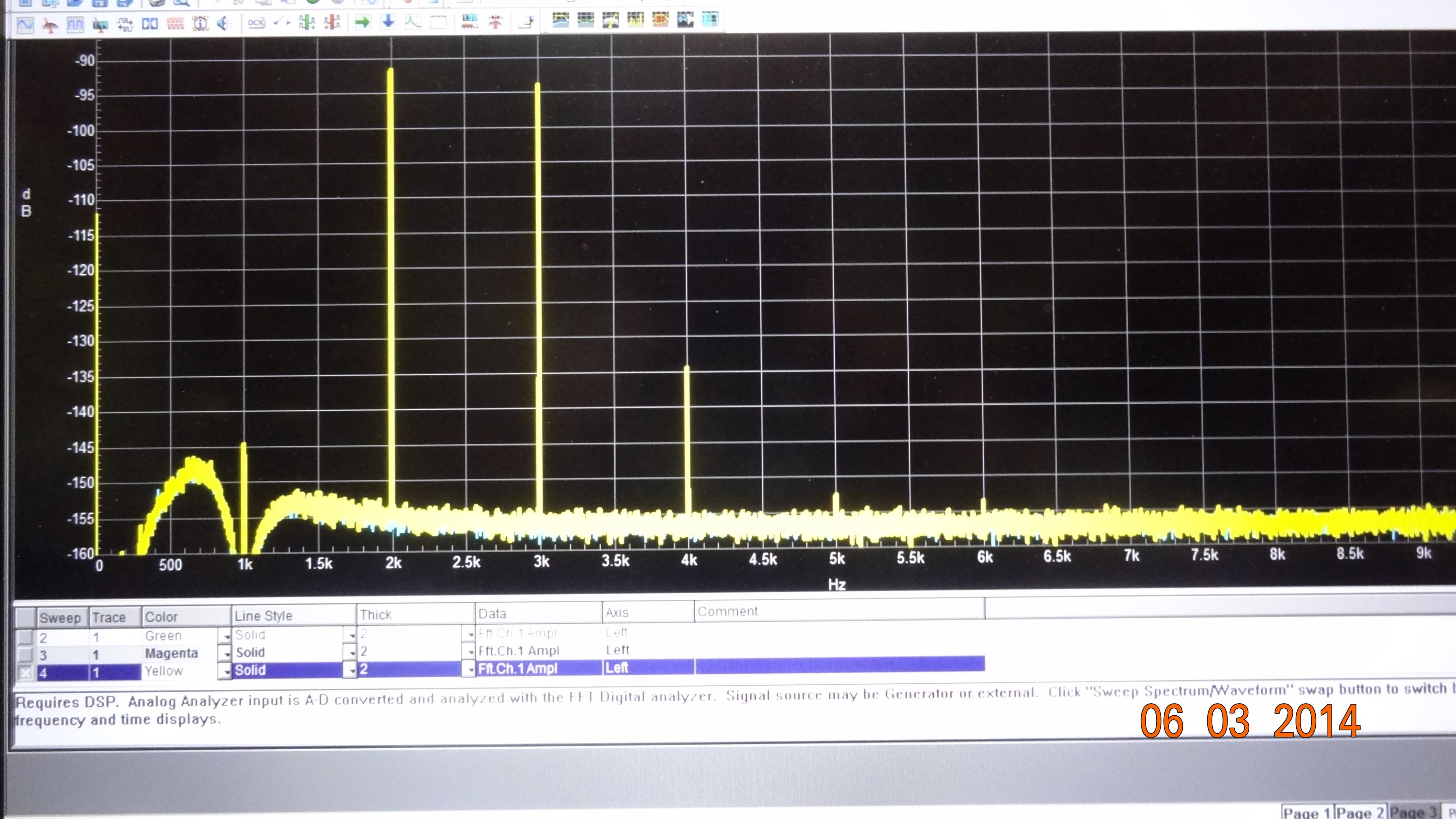

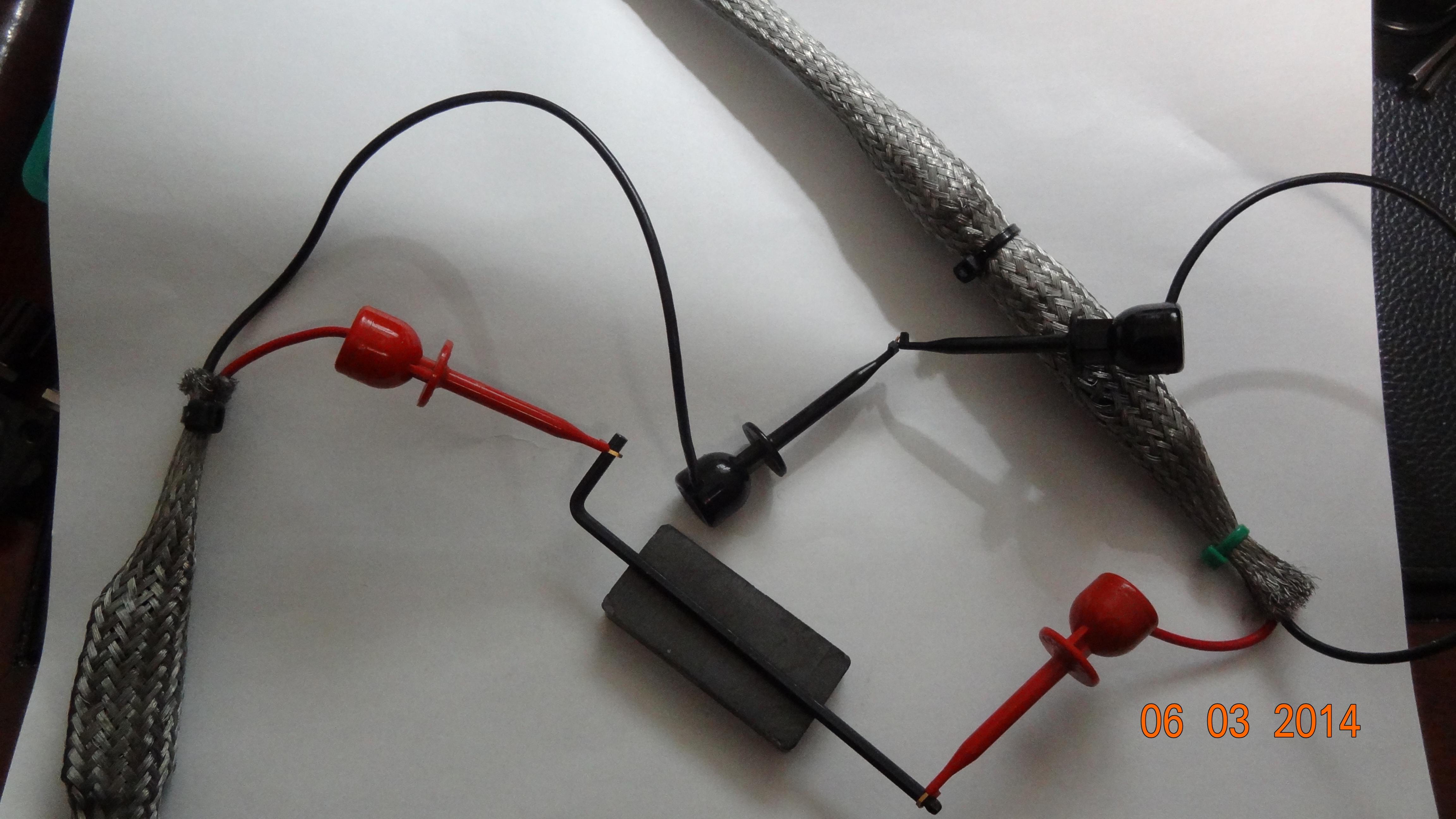

Excuse me one more time --- I was just thinking tonight that I would have to build a medium power, super duper low thd amp to drive my experiments with metals vs current. Thats linear thinking. I need to get the current up or the flux density up to see the affect on THD - it should increase. Need to check this.
I thought of another method: take that ferrous metal wire and attach a magnet to it to increase the metals flux density in the metal wire instead of passing more current thru it. Without a flux measurement with a Hall Effect probe I wont be able to know the equivalent current but it will show that the THD increases with current density in the steel wire section. There are other conclusions and apps to draw from this.... another time.
Thus:
Thx-RNMarsh

Very nice CFA amp. I am wondering how it sounds and what you plan to design next.
Do you have a higher power version in the SIM works or maybe a bridged CFA, perhaps?
THx-RNMarsh
My plan is to make this amp with three output pairs(for most 150W/8, 300W/4 is more then enough) and power cap multipliers with all needed protection on the same board, and there is going to have possibility to choose between high and low GNFB.
I tried different VAS topology, very high gain(a la Edmond), Hawkford cascade(not so good for CFA in my opinion) and this simple beta enhanced VAS shows quite low distortion and it's easy to compensate.
It is easy to make higher power version just adding output pairs, increase the power voltage and probably increase the driver current.
I did not try a bridged version, yet.
BR Damir

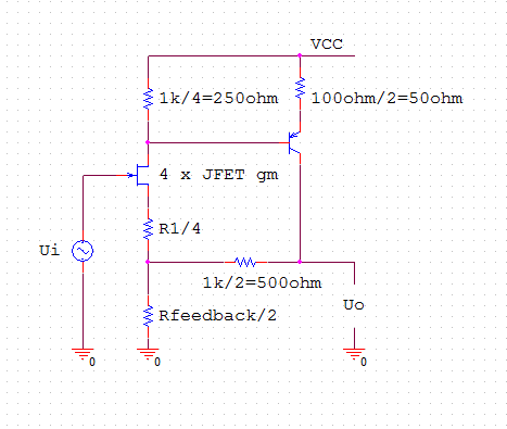

Which high impedance node, at the output? If so, why is this specific to a CFA or VFA?
Due to symmetry (you can fold the schematic both along the horizontal and vertical center lines, opposite nodes are at the same potential), the amplifier uses in fact one jfet at the input.
So why is this not a CFA?
The impedance mode at the input.
For CFA this has to be a low impedance, see defenition of CFAs, in the case of J Curl it is high impedance.
No, it is not. The inverting input node impedance is Rfeedback/2. If the jfet would be replaced by a bipolar (with appropriate changes to the biasing), then the impedance would be approximately Rfeedback/2 || R1/4 which is lower, but not necessary hugely lower.
But the CFA aspect is given by the fact that the open loop gain depends on the feedback network, here OLG~[250ohm/(R1/4+Rfeedback || 500ohm)]/[(Rfeedback+500ohm)/50ohm]. Something that never happens in a VFA.
You really need to learn how to break a feedback network and calculate the feedback network loadings. The equivalent schematic is attached.
