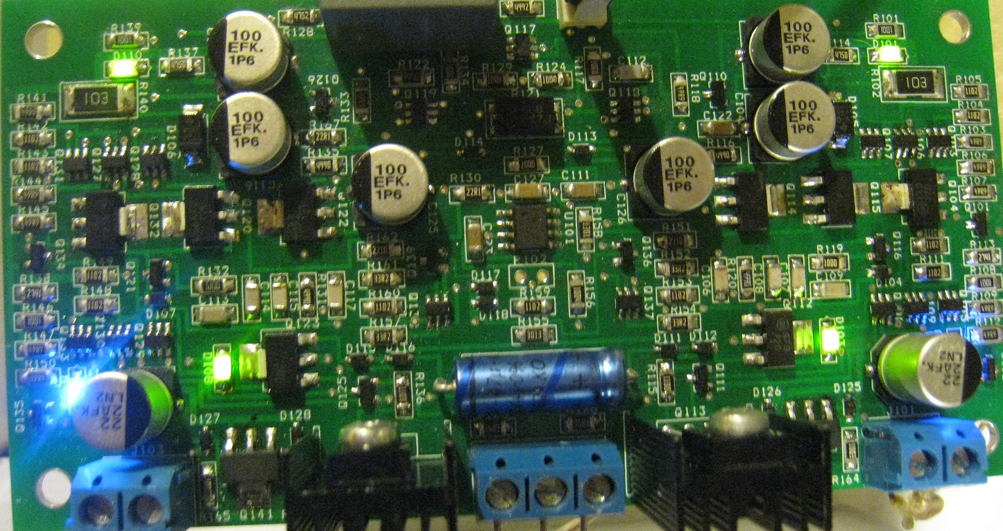

have you ever designed a working power amplifier, like >2 x 300W/4 ohm ?

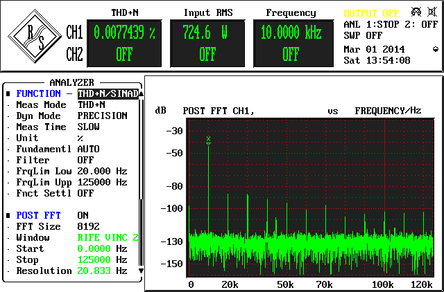

This is just before clipping (786W), in 4ohm load. Magnetic effects are predominant, with 20 amps flying around the bench (that's why the even harmonics are still dominant). Can probably get to around 0.002%-0.003% THD20 (down from the current measured 0.007%) if correctly implemented, simulates 0.001% THD20.
8 pairs of MJL onsemi bipolars, +/-90V SMPS lab supplies. There are some out of band spectral components coming from the SMPS's. Slew rate is 160V/uS.
Good enough? IMO, this is about all that can and is worth building in linear class AB. Beyond this, class D rules.

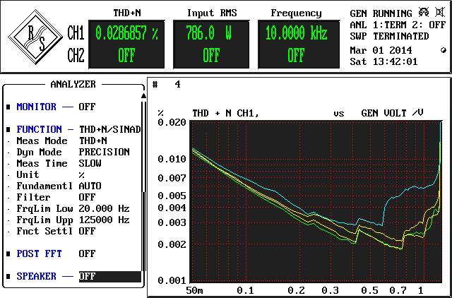

P.S. Distortion sweeps in dist.png at (bottom to top) 1KHz, 2KHz, 5KHz, 10KHz. Minimum distortions of about 0.003% at about 200W/4ohm. Halve all distortion numbers for performance into 8 ohm @~400W.

What's the measuring instrument?

No, sharing the schematics would be a futile exercise. It's way to complicated for this place that considers the number of transistors in the gain stages as the supreme design/performance/sound quality criteria, 6 devices being the supreme ear Nirvana. The gain stages have no less than 56 SMD transistors, out of which 34 are dual devices (pnp/pnp, npn/npn, pnp/npn).
The instrument is a Rohde&Schwartz UPD in our lab. It's the AP27xx head-to- head competitor, a little less performant (higher noise floor), but much more friendly (computer and LCD display are included), and has all the options that AP adds only for big money.
Here's a photo of the gain stages board. The opamp in the center is the servo.

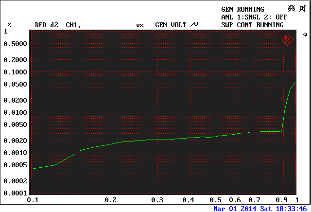

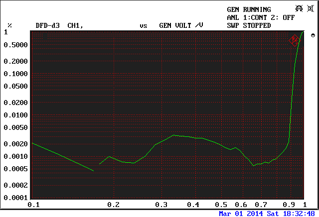

Forgot to mention that the two spectra above have the fundamental notched by 40dB. It's the standard way the UPD instrument displays the post THD+N measurement FFT.
DFD-d3 and DFD-d2 (IEC268) distortions.

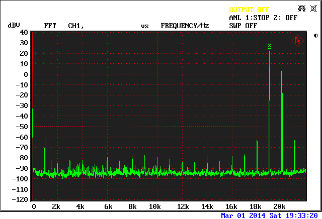

And finally, the IMD 19+20KHz spectrum, before clipping (some 0.85V input), in the same 4ohm load as all along.
P.S. 4 ohm is all along resistive, haven't had so far managed to build a speaker simulation load. I think this amp would have no issues driving a 4 ohm reactive load (assuming the power supply will not sag to bad), even with the phase shifts and the here-and-there impedance dips.

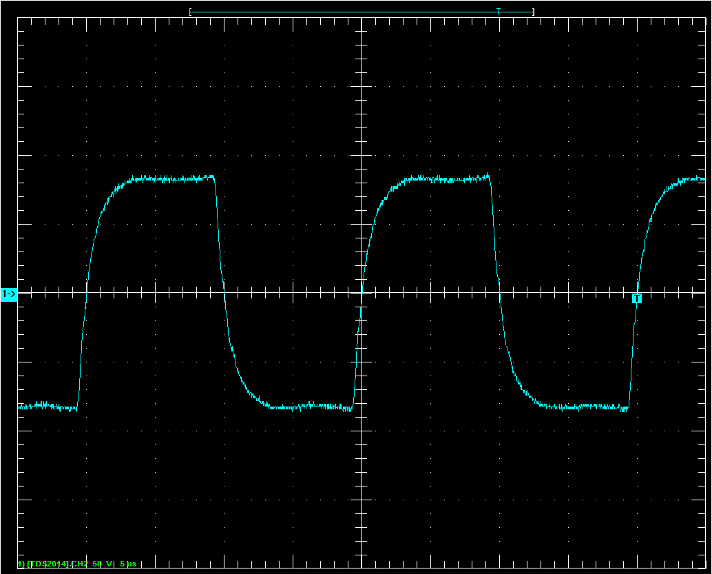

Ummm... forgot to post the step response @50KHz. Y=50V/div, X=5uS/div, quick snapshot, just before the zobel is about to explode...
