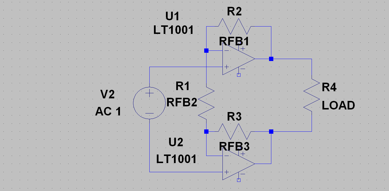

Can you show a drawing/schematic of your balanced fb?
-RNM
This is my idea, fully balanced, and bridged. The only backward is that is accept balanced input only.
Sajti
OK. yes, that is a popular useful configuration.
THx-RNMarsh
Of course. I think, that it's very good, and gives nice CMRR in practice.

I am familiar with Sumo circuit. I am asking about this because it will get many others to explore it further and find some gems in there to apply. Esp the SIM'ed pro-con of bridged needs more light of day on it. There are so many talented and motivated people here that we can all learn something new, perhaps, from one another working together.
