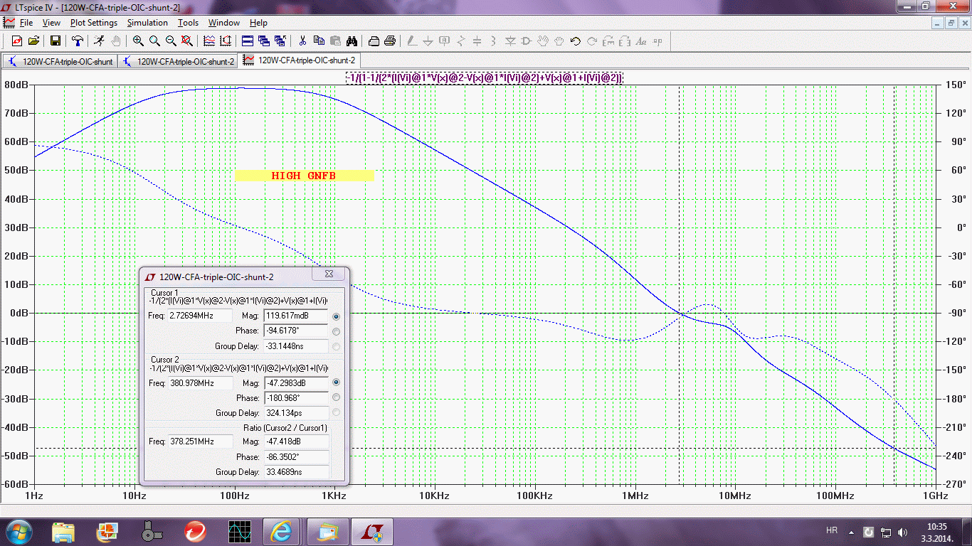

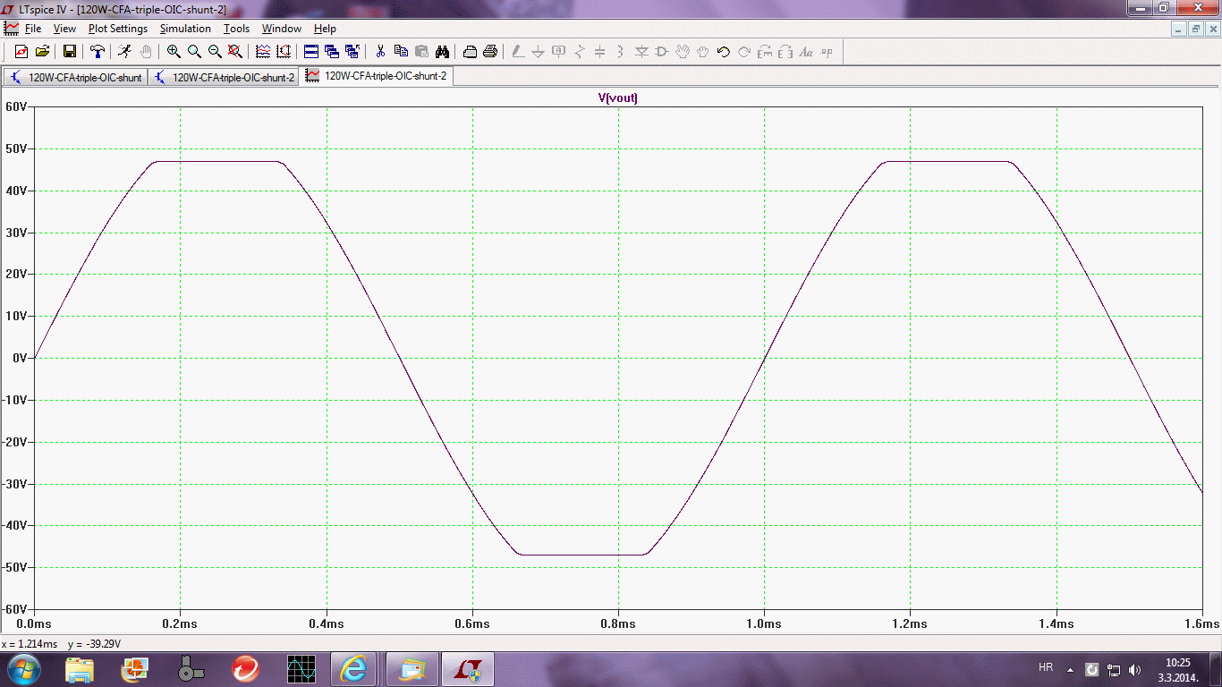

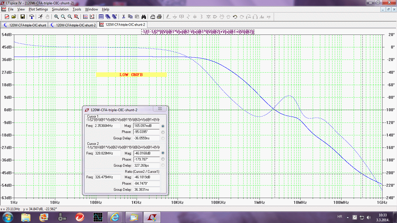

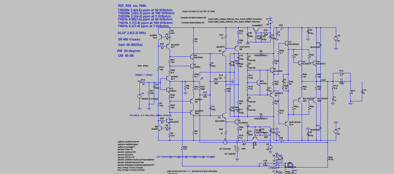

120W CFA-tripleOPS
This is my CFA amp with BJT EF3 (triple) output with the power of 130 W/8ohm. It uses combination of shunt compensation and OIC. According to the simulation it should be very stable with quite low distortion. Overload clipping is very good, result of Backer clamp. It is easy to boost the power by increasing number of output transistors and power supply voltage. There is a jumper to choose between high and low global NFB. Distortion is quite consistent over whole output power and frequency range. My intention is to build this simple amp and if it works as expected, to add a cap multiplier for output stage too, with all needed protection on the same board, progressive delayed current fuse, excess DC offset at the loudspeaker and complete power down if one polarity is down.
BR Damir
BR Damir
