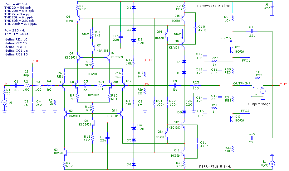

Please take a look at the front-end shown below. Two LTPs and two TISes with a low current gain of just 1x. Nevertheless, it slews pretty high, 500V/us and distorts 61ppb at 20kHz. Exceptio probat regulum. 😀
A constant product rule, on the other hand, might have the advantage that none of the VASes will completely turned off during overload conditions.
Why, for heaven's sake, keeping the product (Ivas1 * Ivas2) constant, instead of the sum (Ivas1 + Ivas2)? As for the latter, it already has been done with only four extra BJTs. Have a look at the MCP amp. BTW, this amp comprises two CFB stages. 😉It's not overly challenging to design something like that, but the CMFB does add some complexity. When I was last home a couple of days ago, I was playing with a proof-of-concept circuit in simulation and there didn't seem to be any problems. When I get back, I'll post a schematic.
In a nutshell, it used a feedback circuit that sets (Ivas1 * Ivas2) = (Iinp1 + Iinp2) * N where:

Fair enough. 🙂Please take a look at the front-end shown below.... Exceptio probat regulum. 😀
Yes, that was the idea. It allows VAS output current greater than double the quiescent current, without a sudden transition where one device switches off and the other is obliged to double it's incremental gain. The downside is that it introduces a small amount of 2'nd harmonic distortion if the open loop gains of the two sides aren't matched. So it's basically a trade-off, trying to choose the lesser of two evils.Why, for heaven's sake, keeping the product (Ivas1 * Ivas2) constant, instead of the sum (Ivas1 + Ivas2)?
[snip]
A constant product rule, on the other hand, might have the advantage that none of the VASes will completely turned off during overload conditions.![]()
Having a look now. Thanks.Have a look at the MCP amp. BTW, this amp comprises two CFB stages. 😉

I believe that Paul (mcd99uk) has built the MCP amp, or at least something having a lot in common. As for the Super TIS, this one has not been built yet. No SMDs are required.

Thanks for explanation (and I agree with your reasoning). Next point: how many additional BJTs are required for a constant product CMCL?
