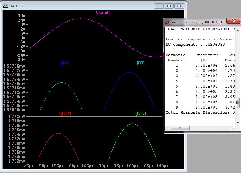

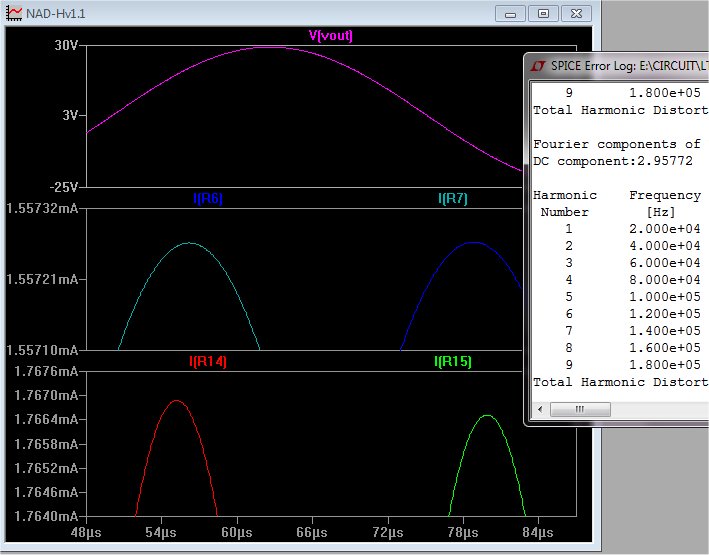

Balance and offset
(below 1) - I "balanced" this CFA to the max. Has a horrible 2V+ output
offset but the pair(s) of both input stages are more balanced than
any real amp could hope for.
(below 2) - I WAS WRONG 😱 , adding the servo DOES "unbalance"
the devices ..... just a little ! But I now have 2mv offset 😎 .

My simulation of a similar diamond input to that of yours in post #3673 indicated a possibility of the 2nd transistors of the diamond IPS (Q5 and Q6) being exposed to heavy power dissipation under over driven conditions. As small as 3dB over driving can cause over 0.8W peak dissipation on these transistors. At higher driving levels the power dissipation goes up as well. I was not simulating on exactly your amp circuit but perhaps you may want to have a look. I had +/-64.5V on the front end rails when doing the simulation.

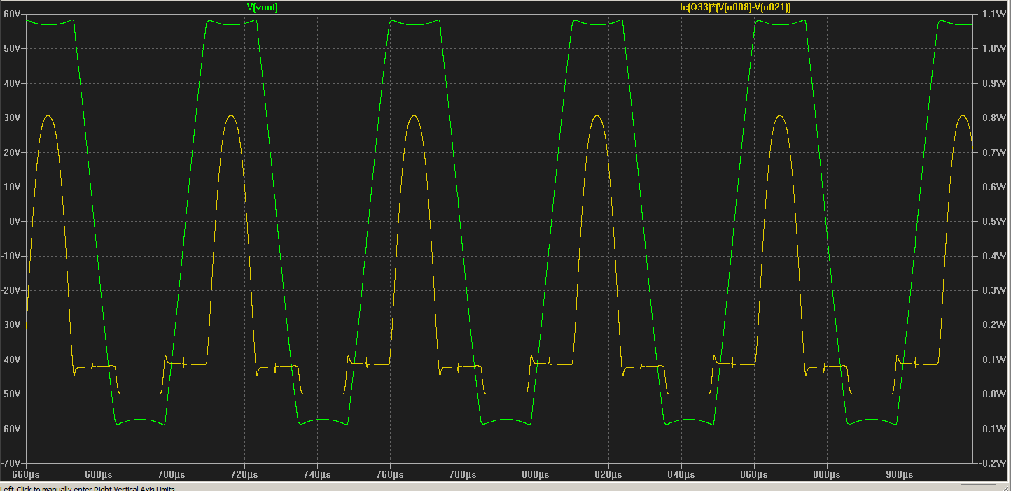

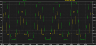

That would be the same as any of these DIYA CFA's , they don't have clamps.
ksa992/sc1845 have 500mW continuous dissipation . 800 might be tolerable
for repetitive. 1W resistors and perhaps a more robust to-92 device could be
in order. I'll look into it - I expected this.
PS - I could go all the way with the active clamps , I never tried them on a
Hawksford. 😉
