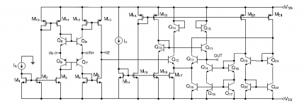

www.hifisonix.com
Joined 2003
Good points Bob - I dont think there is enough consideration of the issues around imbalance issues - be they due to device mismatches or deliberate 're-balancing'. Seems some spice analysis to establish the size of the problem would be a good thing. One for a rainy day . . . I'm too busy for the next few months.
use what ever def you like for 'serious' performance..... but at least as good as what has been put up here so far. Surprise me. I like surprises.
I am sure you understand how this little CFA can be compensated.

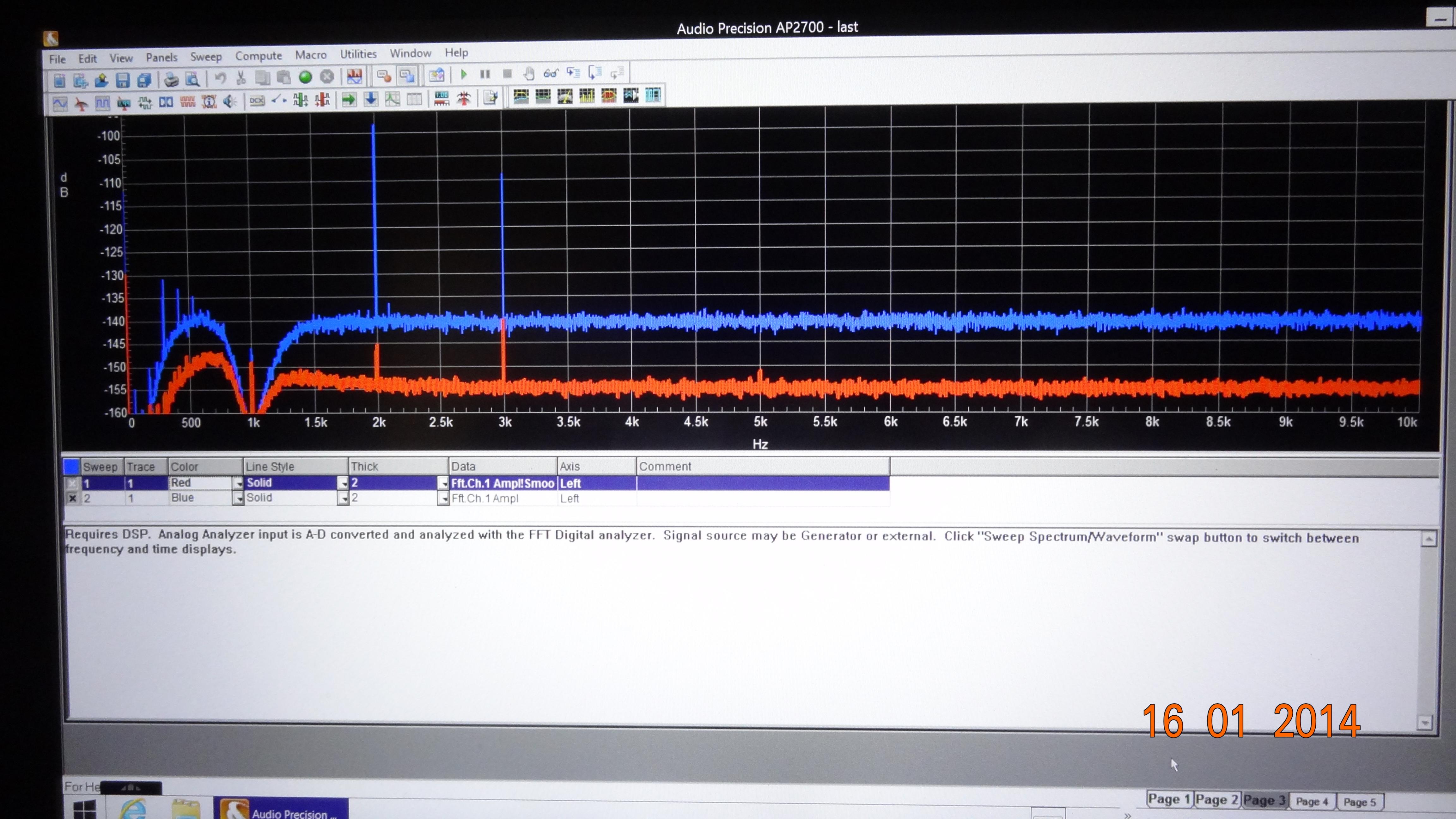

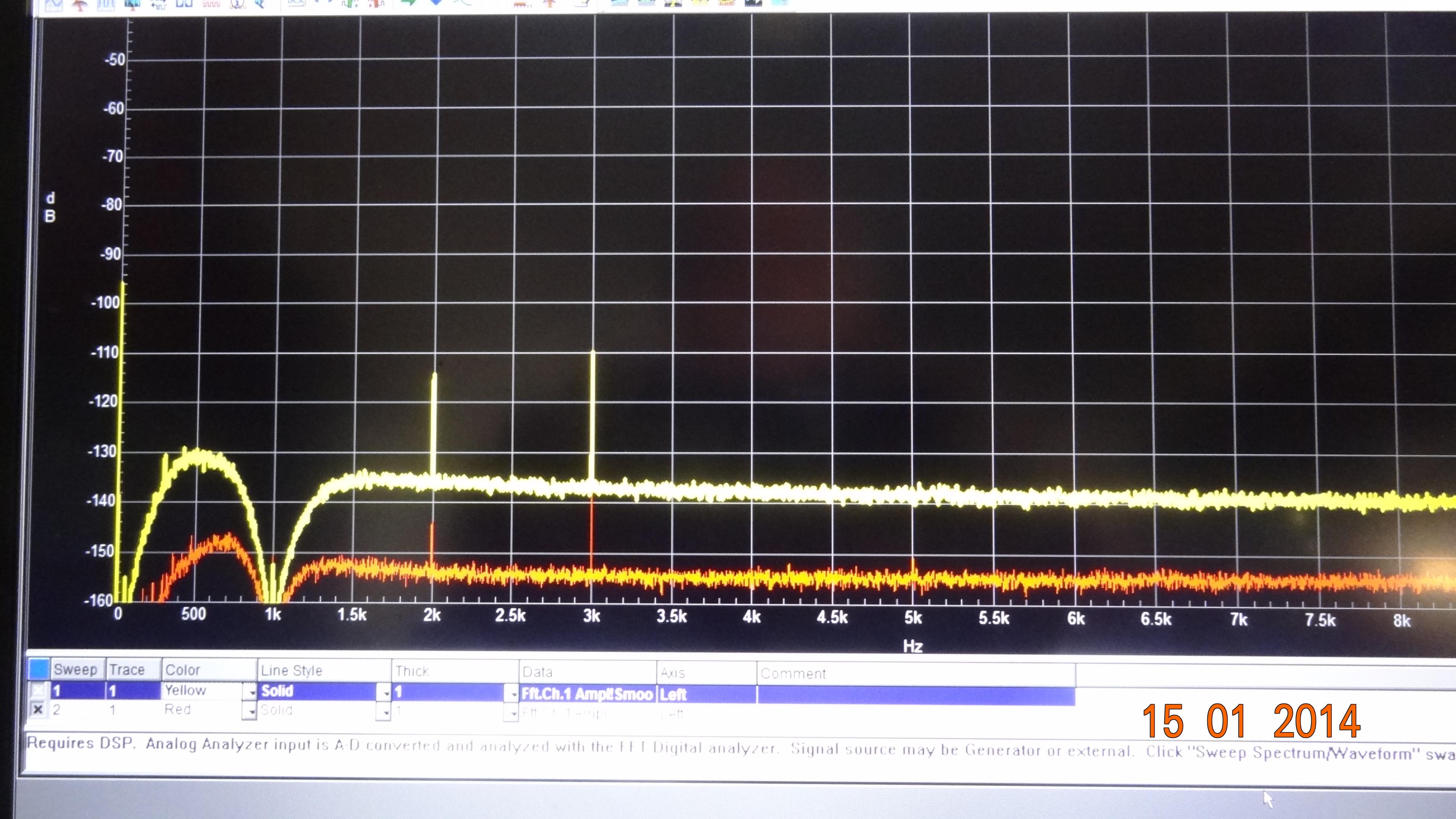

Well, I am willing to try that as well. I found microwave devices to be very linear. Especially those designed for class A single-ended operation. But can osc easily if not very careful....strip-line package with smd can be a challenge. But I am up for a new challenge. BTW - I use mostly MOSFET OPS.
A couple years ago I decided I needed to be able to measure what I could design. I set my goal to be able to read harmonics to -160dB. I was told it was impossible, basically. After spending over $70K on this quest, I learn they were correct. BUT, I did get to -150dB (re 1v). This is real measurment and not SIM. And, in the process I learned a lot about distortion analyzers and oscillators from some very helpful guys. Now I can accuratly read harmonics well below my personal design threshold for audio of -100dB. Note the word - accurately. But, I had to try all sorts of things before ending up with ShibaSoku AD725D and Audio Precision 2722A and many others by HP and Panasonic Industrial and a few sound card like products. I can say with great certainty that below -100dB harmonic levels there are a lot of nuances and you find them in the design, topology, layout, parts, grounding, power supplies etc etc. And, it is from my own experience that the CFa and the more simplified compl-push-pull topologies are easiest to get very, very low THD at all freqs and especially HF in actual build. I have been hoping to learn why that is. Still not sure... except that Bonsai comes the closest in describing the reason IMO.
Thx-RNMarsh
