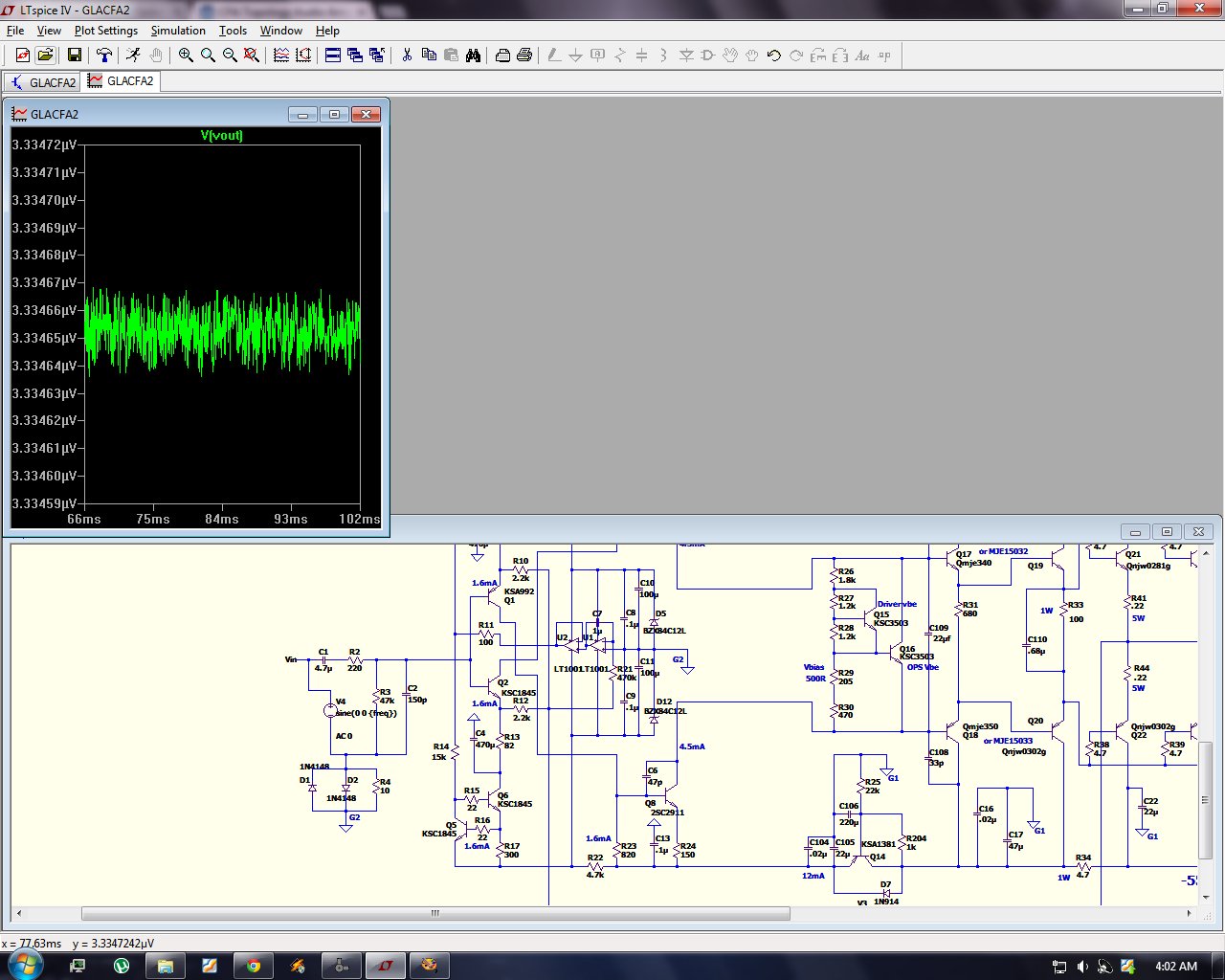

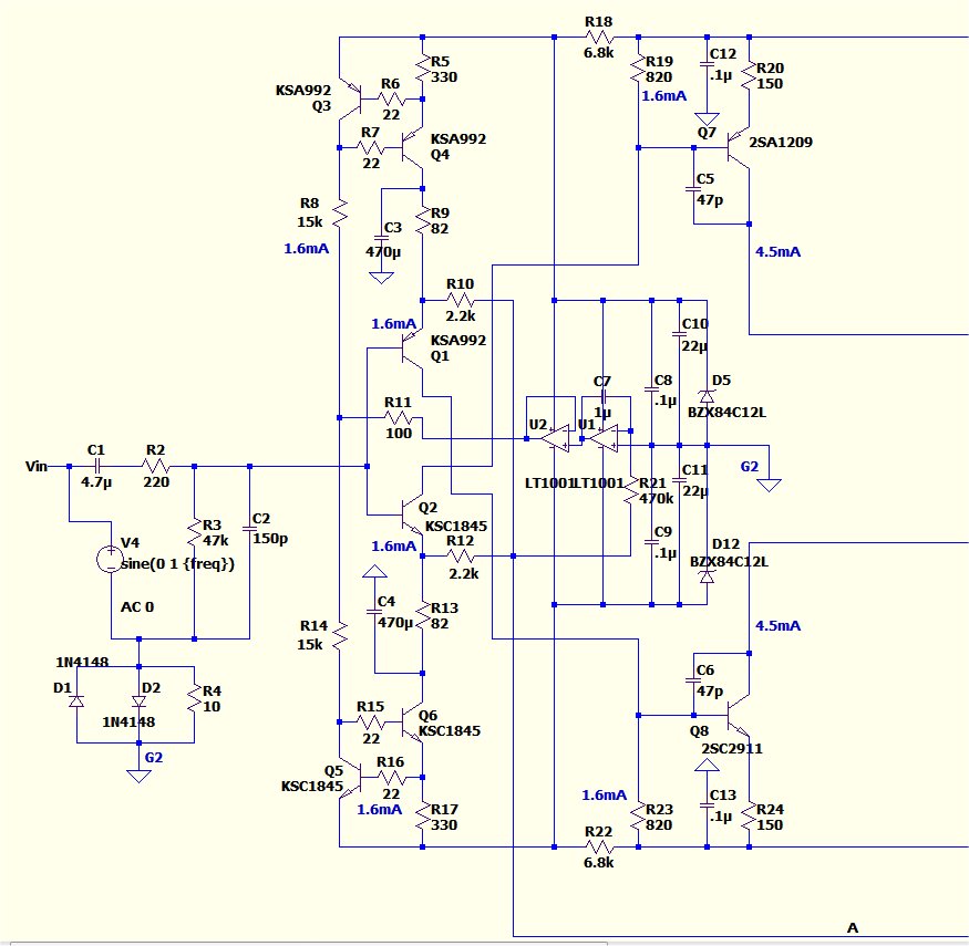

Just made another CFA "breakthrough".....
Miib's idea of using servo FB to bias the CCS's has another "side effect" !
(below) I simplified the technique letting the servo error voltage bias
the "center point" of the 2 opposing CCS's.
Not only do I get 2-5nV ! offset ... even over 40C thermals , but I can
even swap the KSA input tranny with a MJE - still 5nV.
The unexpected thing was another 10db of LF PSRR reduction. This "bombed out"
simple little thing can even beat some of my VFA's (PSRR) now !
Not at all "bloated" , with only 8 semi's/1 cheap IC .... 20-35ppm 20-20k 🙂 .
A "happy" little circuit - seems devoid of "bad habits" .. 😀
I like this one better than my first one .. actually. 😎
PS- I have an "opposing" VFA (9 semi's) push pull VAS , CCS, single LTP ..
120+ V/us - same 53db OLG /20-30PPM (symasym like).
OS

Measure the 50Hz THD? I found the single opamp servo not slow enough to counter the wave form envelope distortion (the servo drifting on slow input signals). I'm divided on using them because of it.

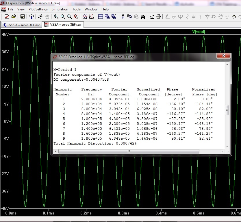

Thank you, OS. I sim your servo on my CFA. It work, but I already sent my drawing to PCB maker.
5Hz - 50hz/ 5k -50K nothing changes ... I HATE chips in my amps !
But , this is a good use ... 🙂
BTW- I Researched OEM servo integrator values for R/C before connecting the servo. My 32 YO sansui's servo uses 1u / 470k ....
PS- 10 -100hz blocking capacitor induced distortion was my reason to use
a stupid chip in the first place.
Edit (below 2) is static offset (no signal) ... 😱
OS
This is the result....
