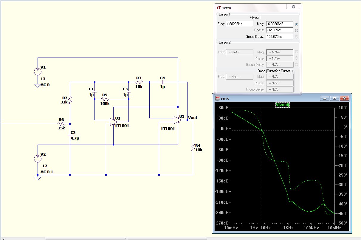

Miib's idea of using servo FB to bias the CCS's has another "side effect" !
(below) I simplified the technique letting the servo error voltage bias
the "center point" of the 2 opposing CCS's.
The unexpected thing was another 10db of LF PSRR reduction. This "bombed out"
simple little thing can even beat some of my VFA's (PSRR) now !
---- seems devoid of "bad habits" .. 😀
I like this one better than my first one .. actually. 😎
PS- I have an "opposing" VFA (9 semi's) push pull VAS , CCS, single LTP ..
120+ V/us - same 53db OLG /20-30PPM (symasym like).

I think this is the way ... miib told me I should also mirror the sources to
gain more high-Z .... too complicated (diminishing returns).
He also suggested a 3rd- order filter for the servo. Dang ! I found a filter
from heaven (below 1). In according with "KISS" (keep it stupid simple) ,
I am at 1 IC and 8 little passives.
What I have is a "cliff -like filter" ( 60db/decade) and good gain below 5Hz
to decimate any DC.
As far as the Japanese ... I looked at all my service manuals from 1982 to
present (300+) .... they all just use simple integrator' s with 6-12db/decade filtering.
I simulated them as well! 😀
NO match ...
They are economically motivated .
OS
Not the integrator, look at the CCS driving it, by floating the CCS you have the option of gluing them together with the input pair to gain thermal tracking. And a phono-stages with 85 dB gain at low frequencies are a lot more prone to thermal issues than a P-amp with low or NO DC gain.

That is why I stated "overkill" - we also don't need 4 pair parallel input stage
semi's either. 🙄
The real world scenario with the 2Q CCS , at least on my badger with LTP/2Q
... cold day to the hottest day , .2 - .3ma more on the hot side. all runs the
same 1.6ma (.1ma per tail increase badger 2Q).
This (might ) increase VAS Ic by .2ma - OPS bias then will increase ... but depending one the Vbe coefficient this will likely be negated (at least on the
blameless).
Do we need an Arctic to Sahara amp ??
os
Simple circuits are good with good housekeeping. Taking out the negative influence of the servo is major. Now if you run a lateral output without VBE, thermal issues in the input stage is enough to make it run away. With your output-triple and dual VBE you control it elsewhere. sorry to derail this not my intention of turning it into a housekeeping subject.
