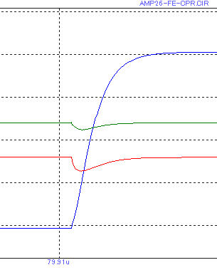

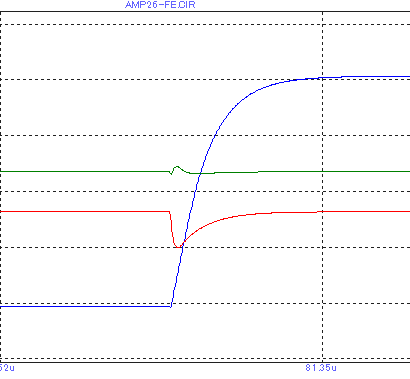

godfray (4117)
in such a scheme works poorly (badly). That range of distortions in power and + -40 V input voltage of 3 V (peak)
[/URL][/IMG]
http://radikal.ru/fp/2ad30e85f800484883459307a912424f]
[/URL]
best regards
Petr
best regards
Petr

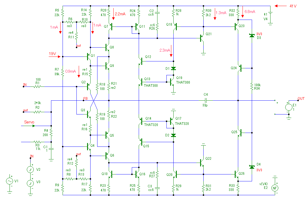

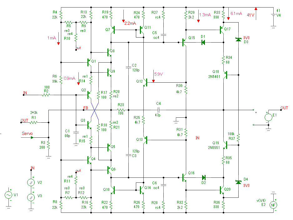

The circuit below illustrates the idea. in this version, VAS current gain = hFE*2/3 and VAS quiescent current = 4 * input stage quiescent current. One could obviously rationalise the mirrors to save a few transistors. I just drew it like this, with same-value components throughout to make the mirror ratios obvious at a glance.
Note that emitter resistors can't be used with the transistors in the yellow box as it relies on the exponential Ic/Vbe relationship to work properly.

Thank you for providing the details of your circuit. In the mean time, funny enough, I came to almost the same realization for a 'constant product TIS' and to the same 'irritating' number of extra transistors (see 1st figure, Q7, Q10...Q20). The 2nd figure shows the step response (blue) and the TIS collector currents (red and green curves). As expected, when Ic of the one TIS doubles, Ic of the other TIS stays far from zero. That's nice, but is it worth all the trouble? NO! Moreover, just as you did, I also observed an increase of the 2nd harmonic distortion. There are better and simpler ways.
The 3rd figure shows a CMCL (comprising 6 trannies instead of 12) that keeps the sum of the TIS collectors currents constant, thought with a twist. Please take a look at fig. 4. Here, the TIS that 'normally' should be switched off, keeps running at nearly the same collector current (see green curve). How is that possible? Very simple. C2, respectively C3 are responsible for that. During a positive going step, for example, Q18 is hard turned on and the output will rise. So far so good. However, this rise will also turn on (more or less) the opposite TIS via C3. That's the crux. More on this subject (and a funny quibble with Bob) can be found here.
Cheers, E.
Hi Paul,Yes, all my CFA amps share a lot with the MCP amp. IMHO the CMLC system is significant in it's improvement to sound. Wish more would try it...
Diamond buffer input stage + CMLC + beta enhanced VAS + 2 pole compensation + various output stages = Nice sounding amps.
You have mail.
Cheers, E.
