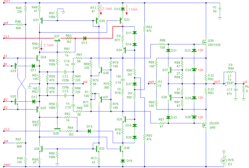

Edmond, do you have a link to the additional circuitry is necessary to ensure a decent behavior at overdrive conditions you mention in that link

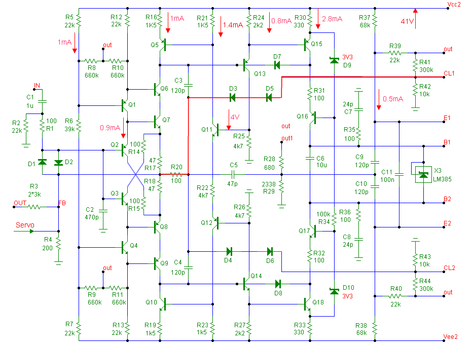

Hi Richard,
Below you see the complete schematic of the MCP amp. The signal path (one half) of the clamp circuitry is marked red. A similar clamp (of the PMP amp) is described here.
It wouldn't be nice if I reveal who designed that amp. I only can tell it's an 30 years old and well known design. It uses separate power supplies for the front-end and OPS. The front-end does have a (brute force) clamp, but if the power supply for the front-end is a little to high (or the power supply for the OPS a little too low), this clamp is ineffective and recovery from overload looks horrible.and also the subsequent one with bad overload recovery?
edit: Therefore I prefer a clamp that gets activated when one of the drivers of the OPS is on the verge of saturation. This way the clamp works always and doesn't depend on the voltages of the power supplies.
Cheers, E.

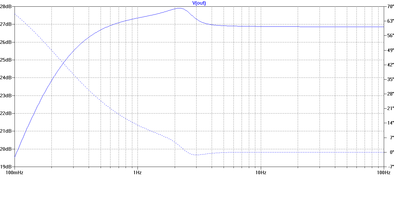

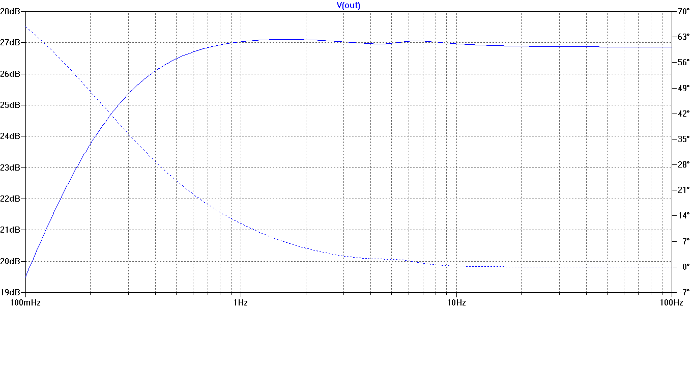

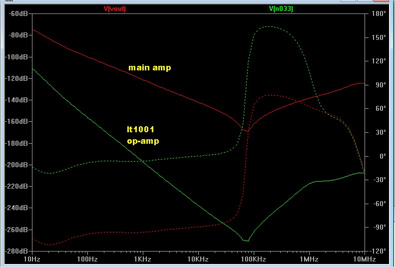

Thanks for this OS. The filter is used quite sparingly in Tom's circuit and the effects are not disastrous.
However, Tom neglects one of the simplest stability tests .. frequency response.
GooteeServoOriginal.png is the response of the circuit as shown on his webpage and downloaded. The effect can be seen but is less than 1dB
GooteeServo800mHzfilter.png has the 'DC Accurate 60dB/decade filter' lowered to 0.8Hz by making C10 & 12 2u2 from 1u. The 'feature' is now 1dB.
This all depends on exact details of the filter, integrator & the power amp. The whole shebang is a feedback LF filter and needs to be considered as such.
You can have fun finding combinations which are unstable 🙂 but you should at least check the frequency response of the combination you use.
The time response of the whole thing .. ie how the system responds to offsets & 'DC pulses' etc is entirely described by the frequency response.
eg the simple 'integrator only servo' has exactly the same behaviour as a single capacitor deciding the LF cos both have exactly the same frequency response

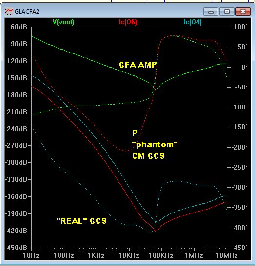

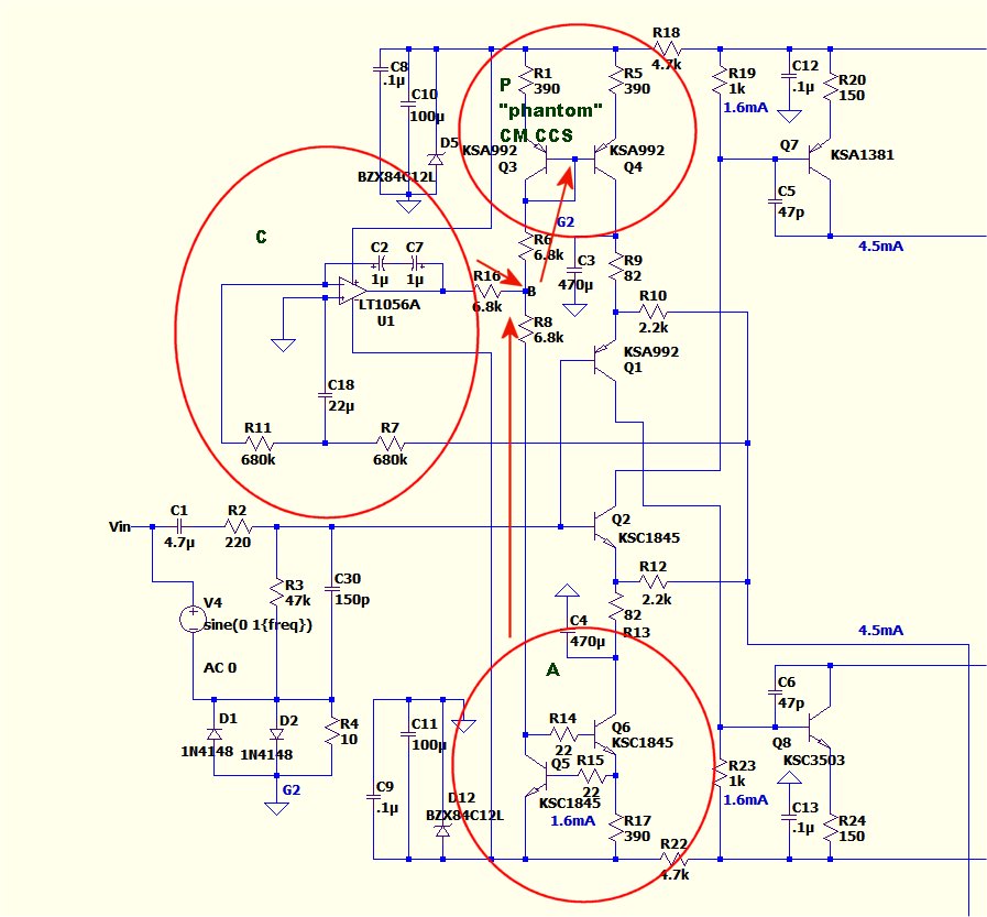

(below 1) is the "famous , controversial" feedback amp (VSSA / whatever) ...
"A" (circled) is the only "real" current source. "P" is the mirrored "phantom"
source ... in the middle is the CFA pair.
Looks like a "blameless" except for the CFA pair (instead of an LTP) in the middle.
The real current source is set to 1.6ma , it's 'tail" is set to about the same...
mirrored through Q3/4 for the positive "phantom CCS".
"B" is a summing junction for the servo+CCS current that the mirror "see's".
Add the servo's few nA to the main CCS's reference current and that is what
the phantom CM "CCS" will be.
__ Remove the servo ,
the amp performs the same ! -88 to -150 db PSRR across the audio spectrum.
There will be a little offset , you could replace the op-amp with a trimmer and
add a few 100mV's to zero out (at R16). The "effect" is the CCS topology , not
the op-amp.
The servo is a nice addition (if you want it) , you could also add the trimmer to its non-inverting
input for manual zeroing. PLUS ! it will also perfectly "track" any changes to
the CCS's current to always have no offset.

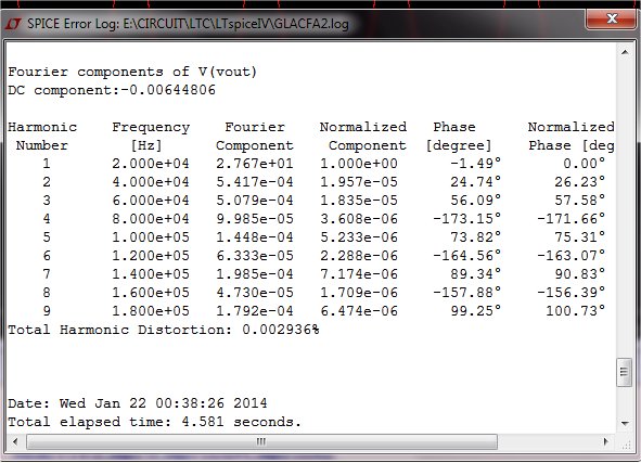

Another added side effect is even LOWER PSRR and lower THD 20. With
the servo , CCS current stays within .0001ma . (without .0005ma)
This thing is WAY ahead of the VSSA in just about all aspects.
The "NX" diamond could be tweaked like this , too.
Very nice "silver bullet" , Thanx .. RN !
EDIT - I think I found out why I have lower THD ... my LF open loop gain increased 17db ??
Could this be the doing of the CM ?? (like in a VFA)
OS

Thank you .
One thing that must be considered is that there IS still a "tradeoff".
The increased LF loop gain + better PSRR has a price ... lower 20K
available gain and a slightly slower amp. This can be compensated by
raising the UGP or by increasing Re on the CM.
Both the CSS and CM are hi-Z , but the CM is higher. One would think
this would unbalance the input pair in some manner (miib's IS balanced -2 CM's).
I checked this... and not more than a few PPM between the 2 designs.
PS - You did know VFA/CFA would merge , RN . Did you design/build
this already .... and dropped the hint just to see how fast we would
catch on (up) ? 😀 😎
