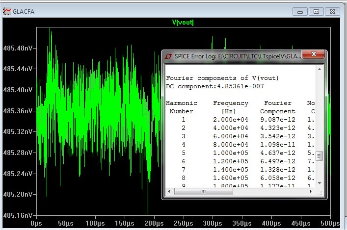

I'll show you (below) ... this is LT's model , keep in mind.
(calculate that DC component)
As far as noise , I'm "lifted" through a 220K resistor...the LT1001 is additionally decoupled with 2 diodes/10u caps (titan amp). Any noise
would be the op-amps's ... but then attenuated by the 220K.
The good thing , is that 20hz THD is .0032%- 2R !
PS - I already have the board "decapped" with the 12V+/- at the NFB node.
easy to integrate - no major rework of the IPS PCB. 😎

TL071 it is !
2mA low current. LT's 1001 reads 2.7mA .. I'm trying to keep
to my 14-16ma / per rail IPS "target". Jfet input .. I could most
likely raise my input resistance considerably .
(mouser has 2K in stock at $.62 each !)
Now to get a model - I'm sure it will be similar to the 1001.
PS - just measured my Sansui Z3900 servo EF3 (ne5532) ... .2mV - it been there for 33 years !
