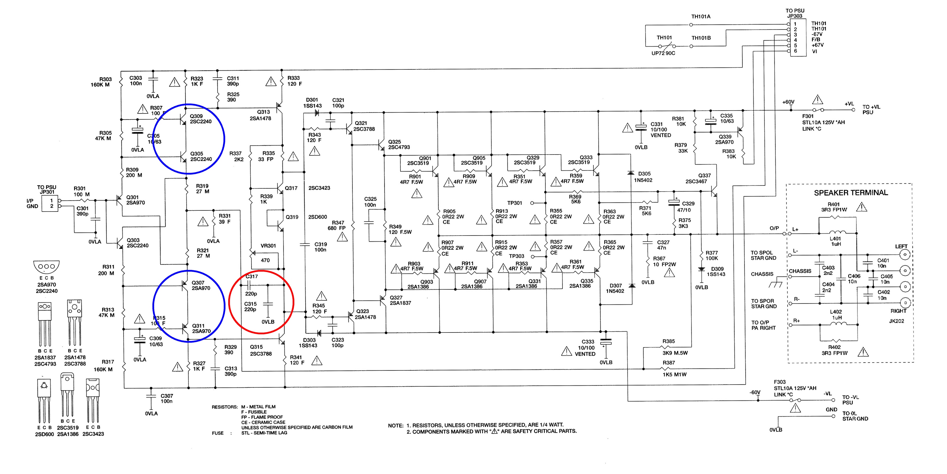

To all,
Take a look at the compensation (red encircled) of a NAD319. It uses both input inclusive Miller compensation (whenever possible, always use this one) and shunt compensation as well. I've once simmed this circuit and discovered it was pretty good optimized. Apparently, the engineers at NAD also used a simulator. 🙂
As it is a long time ago, I can't remember whether the shunt compensation was used to stabilize only the Miller loop, or was also used to stabilize the OPS. Remember, some output stages, especially the ones with local FB loops), like a low impedance at HF.
BTW, NAD uses identical trannies in the input cascode (blue encircled). Using Andy's models for the 2SC2240, Zo = 144 Meg, thus even slightly higher than a BC850-2SC3503 combo. 😀 (of course, simmed under the same test condition with Ic = 1mA)
edit: I forgot to mention that there's also a lead-lag compensation at the TIS input, C311 & R325, respectively C313 & R329, clearly meant to stabilize the Miller loop.
There is absolutely no technical reason that would make this statement true, and repeating it also doesn't help.
Shunt lag compensation is probably the worst compensation method. To quote Peter Baxandall "The technique is in all respects sub-optimal". D. Self discusses this at large, and if I recall correctly so does Mr. Cordell, in their books. If you have any arguments as of why shunt lag compensation is preferred for "CFA"s please present your technical arguments.
The only case in which a lead-lag shunt compensation can be really useful is to compensate the Miller loop.

Hello ,
Why do you consider that shunt is worst ?Why all the engineers are looking only at the gain in the loop ,that beeing a good criteria ?
The shunt compensations intoduces the smallest group delay and also the highest bandwidth .Make a simulation
I have no idea why shunt compensation would have the "highest bandwidth" and the "smallest group delay".
Shunt compensation is bad for at least two reasons:
- First, it loads the VAS, requiring a much higher current compared to the Miller compensation. Hence, the VAS will have much more distortions.
- Second, shunt compensation does not have the pole splitting property. Because of the missing pole splitting, usually shunt compensation is required to set the dominant pole to a lower frequency compared to Miller compensation, therefore lower HF loop gain, therefore more HF distortions. Obviously, for the same stability margins, shunt has actually a lower bandwidth compared to Miller, not to mention more advanced compensation methods. So much for "highest bandwidth".
The group delay is a measure of the slope of the phase response at any given frequency. I see absolutely no reason why shunt would have a smaller group delay compared to any other dominant pole compensation method. Always recall that audio amplifiers are minimum phase systems, therefore the loop gain and the phase are not independent.
If my eyes don't play tricks, the NAD input stage runs at about 320uA and the cascade at about 2.4mA (not 1mA).
Anyway, this amp confirms what I've already said: "CFA"s are nowhere simpler to compensate compared to a VFA. While in a VFA you can get along (although not necessary optimal) with a single cap Miller compensation, a single gain stage "CFA" usually also requires Miller loop compensation. Unless it has an unusual (and suboptimal) low open loop gain, when you can actually skip completely any explicit compensation.
Indeed, I said: simmed under the same test condition with Ic = 1mA, which, obviously!, refers to the test condition for the BC850-2SC3503 combo, to which a made the comparison. Just apples to apples. See post 3707 for the test setup.
Running the sim with Ic=2.4mA gave the following results for the output impedance of the cascodes:
QBC850 + Q2SC5303: 63.1 Meg
Q2SC2240 + Q2SC2240: 65.5 Meg
So, also with Ic = 2.4mA, the two identical trannies, despite their lower VAF, performs slightly better. That was the only message.
