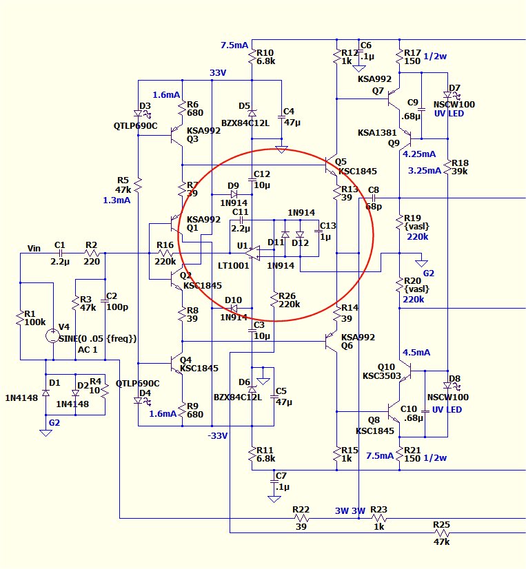

I'll ask the question here ??
To servo or not ?
All have been banging heads on the HF CFA issues. I know it
absolutely excels at HF/speed.
Esperado got me a goin' on the LF issues. With DC NFB , 20- 500 Hz
either is "all over the board" with offset , differing with both amplitude
and frequency. Using a DC blocking cap solves this issue , but increases
LF THD considerably (also does this on a VFA... to a lesser degree).
OEM's almost universally use a servo with CFA's , only on refined or EF3
VFA's will one be used.
I tried the LT1001 for a CFA servo - I don't like chips on my amps ... 🙁
It worked ... and worked really good.
nV on idle (no signal), under 2mV 20-500hz ,and under 1mv 500hz and up.
So , 1 IC + cap/resistors replaces either a huge DC cap + trimmer or
a trimmer/+ precision divider.
Nothing to trim with the servo - it does the trimmin'. 😀
The CFA behaves differently than a VFA with a servo (like my sansui) ...
much more current at NFB (loads the IC). My study of the CFA servo examples (OEM)
shows they feed the servo to the hi-Z diamond , where a mV or two
at uA's will zero that output. 🙂
Thermal inconsistancies will also have NO effect with the servo ...
point that heatgun at the amp .... 1mV will it be.
(Below) is my "upgrade". (any "tweaks"/ ideas - are welcome)
PS - any suggestions for the lowest current/cheapest/single amp 8 pin dip available ??
