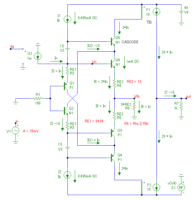

Hi OS and Paul,
Let me explain the CCS noise cancellation in more detail and hope it will answer your questions. But first of all, I address only two aspects of the diamond IPS, thus not the cascode (and recycling of its base current), TIS or OPS.
Below you see a slightly modified version of the 2nd IPS form post 3135. This one is the most easiest to analyze, as all four emitter resistors are equal, also the collectors of the first trannies are tied to the FB input and the two FB resistors replaced by equivalent parallel impedance (just for ease of calculation, later on, you can split them again).
Quite easy, isn't it? But if the collectors of Q1 and Q2 are tied to the emitters of Q3 respectively Q4, the calculation gets far more complicated. In that case I prefer to leave it to my simulator to figure that out (I'm too old for such old fashioned paperwork).

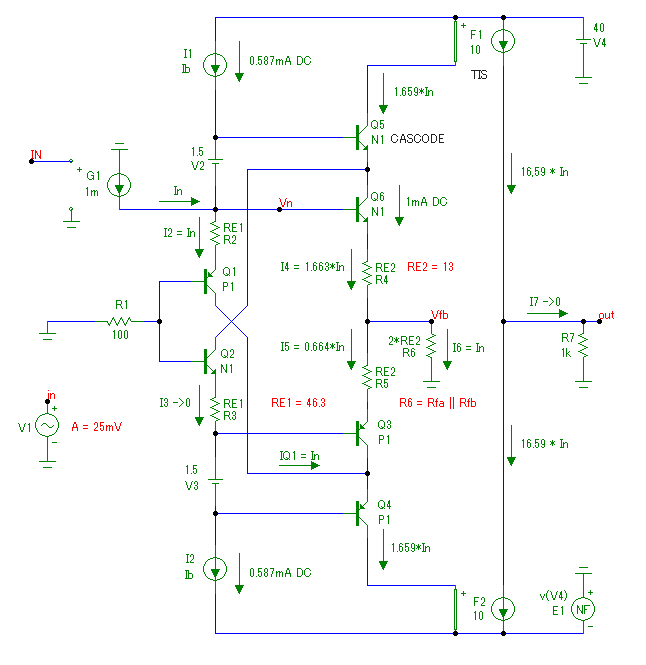

Or maybe tie the collectors of Q1 and Q2 to the cascode outputs instead. This would be to gain some extra Vce across Q1 and Q2 and hopefully reduce the possible quasi saturation issues.
Hi Paul,
Probably, you mean connected to the emitters of of Q3 and Q4 instead (right?). Anyhow, this also is feasible, see below.
If you do it this way, Ic of Q1, which should cancel the noise or hum, has not been attenuated by the feedback resistor network, instead, it is fed through directly to the next stage (though in opposite phase). IOW, it has a greater effect than the noise at node Vn. We can compensate for this by making RE1 larger than RE2.
In the first example R6 = 2*RE2 = 26 Ohms and RE1 should be 46.3 Ohms.
In the second example R6 = 3*RE2 = 39 Ohms and RE1 should be 64.04 Ohms.
Bear in mind that the exact values depend on a lot of other things too, not only on temperature, but also on beta, the source impedance R1, etc. etc.
Notice that in the 2nd example the various currents are (almost exactly) a whole multiple of In. Just an incident when R6 = 3*RE2 ?😕
I don't know yet how to do that as simple as possible. Another issue is the temperature compensation. For a constant gm, Ic should rise with the absolute temperature, but then, other stages might be compromised. As you see there are still a lot questions to be answered.The "next project" sounds interesting. This issue did cross my mind the first time I used this type of input stage with cascodes. Never thought of recycling the current though.
