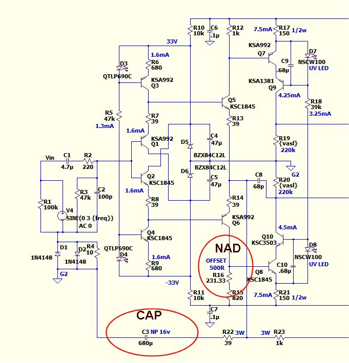

Sorry, no schematic with your post: i thought it was about a DC blocking cap between feedback bridge and ground.
Schema below , NAD does the offset and cap the same way.
I also looked at the NAD layout for any thermal considerations.
The NAD's VAS runs "hot" (big heatsink), mine is at 4.5ma.
I also have Bonsai's NX as reference (DC w/ trimmer on NFB).
I left the option open for NO cap (true ground ref.) for FB divider.
I know there will be a V1.1 😀.
PS - lucky for me , just a 75mm sq. fr-4 PCB , won't have to "scrap" the OPS.
OS

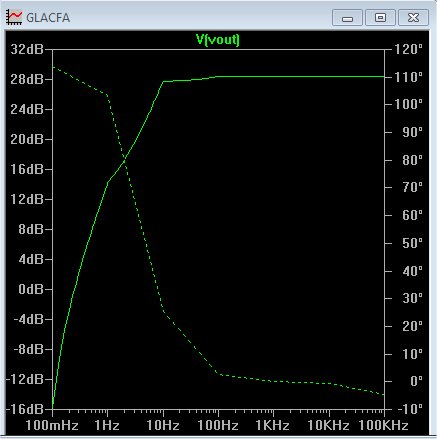

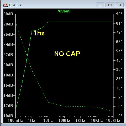

OK , as far as the Cap ... I will use a 1Kuf /25V BP panasonic (105C).
Another aspect of the DC vs. CAP issue.
DC gives me a 1hz rolloff ... "rumble" - I don't use vinyl .. 😀
The CAP rolls off at about 10 hz , about the same as a VFA with my
standard 220uF blocker.
I could easily run my diamond/2'nd stage at 2+ mA , as you suggest.
I use 1.6mA because this is where the 1845/992's have lowest THD.
2-2.5mA is real close .... just a couple ppm.
OS

So, try a sim with 1Farad, and compare distortion at 100Hz with your 0.1F
Thanks , I usually don't concentrate on LF THD. You are correct !
DC= .004%
1F = .005%
1000uF = .01%
At about 500hz everything becomes equal again (20-25 ppm) .
Another drawback of CFA. VFA does not do this.
Edit- VFA DOES do this (but not as much - .005%100hz from 5ppm 10khz).
DC NFB has purpose.
OS
