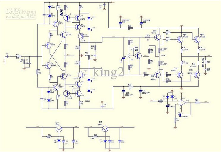

CFA Topology Audio Amplifiers
Whose done this here?
-RM
I would likely do it if i could see it would work.
But we are talking CFA here!? Where is IN-??? Where is the feedback loop to be placed?
- Sonny
PS: But i would make I1 and I3 slave of I2. Maybe reduce the current translation between I2:I1 10:1.... But it would certanly help getting the idle current in the Transistors connected to I1 les modulated.

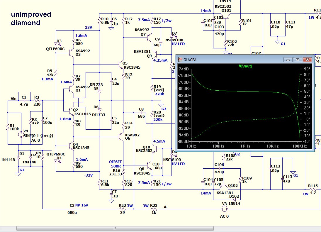

I'm "digesting" post #3135 now.
"Oh where, oh where... to put them diamond collectors"😀
Noise goes down , yes... THD/slew stays the same. But , I lose
6db of PSRR taking the diamond collectors from the emitters of stage 2 -
(versus using the fixed 15v or 33v zener reference).
I show both "flavors" below. 1 is my original ,2'nd is attachment 2
modification from post 3135.
Edit - had to adjust Q5/6 currents as the diamond current is added to this stage now.
OS
"Of course one could calculate analytically the proper values of the emitter resistors, but as I am lazy, I used my simulator to figure it out, though it's an iterative process.
In the example below, Ic of the output trannies (Q3 & Q4) were set to 1mA. So for lowest distortion RE2 should be: 0.5 * VT / Ic = 13 Ohms. Check this as shown in fig.1."
This something like how I got to 15 Ohms in my nx and sx amps for RE.
Ostripper, I wonder what would happen if you split the FB network an inject it where you connect the diamond, and then let the degeneration resistors be the backside of the feedback with the center point tied to the DC blocking cap. Then you would actually also inject sone feedback into the input diamond
Tried that , too ... It does increase slew , as does ES's 2'nd circuit.
I tied the collectors of the diamonds to:
1. The fixed zeners (12 -33V)
2. A point between the 2'nd stage and a set of cascodes
3. The CF point (like you suggested).
4. Even to the CCS collectors.
ALL 4 worked well , giving the same 20K 10-20ppm 1/2 power THD.
PSRR descended from #1 to #4
Denon , Marantz , and NAD all have patents on the "base" circuit like
the ones I posted or the NX.
NAD's 372 is a close match for mine. this CFA hoopla is 20 years old ...
I'm surprised so few projects have taken so long to appear 😕 .
I should of listened to apex ... who dropped some examples on this thread.
Looking at how the OEM units are designed and how long they lasted -
The 372's are almost a decade old , all still work (no design issues) .. some
of the older Marantz CFA's are being recapped and sold as "vintage" on ebay.
Also simulated the marantz MA9S2 (below) with wilson CM loaded Hawksford.
NO "silver bullet".
You would not believe all the marketing hype CFA was given - "hyper current drive".. blah blah .. 🙄
etc.
BTW - the VSSA/peeceebee are simplified variants of older marantz's.
Now I know how to build 'em !! (OEM examples).
OS
