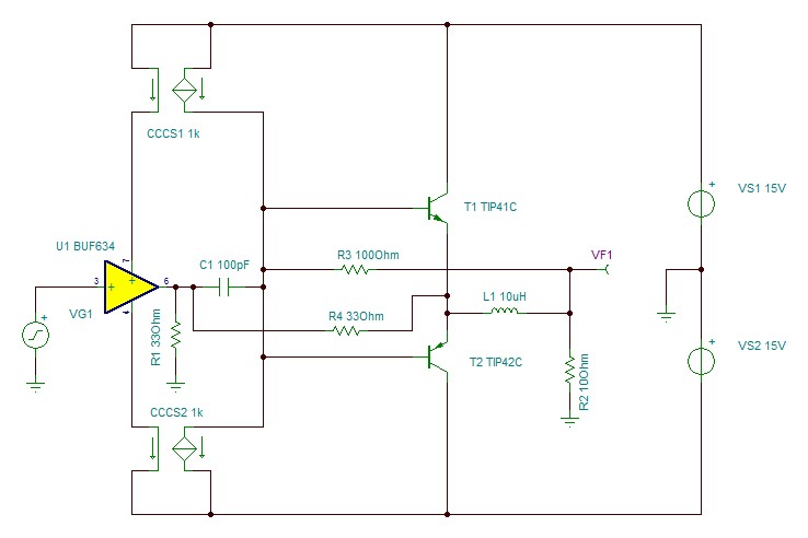

The operation going from low current/high Z circuit to high current/low z circuit values/operation with same topology caused the circuit to behave more like CFA in regards to peaking/gain/distortion (both lightly loaded output - this was a line level amp) etc. Might be able to SIM and see now?
Yes. There is a lot of curves in OPA datasheets about various values of feedback impedance.
Give-me some time to produce sims from my comparison circuits.

It is just high frequency isolation using inductor, there are no current dumped, the current is still flow.
But if you compare your original TINA schematic with this current-dumping topology (attached), you'll see why I pointed out the similarity!
(The bridge values are for illustration, and not the correct ones for proper bridge balance!)

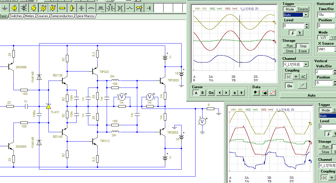

Yes it has similarity. If it is called as current dumper because of power wasted by phase shift, inductor at bases also did it but less.
Inductor help to prevent gained reverse phase at fast-feedback by placing OPS more as outsider.
See attached images for its phase shift, inductors at bases are better.
