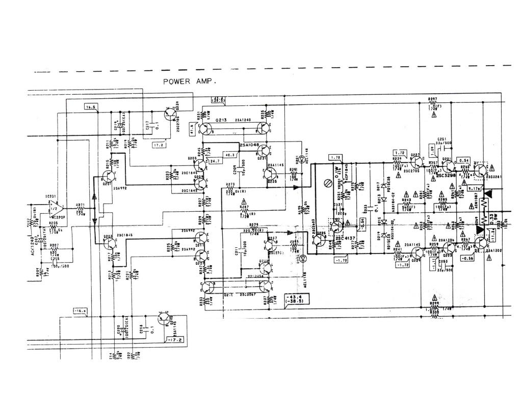

There is many commercialy CFA amps, all new Marantzs are based on old Pioneer A400 circuit

A400 is diamond buffered input , Wilson VAS , AND compound Vbe EF3.
My design came to these same "conclusions" without knowledge
of the old pioneer.
Have you seen or heard this amp ??
ps - also notice the a400 is low gain in the power amp - they use an op-amp
for the rest of the gain , like SYN08's "VSOP" .
of the old pioneer.

I post this circuit in your thread post #30
http://www.diyaudio.com/forums/solid-state/243842-gla-good-little-amp-survivor-3.html
There is thread with pictures
http://www.diyaudio.com/forums/solid-state/211983-pioneer-a400-power-supply-caps-2.html

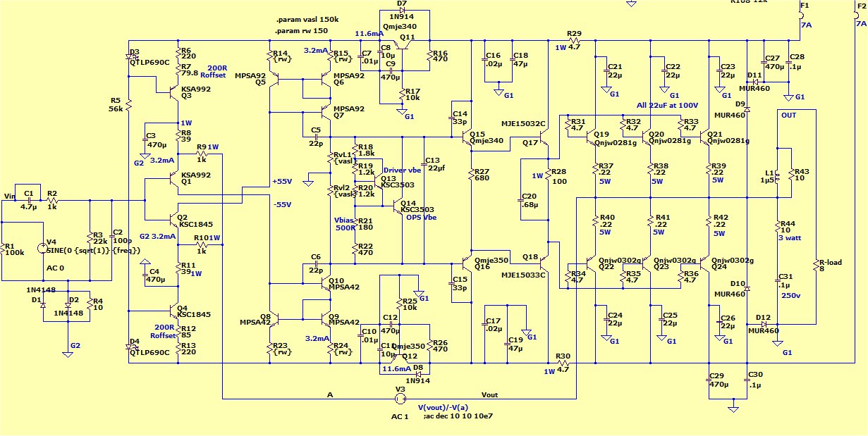

wilson's controversial amp...
amp asc. files are below.
Just for fun , remove all compensation (C5/6). She still runs. 😀
Remove a current source , CF keeps offset below 5 V .. speakers
would not burn. A Very" idiotproof" design , as well.
By swapping models , "critical" matching would not be an issue.
As easy (or easier) than most of my VFA designs.

I'm going to make this one look "eerie"/controversial (UV led CCS's) ....

Beter use ksa992/ksc1845 instead mpsa42/92 in place Q5,Q6,Q8 and Q9.
Excellent idea .
Those devices only see 5-6V , and are the ones thermally coupled both
in the schema and photos.
Q7 and 10 would be good candidates for the fairchild ksa1381/ksc3503.
Nothing would have to be heatsinked , all run under 4ma.
