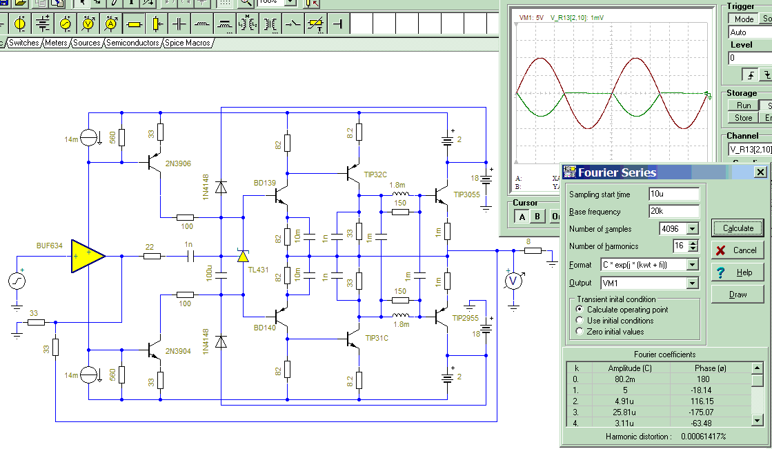

Hi ontoaba, I see you are re-inventing the Quad current-dumping amplifier now!
It is just high frequency isolation using inductor, there are no current dumped, the current is still flow.
Seems that Current is means Controversial in Audio World😀.
OK I've changed the isolation to another place: 0.0006%THD 20k, still oldie slowie OP devices with 0mA bias.

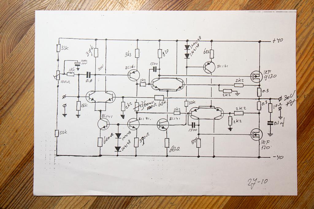

And here another amp with output current sensing. Also in this case, its sole purpose is controlling the output bias current.
Cheers, E.
