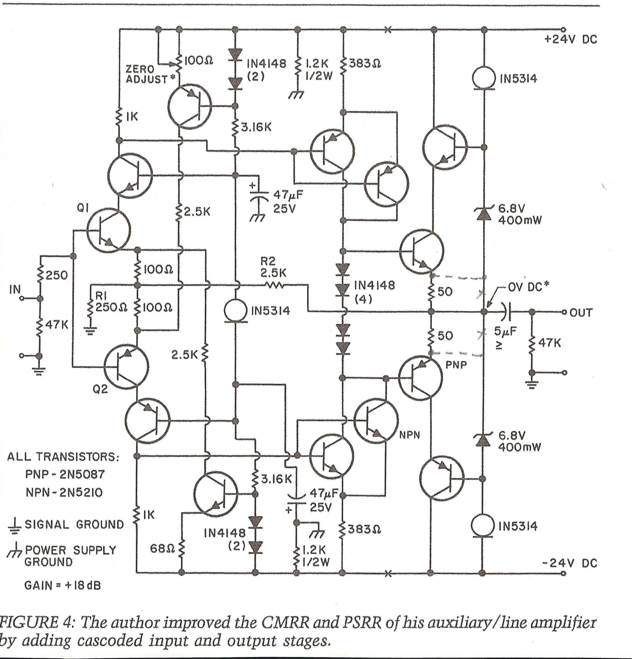

Lets put the power supply sensitivity to bed for the time being. You might find it interesting to the extent that cascoding will improve CMR as well as PSR. If you have a very low distortion design (under .001% thd), then you dont need to use cascoding to lower the distortion . But you can use it to increase the CM (Common-Mode) Rejection aas well as the PS (Power Supply) Rejection.
That is what I tried after the 1980 design which ended up looking like this a.t.t. If you try to SIM it and you do not get the 'measured' results i got, then see what you need to correct in the SIM to make it match reality. [I think the outputs were 2N2905A and 2N2219A.]

Hi Bonsai,because of the finite current available to charge the compensation capacitor, rather than the input stage as is the case with the VFA?
This assessement (slewing of VAS limited by VAS input current to charge the miller) I never grasped because it's so contrary with my findings. Which are: The higher the VAS standingcurrent with a given miller cap, the better the VAS slewrate, while the available input current from the LTP never changed. This is in contrast to that assertion.
I think many view the miller comp as a "bypass" from the VAS input directly to the VAS output. While a fact is that the VAS output is an inverting node to the VAS input. It acts as a "counter bootstrap" to the input signal. A "brake" on the inputsignal when Cmiller's Z becomes low enough. Due to the inverting operation of the TIS transistor I feel the charge/discharge primarily comes from the VAS output, rather than from the VAS input.
Hello Magicbox, the LTP current in a conventional MC VAF is absolutely sets the slew rate. But, don't take my word got it - Self, Cordell and Prof Leach discuss this in depth in their texts with associated math. You can break this relationship and speed things up considerably of course by going to MIC - Bob Cordell discusses this in his book as well.
Odd, while I take their word for it, I wonder how the VAS output standing current comes into play with this. Mind you, I'm not talking about MIC.Hello Magicbox, the LTP current in a conventional MC VAF is absolutely sets the slew rate. But, don't take my word got it - Self, Cordell and Prof Leach discuss this in depth in their texts with associated math. You can break this relationship and speed things up considerably of course by going to MIC - Bob Cordell discusses this in his book as well.
Maybe it helps to reliealise that any current 'into' the Miller comp cap also has to 'come out' of it.
So on the Vas output side there is generally enough current to 'come out' of the miller cap, but that current also has to 'go into it' at the base side, and the only place it can come from is the diff input stage output collector. So, ultimately, it is this LTP standing current that limits the charge current and thus the slew rate.
