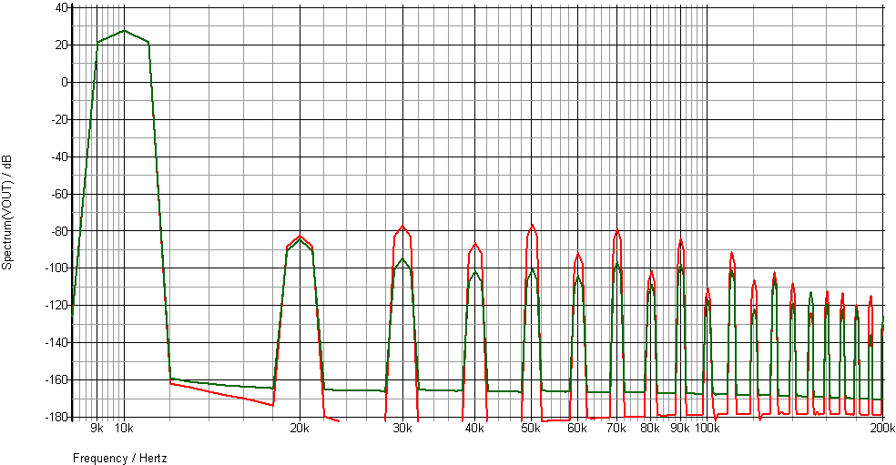

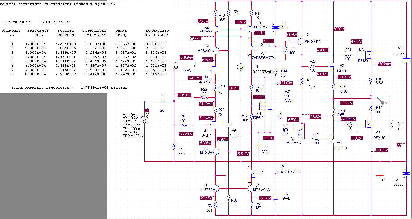

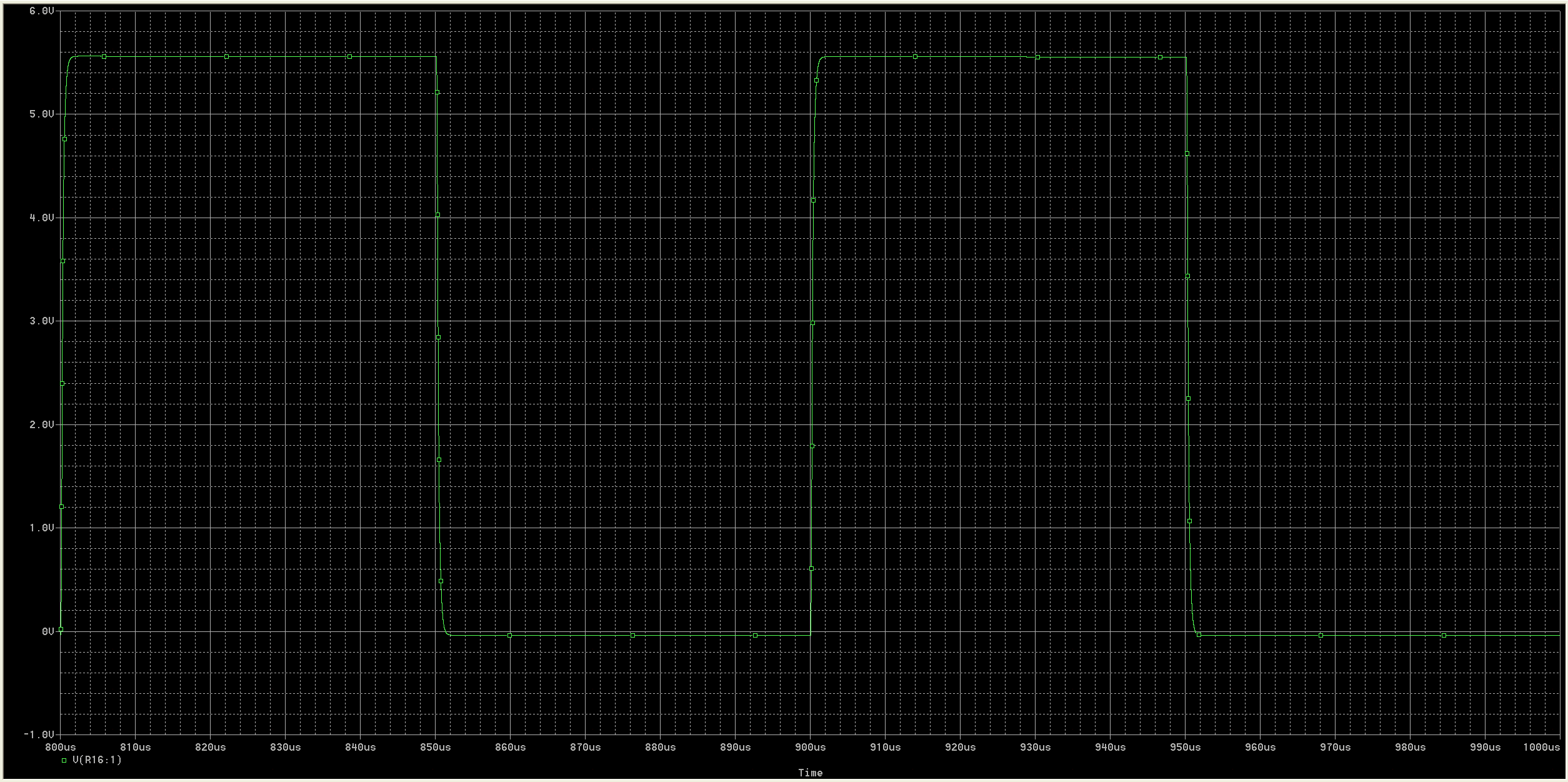

I've been pecking away at the circuit shown in post #119, with some improvements. Per R. Marsh's observation, a follower was added between VAS and output stage. This made the amp much faster, and gave me a lot more freedom in choice of compensation, as the the output mosfet gate capacitances no longer dictated the dominant pole.
I got some improvement in harmonic distribution by using mosfets rather than BJTs for cascoding the VAS.
Cascoding the JFET input stage yielded significant improvement in input offset, as the 2SK170 and 2SJ74 gates get really leaky for VGS higher than 7-8V or so.
The VAS stage is run rather hot, but as I envision this as a mostly Class A amp anyway, the extra dissipation is a drop in the bucket.
BJTs used in the simulation were placeholders (the models were conveniently available). Possible devices for a real-life amplifier are MPSW06 and MPSW56 (80V, TO-92L), 2SA965 and and 2SC2235 (120V, TO-92L), and KSA1220A andKSC2690A (160V, isolated TO-126).
In the current simulation, the VAS cascode mosfets are run pretty much at their limit for practical free air dissipation. Using the 100V version of the devices and gluing on supplemental heat sinks would allow running a high enough voltage on the input and VAS stage to squeeze the last bit of power out of the output mosfets. I wish Supertex still made their small-die mosfets available in a TO-220 package....
In practice, I would match the input jfet pair. For simulation, I just used the models available in PSpice.
This circuit would need some sort of offset adjust or servo in practice. The current source hanging from the top side current mirror was used to trim the output voltage in my simulations. A suitable opamp cascoded and hung between the top and bottom current mirrors would work ok. A pot and a resistor might be good enough in practice.

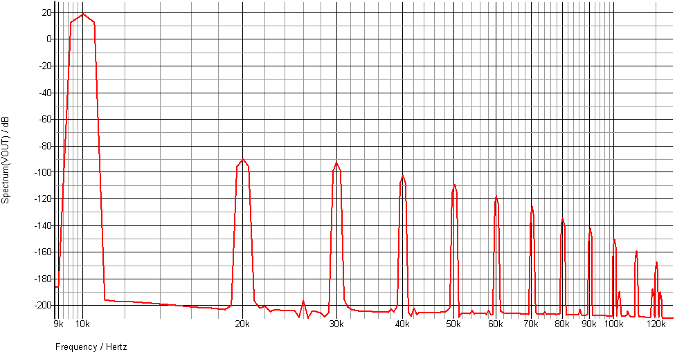

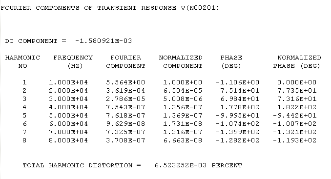

Attached are the distortion simulation results for a simplified version of the circuit just posted, ditching the VAS cascode and replacing the bipolar mirrors with mosfets (in this case, ZVN3310A and ZVP3310A (Zetex/Diodes, Inc.). The distortion goes up a bit, but the hit looks to be in the 2nd harmonic, which may be be an acceptable compromise allowing one to throw out a bunch of parts. Each mirror pair would have to be mounted on its own heat sink for thermal tracking (as well as to reduce the temperature of the VAS half of the mirror), since the difference in power dissipation between the two halves of each mirror is considerable.
