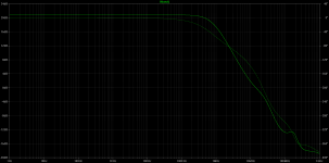

Going back a bit I've been thinking about square waves, PM and the overall amplifier Q.
In Bob Cordell's book there is a graph of overshoot/frequency response peaking and PM (page 91).
Is this graph related to amplifier Q and how does this relate to group delay? As if you get a consistent group delay you get good square waves but also critical damping should give good square waves.
Apparently, so I read, to get critical damping (ie good sqaure wave output) you end up with a PM of 70 degrees.
Forgive my diversion from the current topic in this thread. Just needed somewhere to dump some thoughts and I seem to remember that amplifier Q was mentioned earlier.

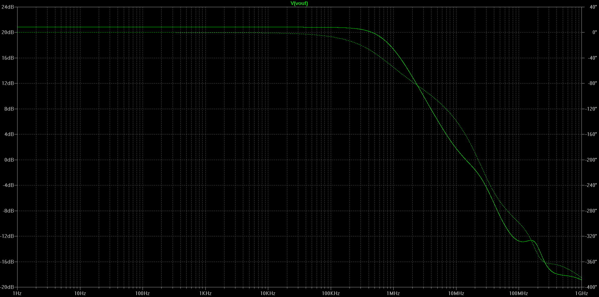

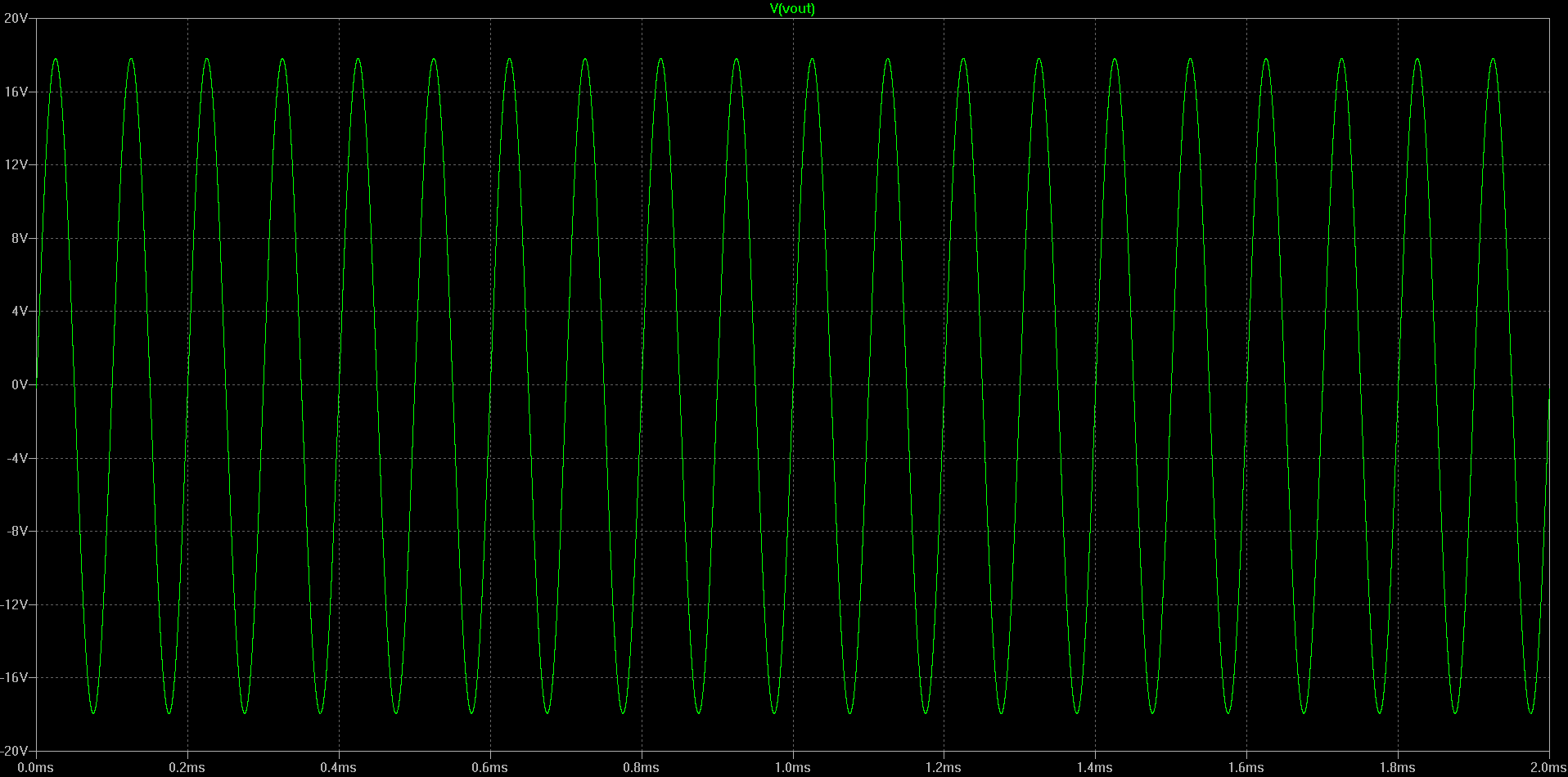

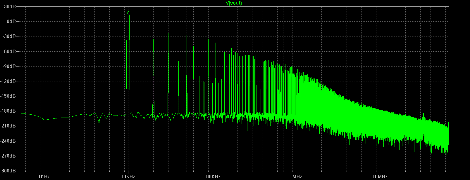

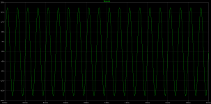

simmed
if this brave preamp sounded good that means that THD is not good tool for estimating of the quality of the amps.
I had to add Miller caps to stabilise it.
with output voltage as shown had thd ~0.7%
with output voltage 2Vpp thd was ~0.4%
comparing its thd to Dadod's no gnfb thd looks very poor (http://www.diyaudio.com/forums/solid-state/235695-no-nfb-line-amp-gainwire-mk2.html) but I guess that thd is bad thing for comparing the quality of the amps😕

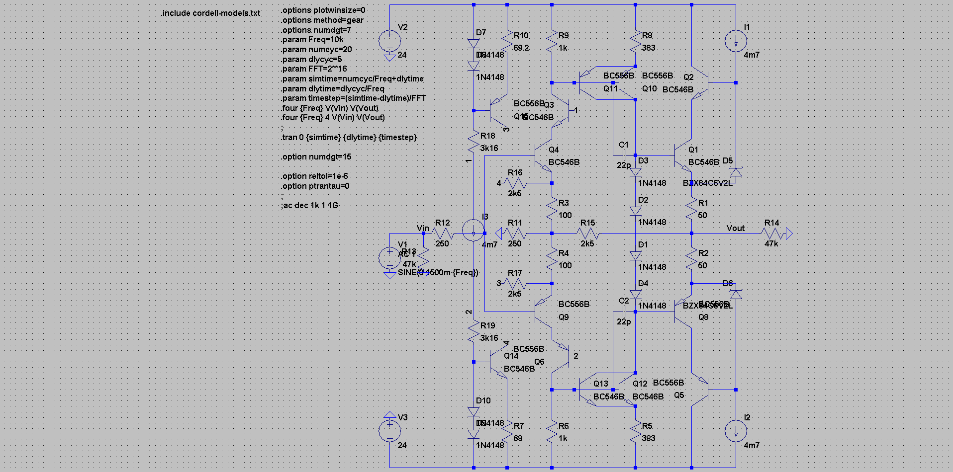

CMA Requires matched compliments -
I wonder why I anticipated that result with a SIM... I said you would have to figure out why a sim doesnt match the measurd test data results. Didnt I?
[ps... put the output zener back to the output and not the emitter. The values of the Re are wrong for that config.]
Its a learning experience. But I gave clues in the characterization of what is needed to have a CMA; Namely, exact matching of transistor characteristics. I used a TEK 576 curve tracer and tested transistor compliments until I found a pair that over-laid each other exactly on the curves. This can now be done, since the 1990's, in IC fab processing. That is when the CMA was able to take-off and become a reality. Find compliments that are exact is needed and a requirement. If not, you will have to rely on gnfb only.
Intuitively, I thought... if a design was symetrical and complimentary and the transistors were exact compliments, distortion would cancel. And, it is true. Thus, very little nfb is needed afterwards.
Thx-RNMarsh

Once pointed out... it is obvious--- To the degree the devices are Not complementary, the distortion will not cancel in a balanced, sysmetrical circuit and distortion will be higher. So, you have to match them by hand for the descrete DIY'er/builder. You'll neeed a characteristic curve tracer. Some deveices are closer than others in being similar. You might find which ones and select from those. I am sure people here have some ideas which transistors they are and can give suggestions. They are going thru the matching for the Marsh headphone amp and have found some very close matches right out of the box -- see #629 for output devices, for example.
Without good matching, you do not get a cancellation and only nfb (VFA) works in that world. Going with the best (for audio) CMA in IC form might be more practicle... certainly more expedient/convenient.
Meanwhile, just put all your sim device characteristics to be the same for npn and pnp to see the cancellation better. Then optimize from there on R values, currents, device c's and strays etc etc.

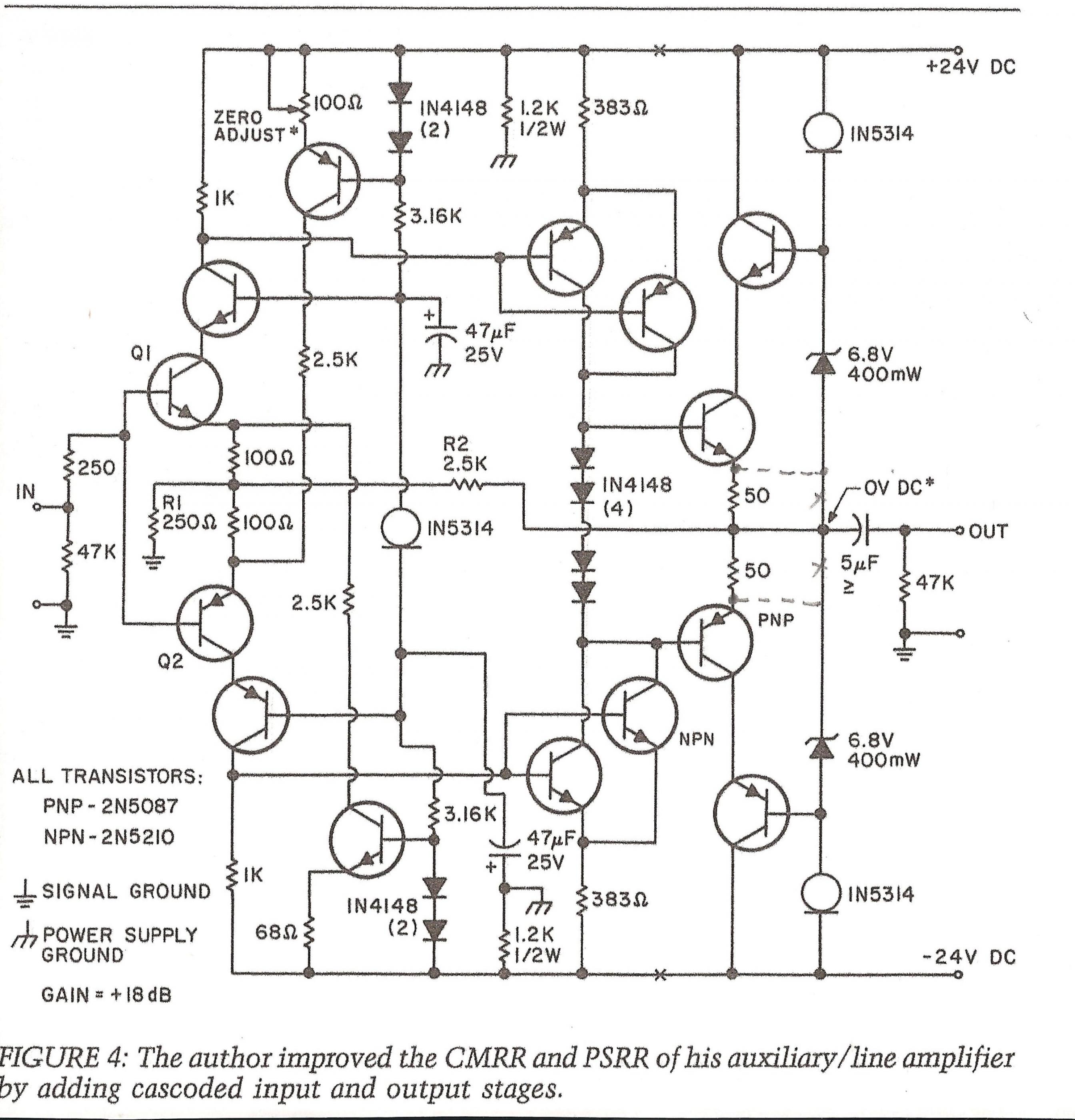

Lets put the power supply sensitivity to bed for the time being. You might find it interesting to the extent that cascoding will improve CMR as well as PSR. If you have a very low distortion design (under .001% thd), then you dont need to use cascoding to lower the distortion . But you can use it to increase the CM (Common-Mode) Rejection aas well as the PS (Power Supply) Rejection.
That is what I tried after the 1980 design which ended up looking like this a.t.t. If you try to SIM it and you do not get the 'measured' results i got, then see what you need to correct in the SIM to make it match reality. [I think the outputs were 2N2905A and 2N2219A.]
Thx-RNmarsh
RNmarsh,
Interesting schematic!
While I fully agree on the use of the output cascodes, It's a bit more difficult for me to see the use of the input cascodes here.
They seem to "isolate" the collectors of the input transistors from the voltage across the resistor to the supply rail. And this voltage is almost constant and equal to a BJT's Vbe
If possible, a "dynamical" cascode, like on the output (more like a bootstraping cascode) could be very beneficial. It could either be input driven, or driven by the feedback node, whichever is the most convenient (I bet on the later)
You need a min theoretical phase margin of 75 degrees for that. This results in min overshoot and fastest settling. As a real speaker represents a varying load, ideally you should shoot for slightly higher, around 80 to 85. Its prudent to have a min gain margin of 15 as well. A good side effect youll notice is that THD is lowest around this point.
Paul according to this criteria your amp is right on the ball park.
This is a benefit of the CFA topology, it is randomly and easily achieved.
