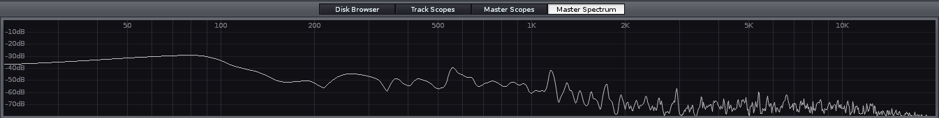

When you look in practice at what slewrate is sufficient, you just take a look at a FFT of music content. I think someone linked the spectrum content of many types of music content added together. One will see that the upper frequency of this spectrum (15K - 20K) has an extremely low amplitude compared to that of for instance the 1K signals.
Making an amp capable of staying within its slewing limits with a full power 20K sine generally makes sure there's enough slewing capability at the actual levels of real 15K - 20K content.

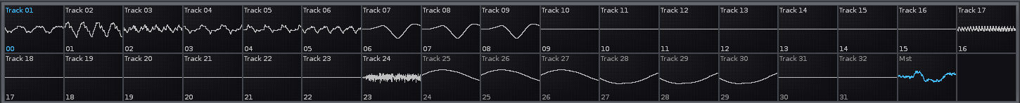

That's entirely correct. The actual signal is an addition of all the elementary sines/wave forms that comprize an instrument or a voice. See the picture attached. You'll see the wave forms of individual instruments/tracks. The last window with the blue trace labeled MST is the sum of all the individual tracks: A single, instantaneous value at any given time.

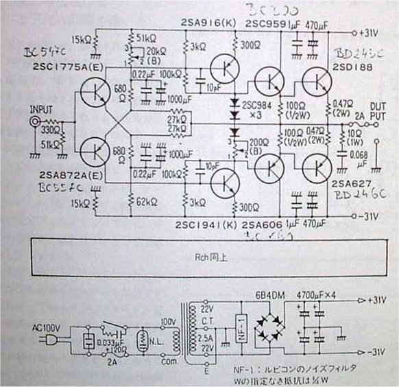

good designed PSU is allways corner stone for good sounding Amp ( SS-CFA included) ! and is interesting to see that in case of ordinary linear PSU almost nobody insist on electrostatic schield between main transf. primary coil and secondary coil which Must be connected on AMP central ground star point .
Here is one except :
