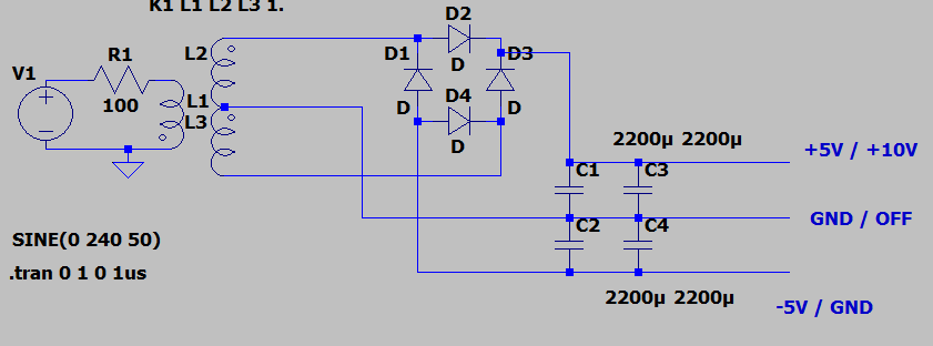

I am trying to build a power supply that has the capability to change voltage and curent via an adoino. But first do I struggle with the problem on how I can change output from +-5V with center tab and to 0-10V without center tab.

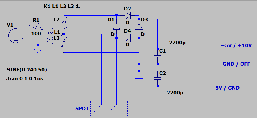

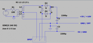

I have found some sort of clumsy way for enabling and disabling the center tab, but there have to be a better way. I have searched here and on google, but with no luck. Hope you please will help.
Just hard wire the entire +/-5VDC supply, and switch the DC output connections instead.
Sounds logical but how do I do that, sorry are a noob.Just hard wire the +/-5VDC supply, and switch the DC output connections instead.
You'll have three output lines: +5V, common, and -5V.
For +/-5V, you select all three lines to the proper 3 output connections.
For +10V, you select the +5V and the -5V lines to the proper 2 outputs,
and leave the center tap line open.

Oh so -5V do just act as ground and +5V has a potential of 10 over ground?You'll have three output lines: +5V, common, and -5V.
For +10V and 0V, you select the +5V and the -5V to the proper 2 outputs,
What is it you are powering with the supply?

For +10V, the ground/common line is floating/open, and you connect the load between +5V and -5V.
Connect the -5V to the powered circuit's ground, and the other line will be at +10V relative to ground.
If it's for lab use, I'd not switch anything and just have 3 output terminals, connecting externally as needed.
That's how lab supplies are normally made, usually with tracking between positive and negative voltages.
Yours will track automatically, since it's just one supply circuit. You probably won't need the two voltages
to be unequal in most uses. Do you need to vary the voltages, or just choose between +/-5V and +10V?

Maybe there is a slight problem in just hard wire the connection, the capacitors do then connect in series and loose half of it's capacity.

But am I right in that if I hard wire my schematic from first post, to deliver +-5V, that the capacity will be halved when using the psu as 0-10V ?
Thanks a lot! I'll do that now🙂
The maximum current output will be the same, since the two supply outputs are used in series.
The ripple voltage will be doubled on the 10V connection, compared to the 5V, since the ripple voltages
add also. But it's the same % of the DC level as for the 5V. Both the voltage and the ripple double.

Think of two equal resistors connected in series, between the +5V and -5V, with no connection to the ground.
The middle point of the resistors is at 0V by symmetry. Equal current flows in each resistor,
since they are in series, so there are equal voltage drops across each resistor. The center point must be at 0V.
Then the center point of the resistors can be connected to ground (also at 0V) with no change in the
circuit's operation. Now there are separate loads on each 5V output, but the circuit doesn't know any difference.
The ripple does not change, just the way you look at it.

So if I understand you correct, do the ground act as Null no matter that I only use +5V and -5V? That I get +10V out because there are 10V difference between the two leads, no matter that they both are connected to ground?
I have made a new drawing, that illustrate what I think you mean.
There are only voltage differences, that is, the difference between two circuit nodes.
There is no "absolute " 0V; we just define a convenient node as 0V, and measure
other circuit nodes with respect to it.
The power supply "ground" node does not have to be our reference node.
If we ignore it and leave it unconnected, any other node can be the reference 0V node,
such as the former -5V node. If that node is now defined as 0V, then the former +5V node
will measure +10V wrt the new 0V node. If we measure the former "ground" node,
it will be at +5V potential wrt the new 0V node.
You build the supply with NONE of the connections going to ground. What you are calling ground is the common within the circuit. You simply put three terminals - insulated - on the panel of your supply, +5, -5, and C. Then you connect clip wires to it however you need.
You can connect ONE terminal to ground in your unit under test. So if you need +/-5, connect C to ground. If you need +10, connect -5 to ground. If you need -10, connect +5 to ground. The three terminals float electrically.
Imagine a 9v battery in your hand. Neither end is "ground" until you connect ground to one end.
I recommend making yourself call the common in your supply "common" rather than "ground". Save "ground" for the unit you are working on.
