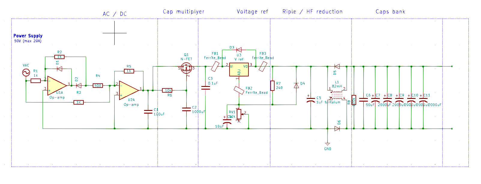

You are great, that you keep helping me!Most op amps can only output around 10mA.
Most 3 terminal regulators have around 1A output, so it would need a "boost" device to carry the large current.
What if I use comparators instead of op-amps?
Do R2 and R5 not let the amps go around the op-amp, so not to destoy the op-amps?
May I please ask you to present a booster on a silver plate?
I have no idea on type of booster, function or implementation nor connecting.
So I am fare lost here!

Funny, the top schematic, looks a lot like my solution.Here's one idea for a higher current linear regulator, there are many variations.
Creating a high current LM317 regulator | All About Circuits
But are all the schematics not thought to be used after the rectifier?
The solution I try to use should almost eliminate any voltage drop and thereby reduce heat a great deal.

But that's not a high current rectifier, op amps are low current devices.
Transformers typically lose 5%-10% of the power.
You are completely right, would you just use a diode bridge instead and live with the voltage drop?But that's not a high current rectifier, op amps are low current devices.
Is there a way to lower the heat dispensation?

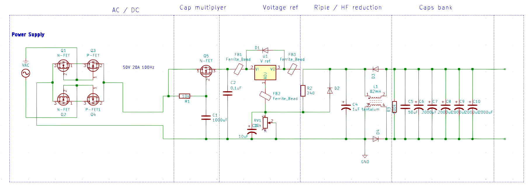

Synchronous rectifier (transistors used for the rectifiers). Example:
http://www.ti.com/lit/wp/snva595a/snva595a.pdf
Wary interesting, I'd try to read it trough several more times and try to use some of itSynchronous rectifier (transistors used for the rectifiers). Example:
This circuit has some small mistakes and don't supposed to work with 20 A, it's several amperes maximum, if we make same change (connect power line to mosfet).Is this circuit usable for 50V 20A 100Hz?
If TS don't knows what to do with such cirquit then I recommend find something else.
If TS needs just several amperes regulated voltage then I recommend use only integral regulator, like LT1083.
I'm afraid that rectifier part, q1-q4, cant't work if AC voltage will be higher than 15-20 V.I have read the pdf and several other texts about rectifier and think I have arrived to the conclusion that MOSFET's with a build in Schottky diode, should give least voltage drop and most stable rectifying.
There is "ideal diode driver" IC for such type active rectifiers, LTC4320 for examole - it works up to about 70 V (I don't remember exact value).
Easy way of use this circuit - change Q1-Q4 to Shottky diodes (for large currents, >3-4 A they need radiator cooling).
Thanks! Sounds wary interesting, sorry for not replying before. Do the rest look like it could work and effective lower ripples?I'm afraid that rectifier part, q1-q4, cant't work if AC voltage will be higher than 15-20 V.
