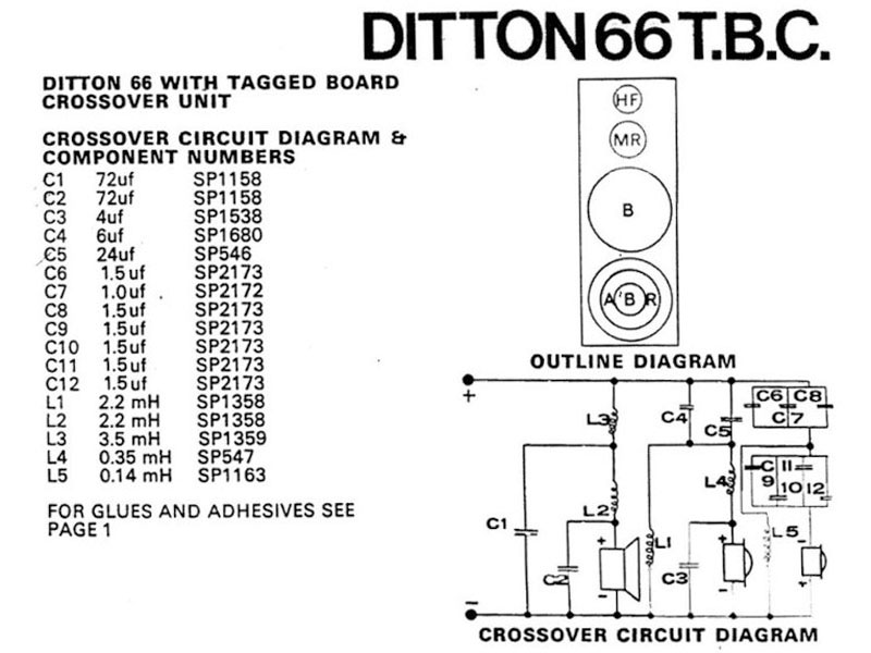

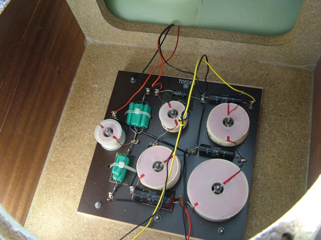

attached is a pic of my xover & the tbc circuit.
WHERE in the photo is C5 ?

Hi Doug ,
There is no C4 in your 66s.
Celestion stopped using the C4 , likely because it was causing crossover too low to the mid-dome.
C5 is the 24uF in your photo.
For C5 use ClarityCap PX 25uF.
"Madisound" still have stock of those.
Madisound also still have stock of ClarityCap PX in 3.9uF and 6uF for the tweeter circuit , and those will work better than the bunches of smaller values in parallel.
I would use ClarityCap PX 3.9uf plus the resistor as I originally advised you for C3 , but if you want to use an electrolytic cap there then use Mundorf E-Cap in their "PLAIN" series ,

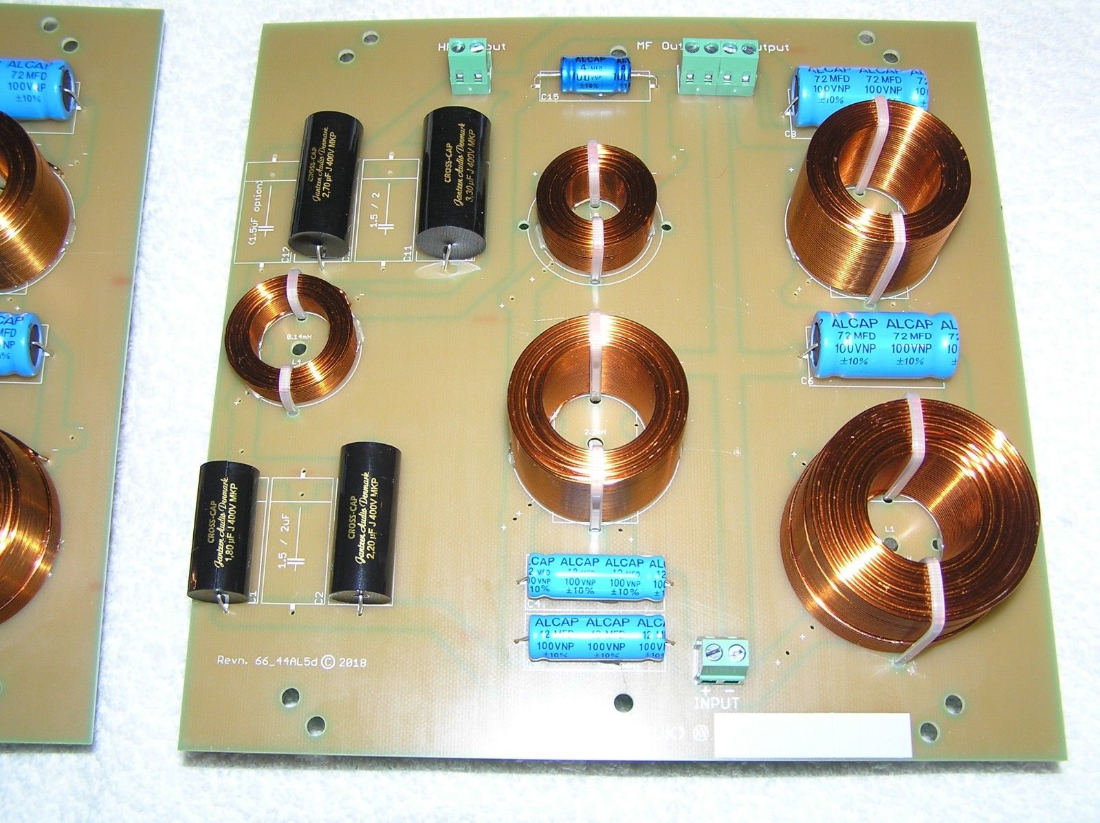

thinking of making a complete xover new board, so as to keep original.
c1 & c2 = Alcap 72uf
c3 = alcap 4uf
c5 = alcap LL 12uf ( x2) in parallel
c6,7,8 = clarity px 3.9uf
c9,10,11,12 = clarity px 2.2uf & 3.9 in parallel
roughly 40 -50 dollars (CA) for 5 new inductors . parts express have Jantzen at more cost than Madisound brand.
thoughts?

Hi Doug ,
several points , as follows:
(1)- if you are going to make new crossover boards , and buy new inductors ,
then you may as well do the job in such way as to minimize the magnetic coupling between the inductors because that will give clearer sound.
Go back to Page 103 and read in my Post #1022 about options of Sizes for the board , and next about where and how to place the components on the board.
(2)- Jantzen brand inductors cost more because of how they are manufactured , and also because they are imported from Europe.
The Madisound branded inductors seem to be made by Solen who are in Canada thus less shipping cost to Madisound.
If they are not made by Solen then they are made by someone who is copying the Solen design.
(3)- For tweeter inducter , L5 0.14mH , buy one that has between 0.4 ohm and 0.5 ohm DCR but not higher DCR, because a small amount of resistance is needed in the circuit there.
{ Ideally 0.4 ohm }.
For midrange inductor , L1 2.2mH , buy one that has DCR of 1.2 ohm DCR or very slightly higher but preferably not as high as 1.5 ohm , because DCR is critical there and Celestion's original inductor there has the optimum DCR.
For the other Inductors buy with as low DCR as you can afford so that maximum of the wanted signal is not lost in DCR in those.
That is you will then have a physically larger size coil for L2 2.2mH than for L1 , and L3 will be physically very large.
The reasons for the above are that for inductors connected in Series with drivers usually one does not want to lose the wanted part of the signal in resistance ,
but for inductors connected in Parallel with drivers a small amount of DCR reduces the electrical resonance of the crossover circuit and driver combination - very low DCR inductors there often cause worse sound.
Celestion used the significant DCRs inductors for L2 and L3 because those cost less than lower DCR inductors , and most importantly because when the 66s were made most Amplifiers would not drive 4 ohm loads to high volume levels , but now modern amplifier designs allow for higher volume levels driving 4 ohm loads , thus unless you are are using a vintage amplifier install lower DCR inductors for L2 and L3 and you will get a clearer defined bass sound.
Use Nylon or Plastic bolts or cable ties to hold the inductors onto the board.
Do not use Steel bolts , and preferably not any type of Metal bolts , because metal through the centre of the inductors is effectively a core and thereby increases the Inductance , and also it causes early Saturation which causes muddy sound.
(4)- Madisound have ClarityCap in 6uf.
Use that instead of 3.9uF + 2.2uF in Parallel , because the single cap there will give clearer sound.
(5)- As you have decided to use Alcaps in the midrange and woofer sections , then use a 3.9uF or 4uF LL Alcap for C3 because it will have longer service life than the non-LL types , and probably will give clearer sound.
(6)- Two of 12uF LL Alcaps in Parallel will work for C5 if you do the soldering very neatly at each end , and also not wind the caps' leads around each other but simply solder both together at the single point where each connects to the next component of the crossover.
Scrape clean the relevant section of their leads before you solder so that there is no remains of the oxide which forms on all leads during storage after manufacture.
(7)- As you have decided to use Alcaps for C1 and C2 then you will hear what these do to the sound , and as they are low price you will not have lost too much money if you decide you do not like their sound.

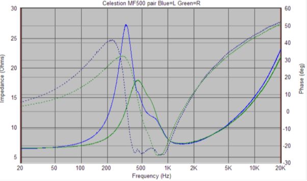

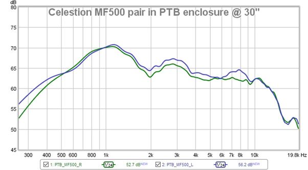

Having measured a selection of MF500 and MD500 units (in free-space without a baffle), I have found MF500 units that have identical frequency response to MD500 units, MF500 units that have different responses to other MF500 units, and MD500 units that have different responses to other MD500 units. I am therefore unable to conclude with certainty that the MF500 and MD500 have different tunings.

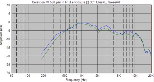

Here is one example comparing two different pairs of MF500. The measurements were made in free space without any baffle (the driver was placed on the carpet facing the ceiling and the mic was positioned 1 metre above it):
Has anyone else taken measurements of multiple pairs of MF500 and MD500 units? It would be good to compare notes. 🙂

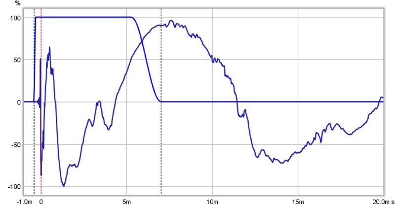

The following graph compares the overall system responses of two pairs of Ditton 66 I have rebuilt. The one labelled '2015' uses T1600 bass units, MF500 mids and 30uf in the MF circuit. The one labelled '2018' uses T2169 bass units, MD500 mids and 24uf in the MF circuit.
The measurements were taken at my listening seat, not in an anechoic chamber, so there are lots of peaks and dips in the response, but the two speakers were measured in the exact same location, so the results can be compared with confidence.
I also took nearfield measurements from 1 metre distance:
According to the measurements, the 66 with the MF500 has stronger output from 750Hz to 1.5kHz while the 66 with the MD500 has stronger output from 300Hz to 500Hz. There is almost zero difference in the response between 2kHz and 4kHz. The difference in HF output above 4kHz is purely due to variations in the HF2000 units used. (I measured a total of 13 different HF2000 units and found huge differences in their response!).

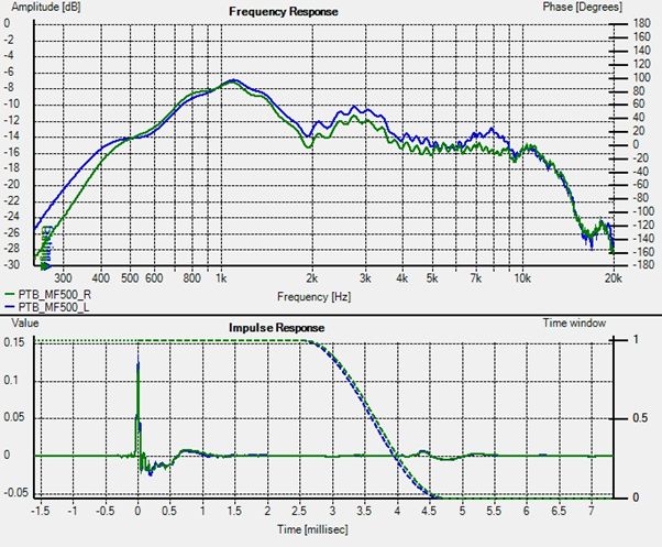

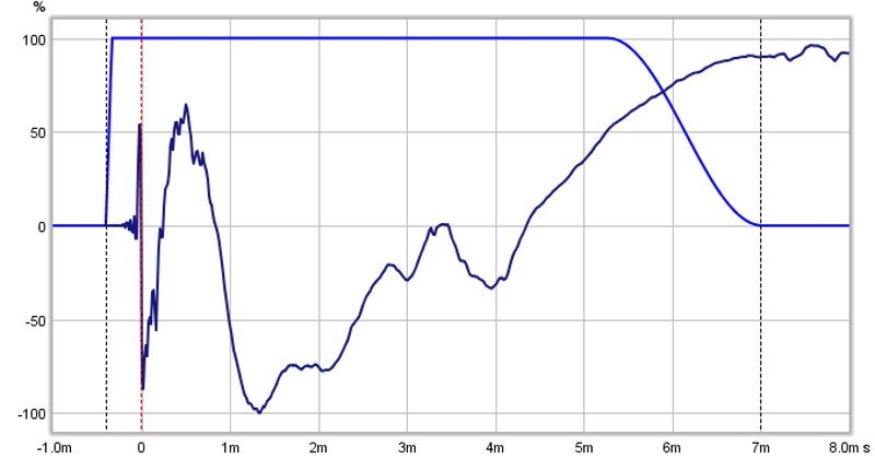

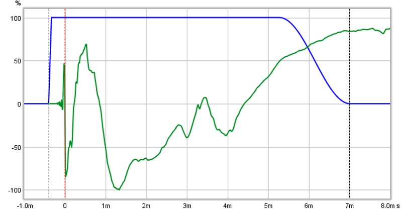

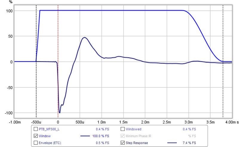

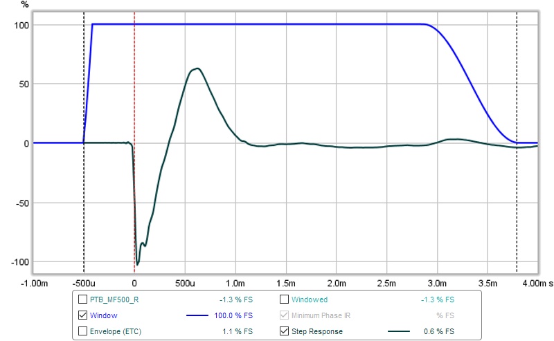

More recently, after researching the test methods, I tested a pair of MF500 drivers in their diy box. Each box contains a MF500 and a tweeter and is narrower at the top (5” wide) than the bottom (12” wide) with an overall height of about 13”. During testing they were located on and flush with the front of a diy woofer box and were about 28” above the floor. I don’t know the history of these MF500 units. The mic was either 30”, 36” or 1m from the speaker. I think I decided to use 30” for future tests. I was experimenting with my testing hardware and the various software packages at the time of the MF500 tests and the FR results are shown below.
The first FR chart is from HOLMImpulse.
The second chart from REW
The third from SpeakerWorkshop
The various software packages show similar results. The output from the L driver is generally about 1.5-2db higher than the R driver in the higher and lower frequencies. This seems to be greater than the differences shown in your chart for the two individual pairs. My drivers have peaks at about 1kHz (similar to yours) & 3 kHz (yours are closer to 2kHz) and a dip at about 2kHz (yours are about 1.5kHz). I don’t know if the different testing conditions have influenced the results.

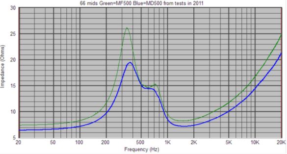

The next chart shows the impedance for the MF500 pair using SpeakerWorkshop. The DCR of the L speaker was 6.3R and the R 6.4R.
The next chart shows the impedance for the mids in the 66s.
The 66 mids DCRs are 7.3R for the MF500 and 6.3R for the MD500 so the 66 MF500 is 1R greater than the other mid units which are all about 6.3R. Others have posted the DCRs for their speakers earlier on in this thread.
I did some overall FRs of the 66’s and will take a look at those and post them later.

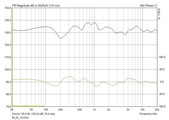

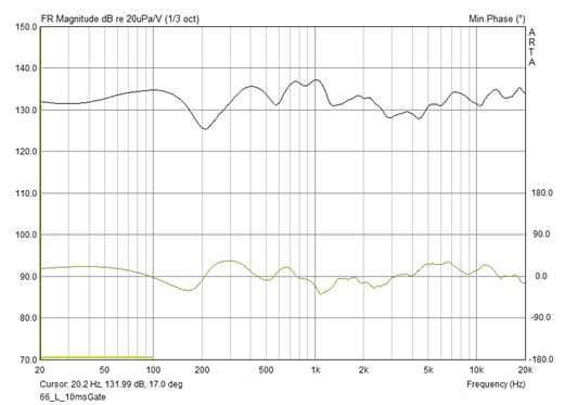

Celestion 66 FR tests
These charts are from tests on my 66s using ARTA software and 1/3 octave smoothed. Gate was 10,10.5 mS so good from about 100Hz. Mic distance was around 30-36" with the speakers on the floor with bubble foam on the floor between the speakers and the mic and as far from walls as possible. Used calibrated mic and amplifiers. Grills were removed.

Celestion 66 Step Response
ToTo Man posted a Step Response from his listening position for a Celestion 66 earlier in this thread and asked if the result was typical. Someone with experience in this area may be able to offer an opinion as I am completely new to it. Linkwitz Lab has an interesting discussion of speaker step response, including for 3-ways, at item F on this page: Frontiers
I've generated the Step Responses using REW for the FR tests on my 66s I posted earlier today. The first two charts show the response over 8ms as per ToTo Man's chart. My tests were done with the mic about 1m from the speaker.
Not much difference between these two but different from the one posted by ToTo Man. Different testing methods perhaps.

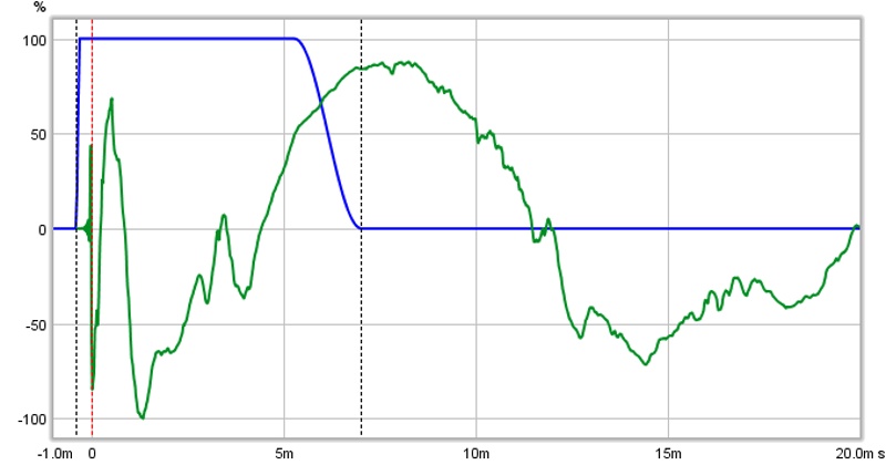

To get the full picture of the woofer response as shown in the 3-way in the Linkwitz article I expanded the X axis to 20ms. These are shown below
