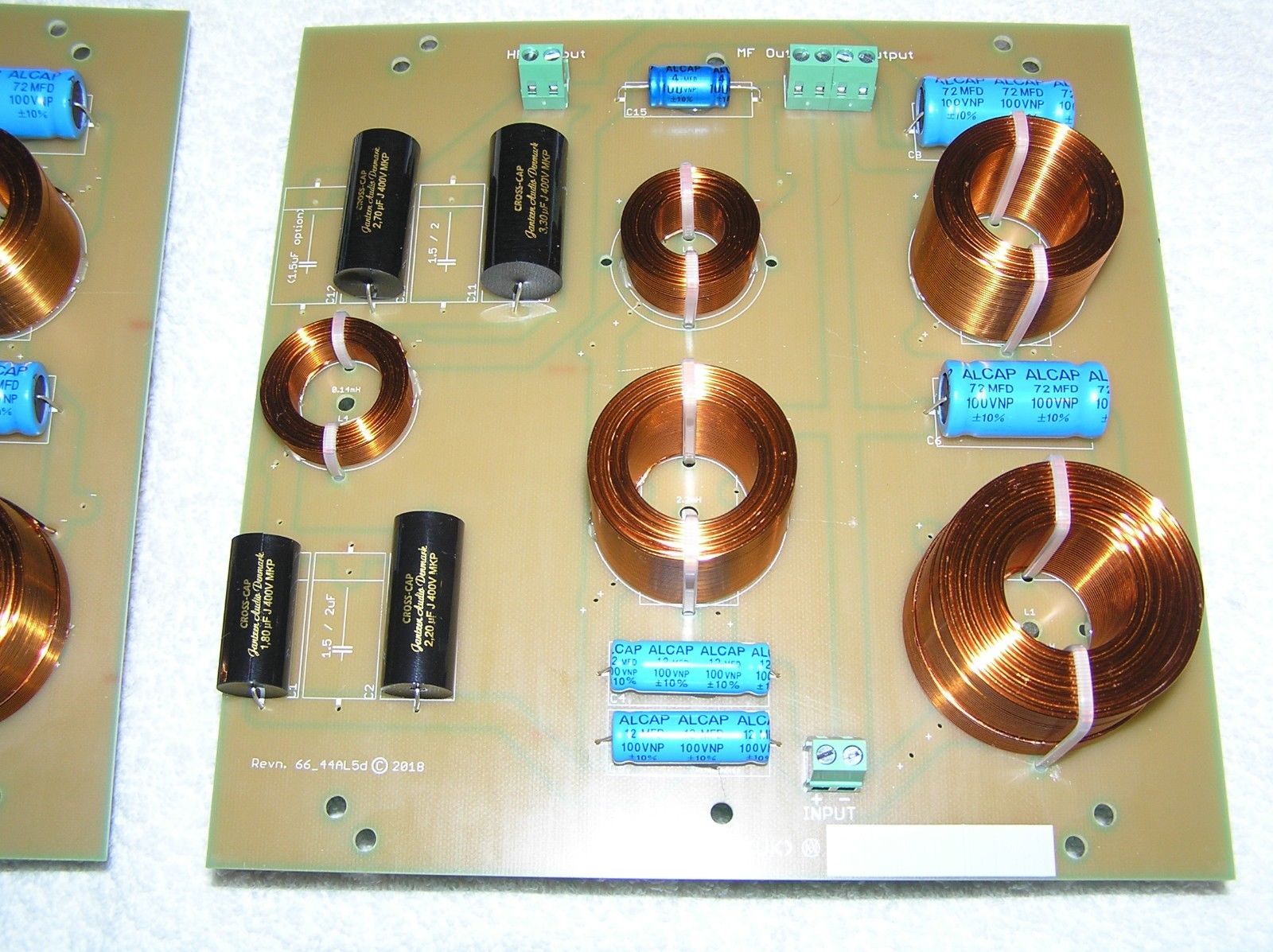

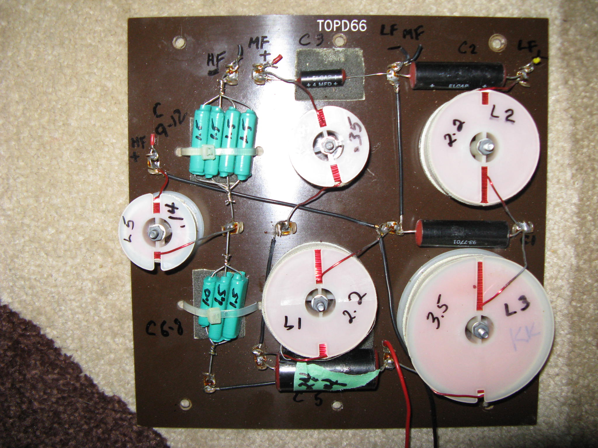

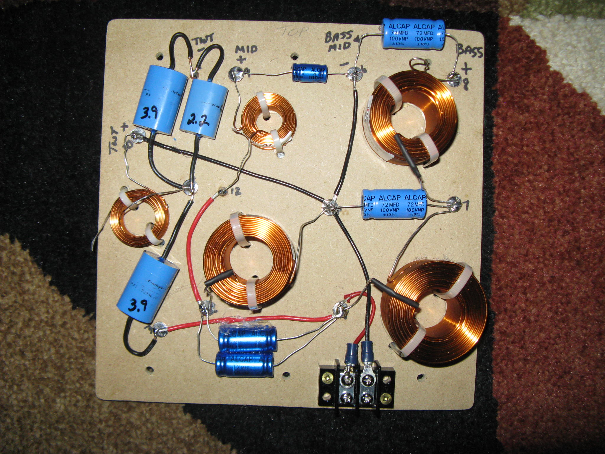

I'm trying to understand why many folk choose to add a small value 'bypass' capacitor in parallel with the main large value capacitor/s in a loudspeaker crossover. One rationale seems to be that the bypass capacitor improves the discharge rate and transient response, which appears to be at odds with what you wrote in post #1241. See for example Capacitors in parallel | Audiokarma Home Audio Stereo Discussion Forums. I note that the discussion on that thread centres around the use of film caps as bypass caps, do these perform differently to poly caps (such as the Ansar SuperSound I've used) in terms of causing transient pulse errors?
Also, can you please explain why the HF section of the 66 crossover is made up of two (groups of) caps in series? Is it to create extra resistance to attenuate the HF output, or is this just how 3rd order crossover filters are constructed?

Allan: new caps went into my homemade DIY xovers. Didnt want to *lose* the originals. Also have a set from France (Amocom) They make upper freq more pronounced. ( I think).
Pics of all 3 sets included.
Coils are Jantzen: 3.5mH,1.1ohm, 18awg
2.2mH, .84ohm, 18awg
.35mH , .4ohm, 20awg
.15mH, .23ohm, 20awg
Eloctrlytics are Alcap, rest are Clarity.
Should be done building in a day or 2, so not tested yet.
Also cot a new voice coil from France for my spare MD500, not installed yet

OK , you have two somewhat different new crossovers ,
thus after you have done some time of listening to each of them please Post here about the differences you found you could hear between each of them ,
because that could be interesting , and useful to readers of this thread.

I'm interested to hear your thoughts on how your three crossovers compare?
hearing test of my 3 crossovers:
test apparatus - 2 pair 70 yr old ears
New British built vs my new DIYers: neither of us could hear any appreciable differences
British built vs originals: bass on the new seems a bit behind the mid & upper. ie the upper freq's are much crisper & more prominent than the bass. bass on the originals appears to be a bit more prominent than the upper freq's. Perhaps all due to the new caps. I cant be sure if one sounded more prominent than the other when units were new in 1977, & prob didnt care when 27 yrs old.
think I could listen to all 3 different sets with no trouble.
left spkr had new British xover, while right spkr had xovers switched out, so side by side comparison, in left & right mono, alternating left-right spkrs.
sure would be *easy* if xovers had spade terminals for driver wires, vs clips holding everything together.
