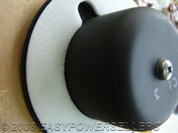

I just found the original sales brochure from 1979 in mint unwrinkled condition!

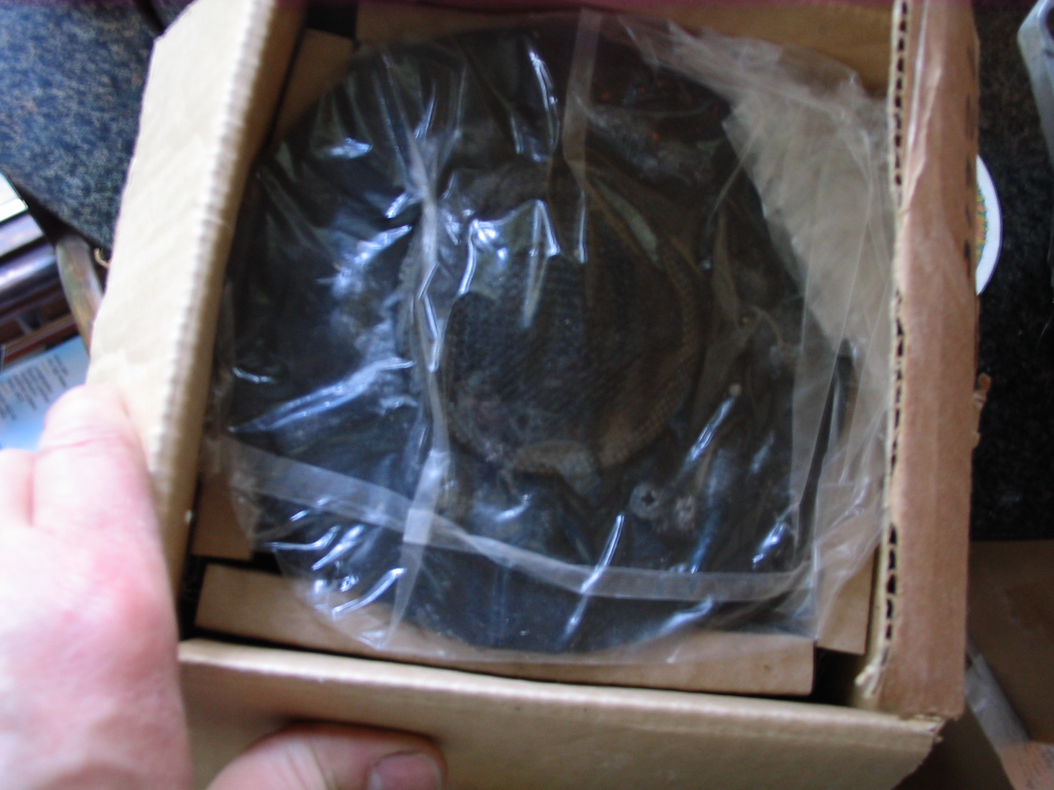

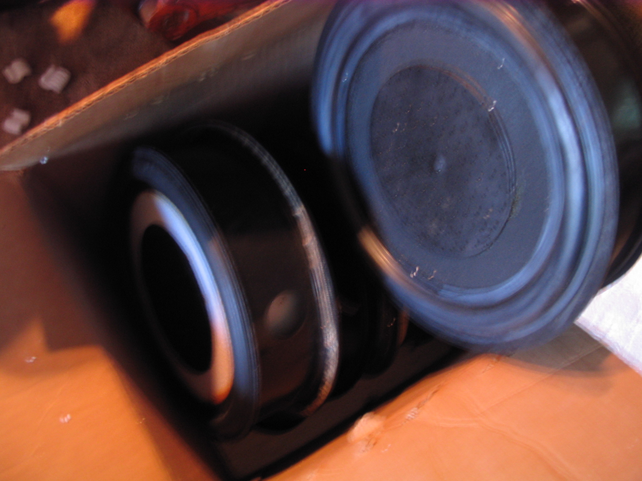

I still have 2 complete sets of drivers and crossovers sets in factory shipped/sealed boxes!! I opened them up and could swear i heard the sounds of The Wrecking Crew working on something in the studio, slowly drifting up from the boxes, heh. Not sure but the tune may have been "If i could only teach the world to sing"

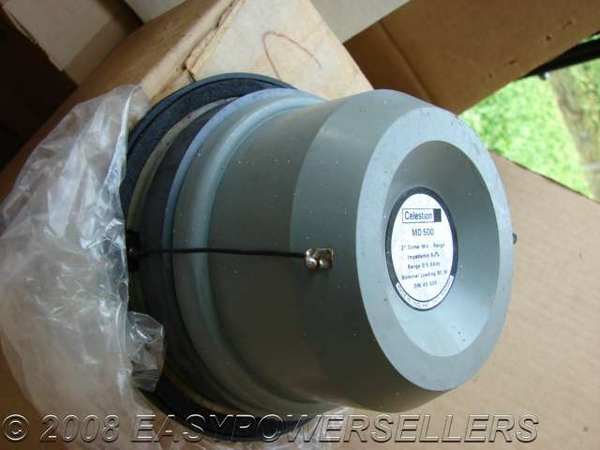

Hi everyone!
I've read as much as I could on this thread but still don't quite know if there is an answer to my question in here. I Bought a pair of early 66's (serial numbers 7114 and 7115, the woofers are light brown/beige). Both tweeters were toasted and both md500's lost their membranes (black). I started by replacing both membrane/coil assemblies of the tweeters and mids (parts bought from ninomusic here in France). I tested the speakers at very low volume because I expected the caps in the crossover to be bad. There was sound although not great. I went ahead and redid all the wiring with some good quality (nothing too fancy) cables, changed the poor quality terminals and changed the caps on the crossover (wooden panel with binding posts, no circuit). I had the 4µF, and two 72µF black alcaps, a 24µF red electrolytic with a 6µF alcap in parallel and the two stacks of paralleled light blue (ceramic ??) caps. Both 72µF read over 120µF and other Alcaps were way off as well. I changed all the electrolytics in the mid and bass range with modern Elcaps from falcon acoustics (as suggested I replaced the 30µF with a 24µF cap) and replaced the two values for the tweeter with SOLEN 1% MKP caps.
The result was quite amazing at low volumes although bass could be neater (I still have to install spikes because they are directly on a tile flour that isn't very flat so that might still improve). When pushing the volume a bit I heard that at some frequencies the md500 were making a very unpleasant sound (I could qualify it as distortion but don't know if that is he right word). It sounds like it's vibrating against something. Both speakers have it but not at the same frequencies and not in the same amount. I connected my signal generator to my amp and went through all frequencies, it seems to be the worst at 600Hz and 1kHz.
Test the mid-domes - then repair or replace the mid-domes.
Hi Depaj ,
(1)- disconnect the two mid-domes from the crossover and test both with your sweep generator with no crossover components in the circuit.
If the buzz frequencies are still there, then you will have to take the domes out of their chassis and look for small particles that could have got between the Voice-coil and the inside of the magnet's circular gap. That gap needs to be completely empty and clean.
Alternately, the voice-coils may not be correctly centered in the circular gaps.
If the voice-coil touches the sides of the magnet it will buzz , and eventually the insulation will wear off the wire of the coil, and then the driver will not work.
It is difficult and requires a lot of skill to correctly place a mid-dome -{ or a tweeter dome )- in a magnet gap in exact center so it will not touch the sides of the magnet inside.
(2)- if the mid-domes work with no buzz when out of the cross-over , then the buzz will likely be a mechanical fault caused by something loose in the crossover - look at the Inductors - are they all securely fixed in place ? or is one or more loose enough to vibrate when the volume is increased ?
Look at the capacitors that you replaced - are they all fixed securely in place ? or is one or more loose enough to vibrate against something when the volume is increased ?
Mechanical vibration can convert to electrical signal and buzz through a driver , because mechanical vibration of a Current carrying component causes a vibrating Field which is induced into the nearby inductors and then conducted into the driver.
Similarly, mechanical vibration inside a faulty manufactured Capacitor modulates the electrostatic field within the capacitor and that becomes Signal to the driver at the vibration frequency.
Those new Falcon "Alcap" electrolytic capacitors could have manufacturing defects , as they are not precision manufactured.
If you want to use the Falcon Alcap capacitors then buy the "Low Loss" type and NOT the smaller size "Standard" type and NOT the "High Power" type , because the "Low Loss" type is better manufactured.
Also, the Low Loss type will give closer to the original 66 sound than the Standard type -{ The "High Power" is a higher power version of the "Standard" }.
(3)- If you find the fault is in the mid-domes , and if you cannot repair them , then try Morel EM-1308 mid-domes as replacement , but before you spend money on those , first decide whether you can get the Bass of the 66s to sound how you like.
(4)- EM-1308 will work with the Celestion crossover, but likely will require a 27 ohm resistor is Parallel with the MD-1308 to match its Impedance to the crossover. Use a 10 watt resistor.
(5)- The original capacitors in the tweeter circuit of the crossover were not Ceramic, they were Polyester, but new MKP will work better unless you like the sound of Polyester capacitors.

Hello Alan and thank you for you detailed answer.
Some time has passed since I posted this message and I was too eager to get the speakers working that I continued investigating myself.
I got the MD500 back out, tested them between 500Hz and 5kHz and had the same buzz with the same frequencies. I removed the top assembly with membrane and voice coil, checked the gaps but they were perfectly clean. Also the coil seemed perfectly centred (no noise when I gently push down on them.
Looking closer though I noticed that the cork gaskets that are on both sides of the suspensions weren't perfectly level (probably from removing the old suspensions and glue). I'm now trying to find new gaskets but that doesn't appear to be that simple. I might have to cut them out myself but don't really know what material to go for. If you have any suggestions...
I'm trying to keep them as original as possible so replacing with a different mid driver is definitely not an option.
I already replaced the caps with the high power Alcaps because they don't have the 72µF version of the low loss. They aren't that expensive so I might order a new set of the values they do have. I used solen MKP 2% for the tweeter section.
Hello Depaj ,
If I am understanding correctly you have tested the MD-500 outside the crossover , that is testing the driver directly , and found the buzz resonances are still there , thus they are not faults from the crossover.
Try to open the cup - back-cover of the MD-500 - and look in there to see if anything loose that can vibrate or buzz , because there is sound going back into that back-cover cup.
Also , look at where the wire terminals are connected to that back-cover cup , as there may be something loose there.
Gaskets can be cut from Cork or from Rubber.
Find an old rubber inner-tube for inside a vehicle tyre , and make gaskets from that.
Also , flat sheets of Cork bonded with Rubber can be bought from some Automobile parts shops for making gaskets for sealing cases around motor parts.
You can cut gasket sizes from those.
The 72uF caps are not likely the problem , because if they were faulty the sound would be through the woofer.
Yes for Falcon Alcap I see there are only the HP High Power series for 72uF ,
and I see that Falcon no longer have any 24uF or 25uF in the Low Loss.
In Low Loss I see 4uF 100 volt for the MD-500 - select the +/- 5% Tolerance and pay the small extra money , so that you receive closer to the correct capacitance.
Instead of using 24uF , connect two of 12uF in Parallel to make the 24uF.
Buy four of the Low Loss 100 volt 12uF in +/- 5% Tolerance , or in +/- 2% Tolerance for better matching.
Regards , Alan ,

Hi Alan,
Yes I tested the drivers out of the cabinet, hookep up directly to a small amp with the frequency generator sweeping from 500Hz to 5kHz and the buzz is still there at exactly the same frequencies. The buzz seems to really come directly from the speaker diaphragm so I don't think there is anything vibrating in the cup. When lifting ever so slightly the whole assembly out of the gap on one side the buzzing goes away. I really think the gasket is to blame here. Is there a way to open up the cup on the back without damaging anything just to be sure ?
I removed the gasket already so I will have to replace it anyway. I found a place where I can buy sheet of nitrile cork seal. I will cut out a new gasket, try again on one of them and see what happens.
I'll probably keep the capacitor upgrade for later, the crossover works as it is (tweeter and woofer sound great and even the mid at low volume).
Well, I would never have doubted the replacement kits I bought but I guess I should have. Both voice coils were partially disconnected from the rest of the assembly so as soon as the volume was pushed a little they started vibrating in all directions. I glued them back on, used my newly cut cork gaskets and they sound good again. I hope this won't be happening again too soon.
Thank you Alan for your help and advice 🙂
Always check things !
Hi Depaj ,
Good, your careful investigation found the problem !
I always check new things, because manufacturing assembly defects can occur, and obviously did for the two you bought.
If the buzz has completely gone, then it is better not to take off the back cups, because that will break those seals, and then you will have to re-seal them.
Your new rubber + cork for gaskets should be very good seal and low vibration around the front.
For the Alcaps:
I always find whenever I listen through loudspeakers with electrolytic capacitors in their crossovers that have not been used for several months or longer the sound is slightly fuzzy for several sessions until the electro caps reform their internals.
When no signal is through an electrolytic capacitor its electrodes deteriorate. Alternating signal current through will reform the electrodes slowly if they have not deteriorated too much , and after a few sessions the sound becomes clearer.
Very old electro caps usually do not reform , and those leak electrically quite a lot , and that causes Bass and Low-midrange signal to damage Tweeters and Mid-domes with Series connected capacitors , and causes amplifier output stages to fail when there are Parallel connected capacitors in the crossover , such as the 4uF and 72uF pair in the Celestion 66.
All electrolytic capacitors leak electrically, even new formed ones. How much they leak depends on the materials they are made from, and their assembly.
I think the Low Loss Alcaps type will last longer with less permanent leak than the Standard Alcaps , but for serious listening I do not use any type of electrolytic capacitor in a crossover , because I do not want to hear capacitor sound , however as you can find in this thread there are listeners who like electrolytic capacitor sound.
Regards ,
