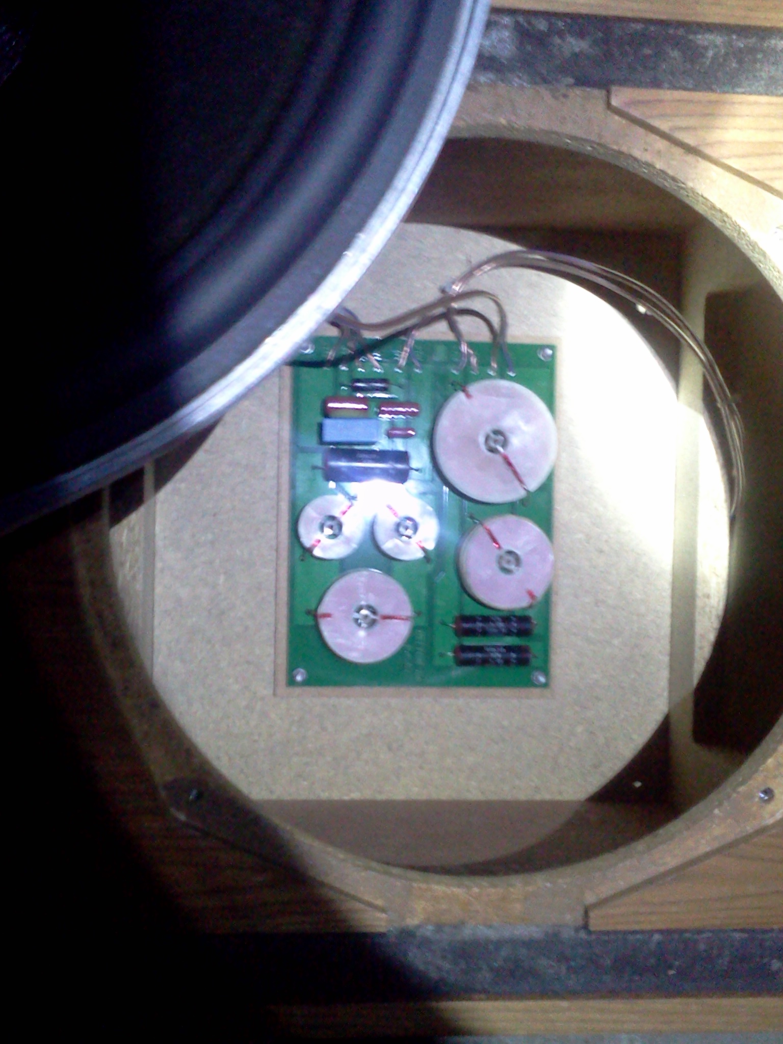

The parts have been fitted to the new boards and then located in the bottom chamber, behind the ABR unit.
Burning everything in now before any critical listening.
I ended up with a mixture for the 30uf series cap of about 7.5% Ansar Supersound PP & the remainder using a pair of Visaton LL electrolytics, so thats the bundle of three in the lower right corner.
Hey Ken,
Wow that looks good. Far better than my cardboard crossovers, haha. I really need to get them onto more proper boards.
I'm excited to hear about your findings with the new boards, I am sure you will find the separation of the inductors to be a positive improvement to the sound.

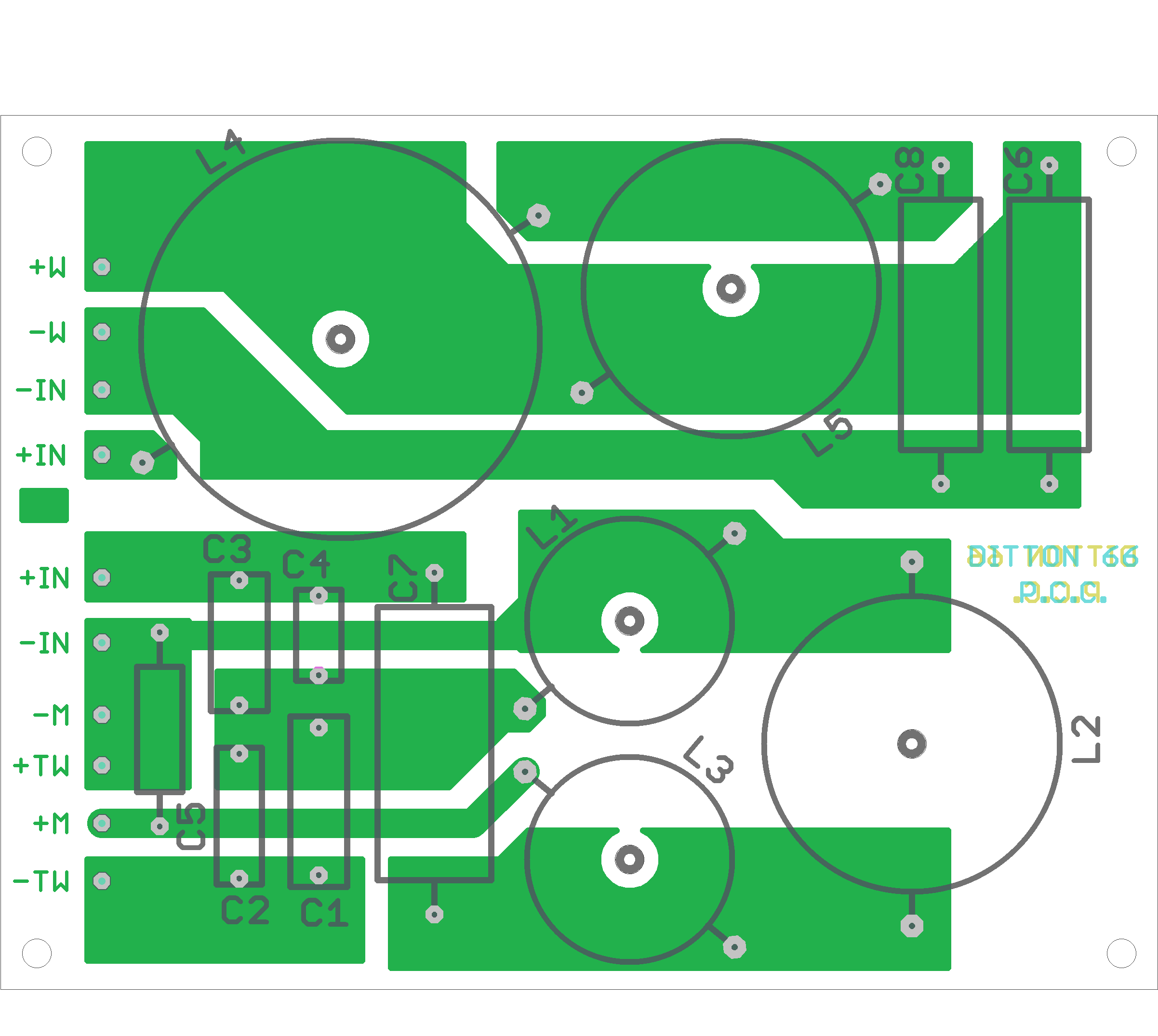

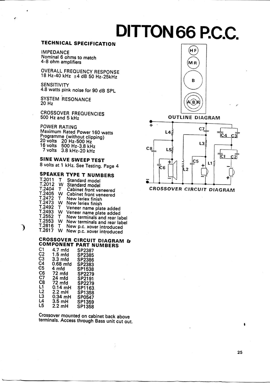

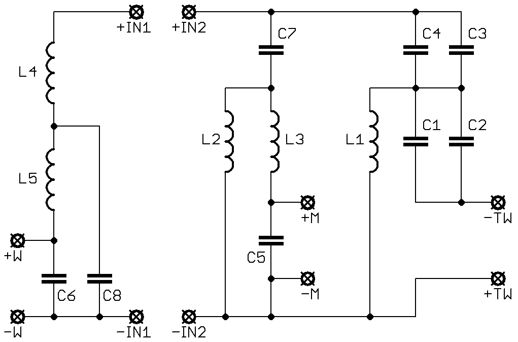

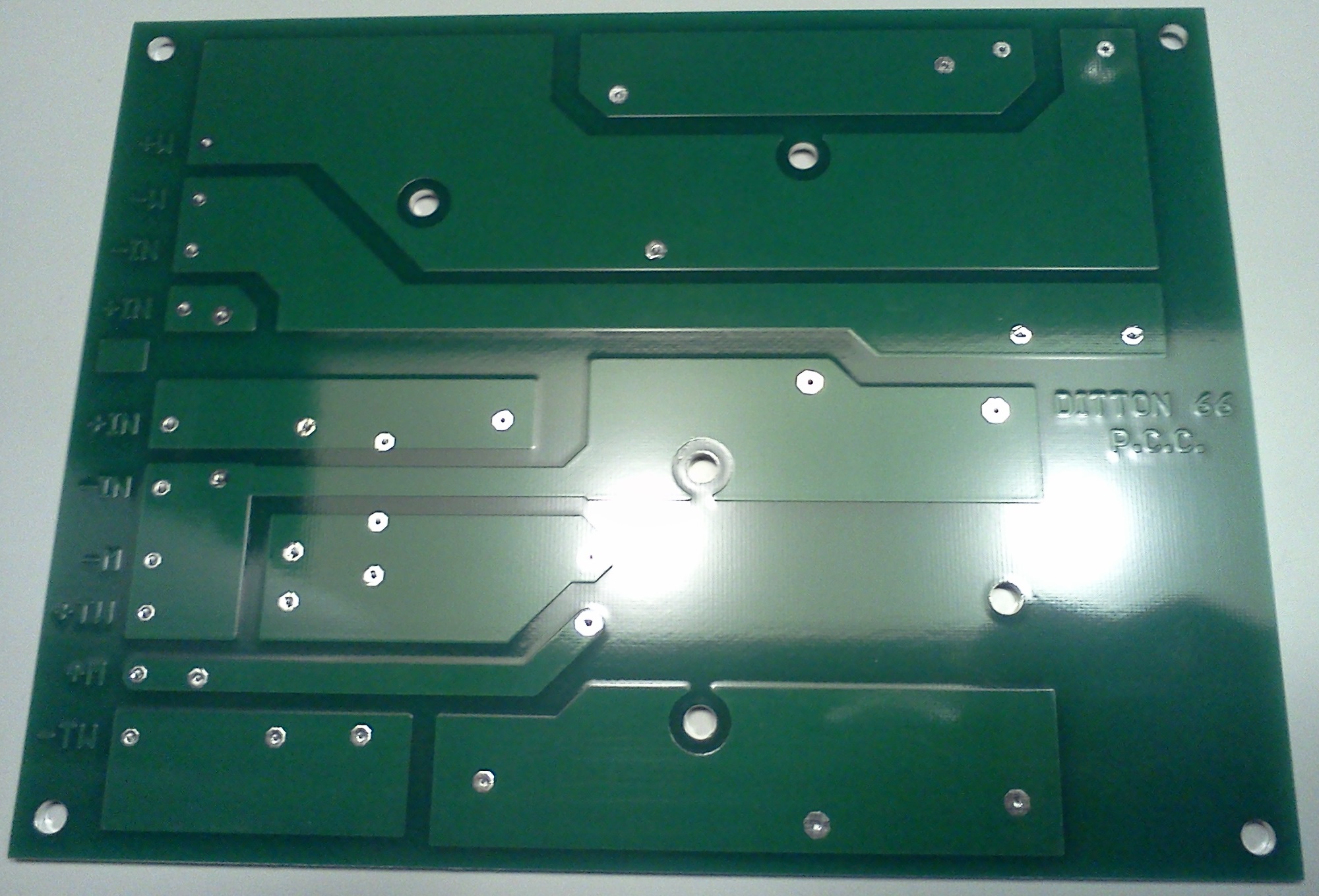

I redesigned the Celestion 66 Xover PCBs (PCC version) to allow Bi-Amp'd configuration. The PCBs are extra thick (94 mils) and use the original inductors and caps. Connections are 18GA solder pads for an improvement over the old wiring harness that relied on point contacts and thin wires. I have eight blank Xover PCBs remaining for $35 each plus shipping. Reply to m.malherbe@att.net if interested. Or I am glad to E-mail the Eagle layout files if you want to order your own.
Redesigned Celestion 66 crossover.
Attached picture of PCB.
To accompany new PCB I used:
Bi-Amp Speaker Terminal Cup Gold Insulated Binding Post, Part # 260-246 from Parts Express and replaced the brown ceramic caps.

mikemb - Re your PCB layout, the position of your coils is far from optimum and bound to lead to interaction between them.

Nigel pearson - A change in inductance on closely positioned coils is only one part of the equation, Troels has some good info on coil orientation on his site and shows his measeurments, for anyone interested it is linked here: Placement of coils in crossover networks
Noise or degraded signal due to electro magnetic interference is also a variable to consider.
The coils on the 66 are mounted only a couple of inches from the bass drivers large magnet, and as you rightly say, is as much of a concern. I reorientad the coils and placed the cross over in the lower compartment. There was an improvement, but I will admit it was very small compared to getting the caps right, tri wiring made a more noticeable change for instance.
