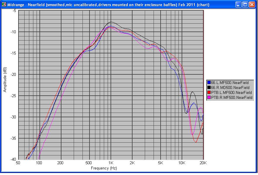

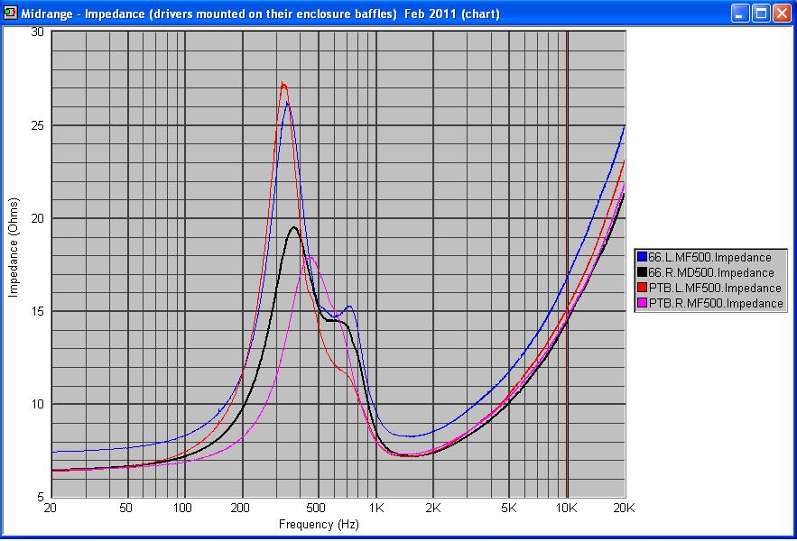

MIDS IMPEDANCE AND NEARFIELD
Hi Alan,
Following on from the previous post of the DCR’s I’ve measured the impedances and nearfields of the mid drivers as shown in the charts below.
The nearfield measurements were done in two runs at different sound levels to check the repeatability of the test method. Results showed the same trends for the individual drivers for both runs so repeatability was considered acceptable. Only one run is shown here.
For the record, the tests were done using Speaker Workshop, calibrated jig and an un-calibrated mic (ECM8000+MIC100). Nearfields were done at a mic distance of about ½ inch with the individual drivers on their normal enclosure baffle ie the 66 mids on the 66 baffle and the PTB mids on their small triangular baffle and sitting on top of and flush with the front of the PTB woofer enclosure.
I’ve also measured the Impedance of the complete speakers and will post these later.
