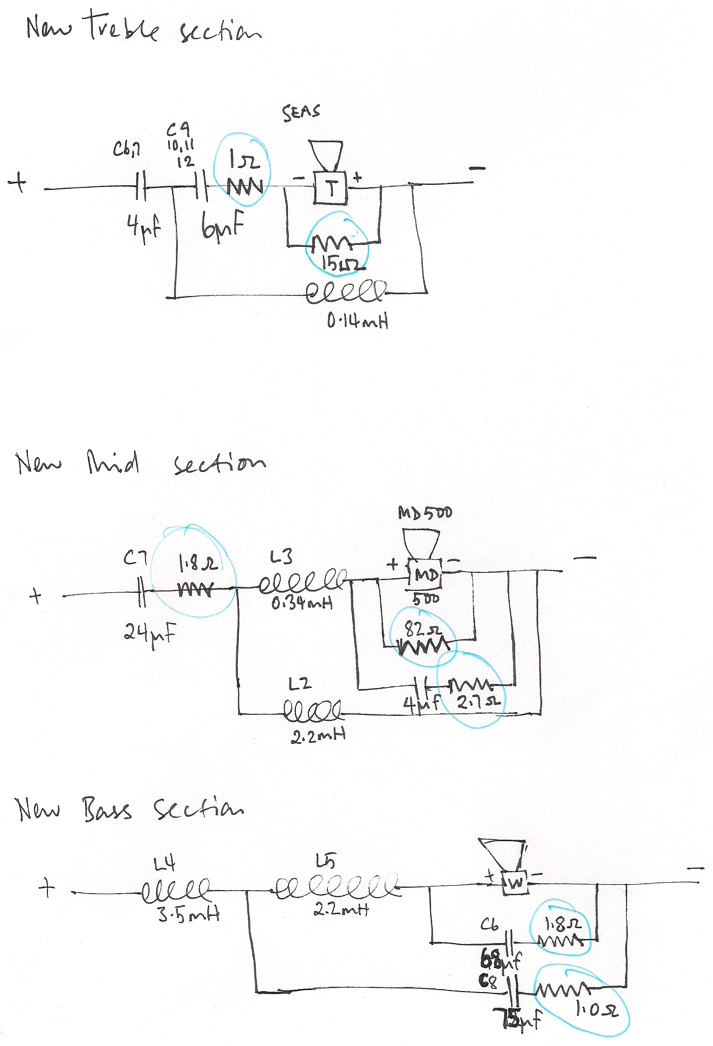

Hi Alan
I have been following this thread for some time and though it about time that I got on with things. I have a pair of 66s and would like to change the tweeters and upgrade the capacitors. As discussed in the thread I intend to go with the SEAS 19TFF 1 tweeter replacement and to use the Solen 250v PA capacitors, including the use of a 25uf in the mid and the 68uf/75uf combination in the bass sections.
I would very much appreciate you having a look over resistor placement in the attached diagram. I have tried to follow the advice re the ESR compensation resistors and the 82R across the MD500s in the mid-section in the thread and would just like to check whether this is pretty much current thinking, or not.
I would be very interested in hearing from others who have completed these upgrades for views the resulting sound quality compared to the originals.
Thanks in advance
Jim
Thanks in advance
Jim
Jim: My xovers were *designed* by Alan for my decreased hearing of hi freq. I am good now with what I have. The 82r in the mids might not be required for you. the originals had no r in this position.
Having looked at your schematic brings me to ask Alan a question- maybe important, I dont know. DOES IT MATTER IF A R IN SERIES WITH A CAP IS BEFORE OR AFTER THE CAP? Mine are all before, whereas I see Jim has his after. Any difference?
Doug(moermusic)
Doug(moermusic)

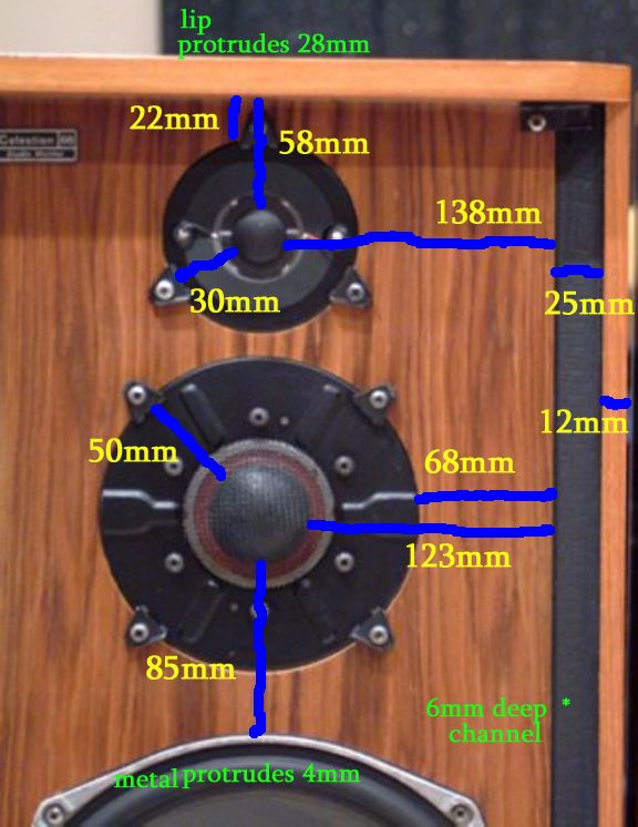

Measure this please
Before I post at length about making measurements of driver frequency response with the drivers mounted in the 66 cabinet,
please will WayneSwann, or DennyG, or anyone else interested,
measure the distance from UNDER the top lip of the 66 enclosure to:
(1) - the outer edge of the tweeter mounting flange,
(2) - the inner edge of the tweeter flange but NOT overlapping the suspension/surround material around the diameter of the tweeter's dome,
in mm, or, inches' + fractions, and post here.
Hi jt954,
I will reply to your post next, and as soon as I have time available.
I see one error in your schematic.
Hi Doug,
I'm pleased that the treble and upper mids are now to your liking !
Your resistors are correctly placed - I will comment more about circuit placement when I reply to jt954.

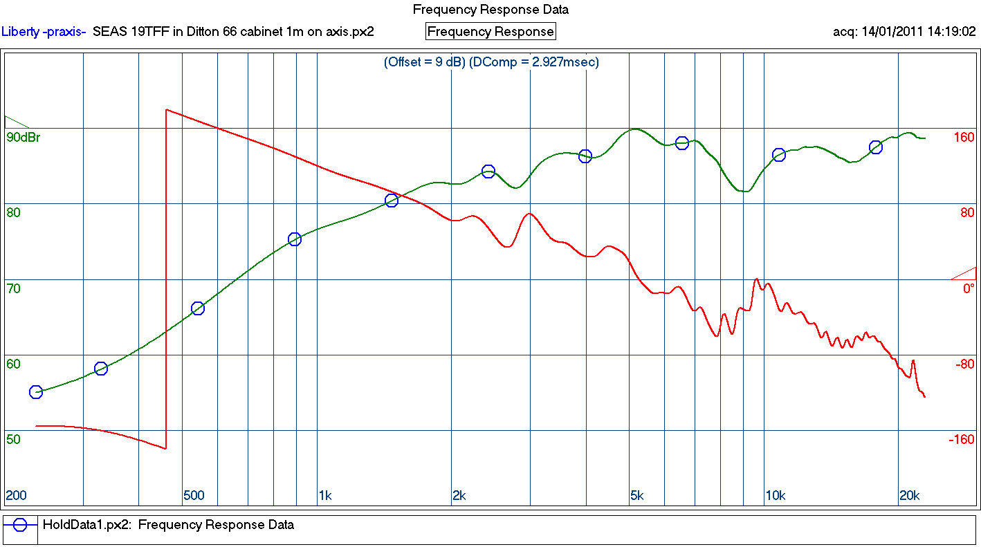

Hi sba,
thankyou indeed for posting with all those measurements
- various of those will be useful over time here.
Did you apply any treatment under that top protrusion before you made your measurements ?
Reflections from it will be too short in time to Gate out without losing necessary detail of lower treble frequencies,
and similarly for reflections from the mid-domes.
Reflections will come from the side-channels also, and will be noticeable, but not of the same magnitude as from the top-lip.
The 4mm protrusion of the woofer chassis will cause some interfence with mids' measurements,
but not as much as the top lip overhang and side-channels,
because the woofer flange is curved, thus most will reflect off-axis to the microphone.
Yes, there will be reflections off each of the domes of signal from the other dome,
but those will be small, and will be part of what you will be hearing when you play music,
thus we may as well see the effects of those in the plots.
It is useful to see only those, and not the other reflections, when considering modifications to the crosovers.
Wayne and DennyG, check to see your cabinets have the same overhang as sba's, as each of you have different models,
though likely the overhang will be the same on all, and also the side-channels, etc ...
I have to go now, but I'll return to this as soon as I have time available.

Hi sba,

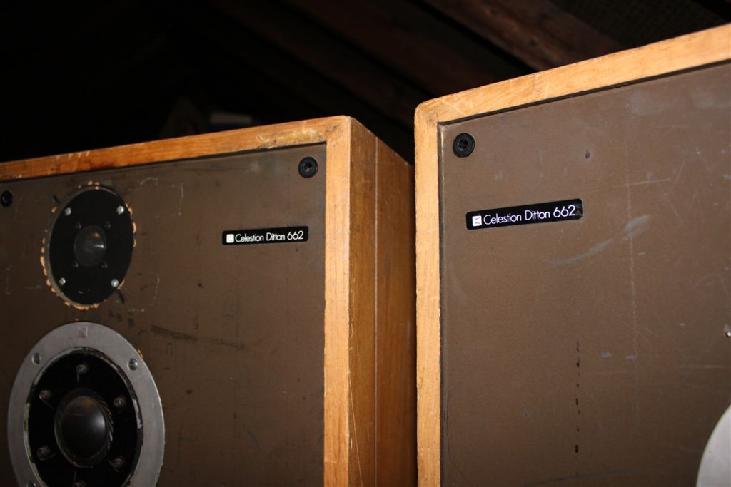

Baffle
Hi Alan,
I agree, and it's likely that some of the problems on the baffle are masking some of the finer electrical trims being made to the crossover.
From this (ebay) photo it looks like Celestion made some improvements on the later 662 model--
I probably wont have time to experiment until this summer, but here's some modifications that I have in mind:
* cut off the top lip
* overlay a new partial baffle for just the mid & tweeter
(3/4" baltic birch, with rounded or tapered edges)
* offset the mid & tweeter
* drill some mounting holes into the flanges of the mid & tweeter
* cut down the existing metal grille to cover just the woofer & a.b.r.
A little ambitious, eh?
It would look something like this--

jt954's schematic and tweeter section capacitors
Hi jt954, DennyG, sba,
I see several things to follow-up on, though with limited time available to day I'll likely only get one addressed, thus to start with the first request, which is jt954's:-
With regard to your posted schematic:
The "New Bass Section" is fine.
The "New Mid Section" is fine, though you may not need the 82R.
I advise you to listen initially with those not installed.
The 82R does three things:-
(1) - reduces Impedance magnitude of driver Fs to allow smoother low mids' crossover, and slightly less distortion caused by excess driver excursion.
The need for this varies with samples of MF and MD domes, and with some samples lower than 82R may be needed.
(2) - reduces mid-band Impedance minimum a little, which is useful if your samples are higher there than the average, and if each is different there, then a different value of resistance can be used with each to achieve a closer match between the drivers.
NOTE, I recommended to sba to apply 82R to one of his MDs only, to try to get its response closer to his other MD in both the above matters.
(3) - reduces Impedance a little in the upper mids' crossover region, which allows the .34mH inductor to drop a bit more of the upper mids if those are audibly too prominent, and from sba's plots it seems this may be more the case for the MD model domes than for the MF model domes.
NOTE, moermusic has tried this and reported some audible result.
Thus, I recommend you listen carefully for the above phenomena AFTER the new caps and other resistors are in the circuit.
Post here if anything seems audibly peculiar.
Do buy the 82R if you have to buy via Mail-order so that you have them, and resistors are not expensive,
BUT first, measure the DC resistance of each mid-dome and Post here before you order.
If each is significantly different in DCR, I may recommend a different value resistor for parallel connection to each dome.
The "New Treble Section" is not correct for the SEAS 19TFF tweeter.
I think you may have missed some posts of mine about changes to the treble section to adapt to other tweeters.
Basically, the old treble filter is suitable for the typical dome tweeter of that era which had a high Q Fs, and thus high Impedance peak at its Fs and greater output in the frequency band around and a little above the Fs region than further up the frequency spectrum.
The only current tweeter which is like those old ones, and which can be adapted to fit easily in the 66 is the Coles 4001 ... it needs only a resistor connected in parallel, and then will work with the capacitors and inductor values of the original circuit.
For the SEAS 19TFF the components will have to be changed or there will be loss of output about an octave wide centred on the crossover frequency.
By using a suitably calculated parallel resistor ONE only of the original parts can be retained, thus I calculated for the .14mH inductor, because that component does not deteriorate with age, thus will still be working well.
For the capacitors, for smoothest response through the crossover region and basically flat treble response the capacitors will need to be about 3.6uF and about 11uF.
You can use 3.9uF and 10uF, which moermusic has, but that will cause an increase in treble output a little above the 5kHz, and not as flat response above that as the alternate.
I recommended this to moermusic because of his hearing loss of upper treble,
however if you have no great loss of upper treble hearing I recommend the 3.6uF and 11uF option.
These can be made with a parallel pair of 1.8uF, and parallel pair of 5.6uF for brands with no 3.6 and 11.
Sonic Craft's Sonicap Gen I has both 3.6 and 11uF.
Some other brands have 3.6uF and 5.6uF.
You have not included a Flag with your name, thus I do not know which country you are buying from to recommend brands to buy easily,
thus where are you ?
For resistors in the treble, 1R and 15R will give similar treble level to the original, but that is slightly lower in output than the midrange output.
(see the original Celestion brochure posted by ...{ I forget who, but possibly DennyG} recently, and you will see the frequency response plot included.)
Do you want slightly reduced treble, like the original, or not quite as less, or not less but closer to midrange level ?

Alan
I am based in the UK and think for simplicity I will stick with the Jantzen cross caps. Looks like they will need doubling up - 2x1.8uf=3.6uf and 2x5.6=11.2uf.
I guess that I would be looking for the 'not quite as less' option and see how it goes. If you could let me know the alternative resistances for your 'original' and the 'not less but closer to the midrange' options that would be helpful and I can try those depending on the initial sounding.
Thanks for your help.
Jim
Jim

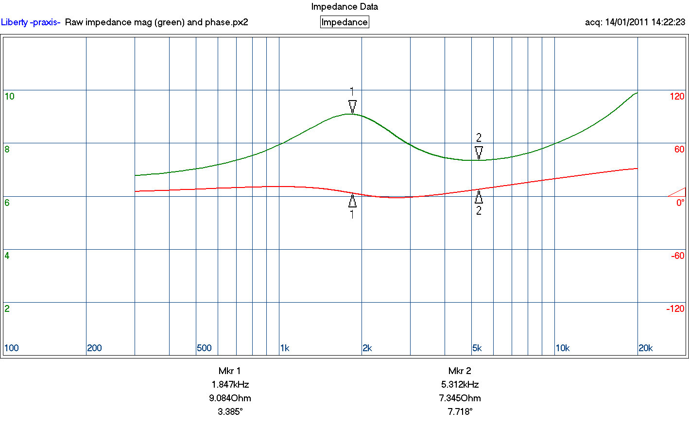

Finally, 2 plots from John
Hi Alan, I hope you are well.
I have received the attached 2 plots from John, after a bit more prompting it has to be said! The email text read:
'Hi Wayne,
The plots you asked for are attached - As the original files were lost I have repeated these measurements today

SEAS plots
Hi Wayne,
good, and now you have something useful to work with.
The Frequency Response Data has evidence of why he put that C9+L6+R1 network in Parallel with the tweeter.
See that small peak centred at about 5.15kHz, and notice that its bandwidth is skewed to include wider band above 5.15 than below 5.15.
The C.L.R network is tuned to 5.57kHz, thus it seems intended to reduce the small plateau between 4.6kHz <--> 7kHz.
However, there is no plateau of that magnitude on SEAS's own plot,
AND there is not that dip at 9kHz, nor even the smaller dip at about 2.7kHz on SEAS's plot.
SEAS are more reliable with their plots than most manufacturers, and when their drivers have significant annomolies such are visible on their plots.
I think these anomolies are caused by reflections from the 66's cabinet front, and are result of addition and subtraction of the particular wavelengths that correspond to the annomoly frequencies.
He did previously measure at least one tweeter and one mid-dome in an actual 66 cabinet, thus he has the reflections data for that cabinet in his computer.
That data can be applied to any tweeter and mid-dome located in the same positions on the 66 baffle.
I think it most likely he has done that with the new sample of the SEAS tweeter which likely he measured nearfield {as he did with your MDs}
and then used a computer program to expand that to simulate a 1 metre on-axis plot, and added the cabinet effect to that.
Yes, some computer programs can do all that.
However, the peak at 5k15 is NOT direct sound - it is partially delayed sound.
Notching out part of the peak does NOT only reduce the delayed sound - it reduces both the direct and the delayed.
This is a crude technique that is used for Public Address systems in live performance venues - it is not high-fidelity.
To get clear sound through the bandwidth of that reflections additive plateau, AND to not get the notch-out at 9kHz,
the reflections have to be reduced.
That can be done to sufficient degree with treatment of the top of cabinet over-hang,
and additional treatment in those vertical side-channels if you listen with the grilles off.

The Impedance plot is almost identical to SEAS' own, differing only in the location of the Fs,
and that will self-correct after the tweeter has been played for a while.

Hi Wayne,
All that will improve the MDs' performance also.
