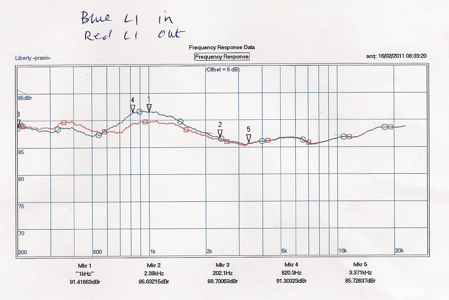

Hi Alan
I have the new crossovers as suggested in #741etc installed and have had the frequency response checked. There is a rise of 4dB from 500Hz to 800Hz and the it falls from 1.2kHz by 7dB (to -4dB) at 3.5kHz and then rises by 2dB from 4kHz to 8kHz and then rises again by another 2dB from 12kHz to 18kHz.
Removing the 2.2mH inductor in the mid section reduced the rise from 500Hz to 800Hz to 2dB but the response continued to fall from around 1.5kHz through to the same dip to -4dB at 3.5kHz. (In some ways similar to Wayne Swan's curve in #755)
Could you suggest some solution to this to flatten the curve by lowering the low mids and bring up the upper mids?

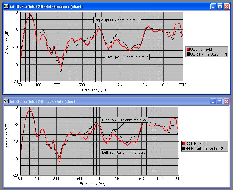

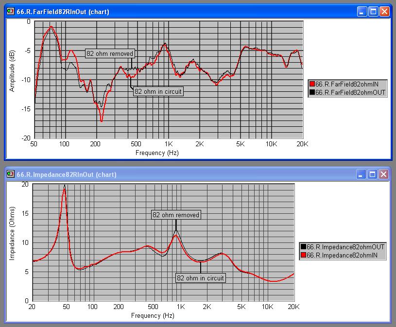

Farfield & impedance after removing 82R from RH spkr
Continuing on from my last post (#799).
I took some farfield and impedance measurements of the 66’s both before and after I removed the 82 ohm resistor from across the midrange on the right hand speaker with the MD500.
As mentioned in my previous post the R speaker appeared louder than the L speaker with the 82R in the R speaker mids circuit and removing the 82R appeared to improve the overall balance between L&R speakers. However, I can’t really see why I observed this as the farfield results shown here don’t seem to provide a reason for it. Could it be because the farfields were taken with the speakers in the middle of a different room and well away from any furniture and the listening tests were done with the speakers in their normal room position? Could it be because the farfield results below 500Hz are more closely matched after the 82R was removed? Have I missed something? Alan where are you?
The first picture shows the before and after results for the right hand speaker for farfield and impedance.
The second picture compares the farfield results for both L and R speakers before the 82R was removed (top trace) and the farfield results for the L and R speakers after the 82R was removed from the R speaker (bottom trace).
Hi Alan
I have posted the crossover layout and the frequency response, both with and without the 2.2mH coil in the mid section which shows a flatter response without the coil. I hope that this indicates the issues as currently laid out. Can you suggest a change to flatten the response (less lower mid and more upper mid).
Jim

Hi Jim,
reconnect the 2.2mH inductors in the mid-sections of your crossovers or the mid-domes will be damaged as result of their suspensions being overdriven at frequencies they were not designed to handle !
First Order electrical High-Pass -{the 24uF cap}- cannot protect mid-dome drivers from over-excursion.
I think there is a mistake in your microphone/SPL measurements.
Does what you HEAR from the speakers when playing music correlate with your SPL measurements ?

Hi Jim,

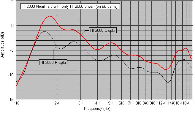

HF2000 NearField and impedance
Hi Alan,
Here are the HF2000 Nearfield results with the drivers located on the 66 baffle. When I did these tests (during the Sonicap upgrade) I didn’t repeat them as I normally do so am unsure of the repeatability. Repeatability is normally pretty good but look at the second picture.

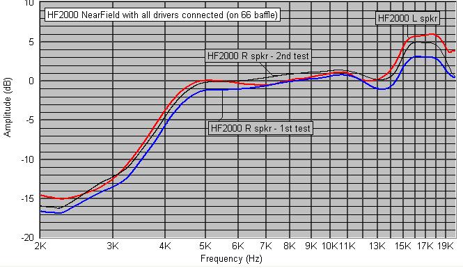

The next picture shows HF2000 Nearfield results with all drivers on the baffle and all drivers connected to the crossover and operating during the tests. I repeated the test for the R driver immediately after the initial test on that driver and the repeatability was not as good as I normally expect with my test setup. I can’t explain the 1 to 2 db difference for the R spkr for the two test runs.

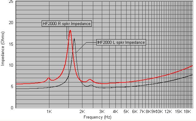

Next picture shows the impedance of the HF2000 drivers. The DCR of the L spkr was 4.3 ohm and the R spkr was 5.2 ohm.

Denny, check one of the Plots ... and hello Doug !
Hi Denny,
in the first and second plots you have used Red for Left and Black/Blue for Right,
BUT in the the third plot - Impedance - you have swapped colours between Left and Right - is that correct or an inadvertant mistake ?
I ask because from BOTH the SPL plots it seems that the Left tweeter would have the higher Impedance.
If such is the case, then closer to matched output can be got, but if your Impedance plot ID is correct, then I'll have to think a bit about this ...

Impedance plot is correct!
Hi Alan,
The plots are correct. I didn't notice the colour swap, it was the way the colours were assigned by the software as each data set was added.
I've tried out a different solid state integrated amp with the 66's and it has issues driving them. Sound is not quite right. Will go back to the old Suden for now.
