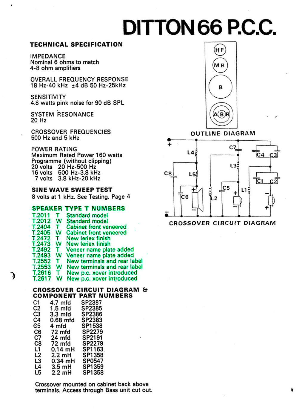

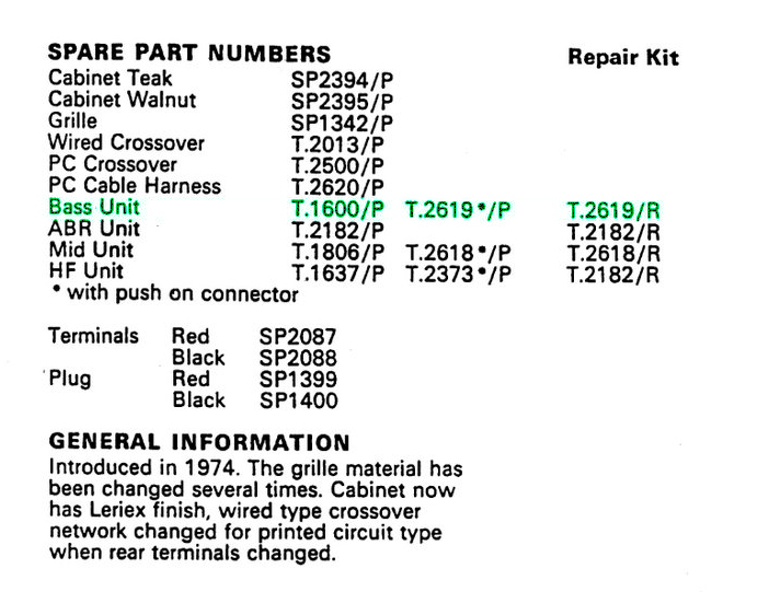

I'm not familiar with "MkII"... the only reference I could find for "MkII" pertains to the hf-1300 tweeter, which was not used in the 66s.
Here's a list of the 66 variations--
Both my standard (blackies) and front-veneered models came with the T1600 woofer. My T2619 woofer (with a larger dust cap) was purchased later as a spare. It looks like either can be used--
(I have no idea about the "UL12" thing, except that it appears on a very early brochure. I doubt that it's something other than a T1600 !)
For the final version, the 662, all three drivers were re-designed.

The 1600 woof was in version one of the 66's. Mine are 2619's. I also not sure about UL but will search it.

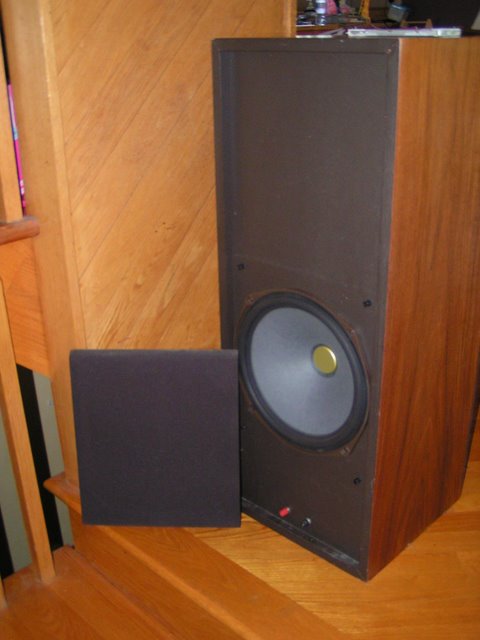

SBA Attachment is pic of 1980's Ditton 66 MK 2. ABR is on the back side.
My 66's were built in Sept/77

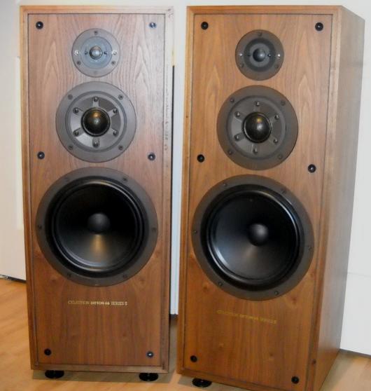

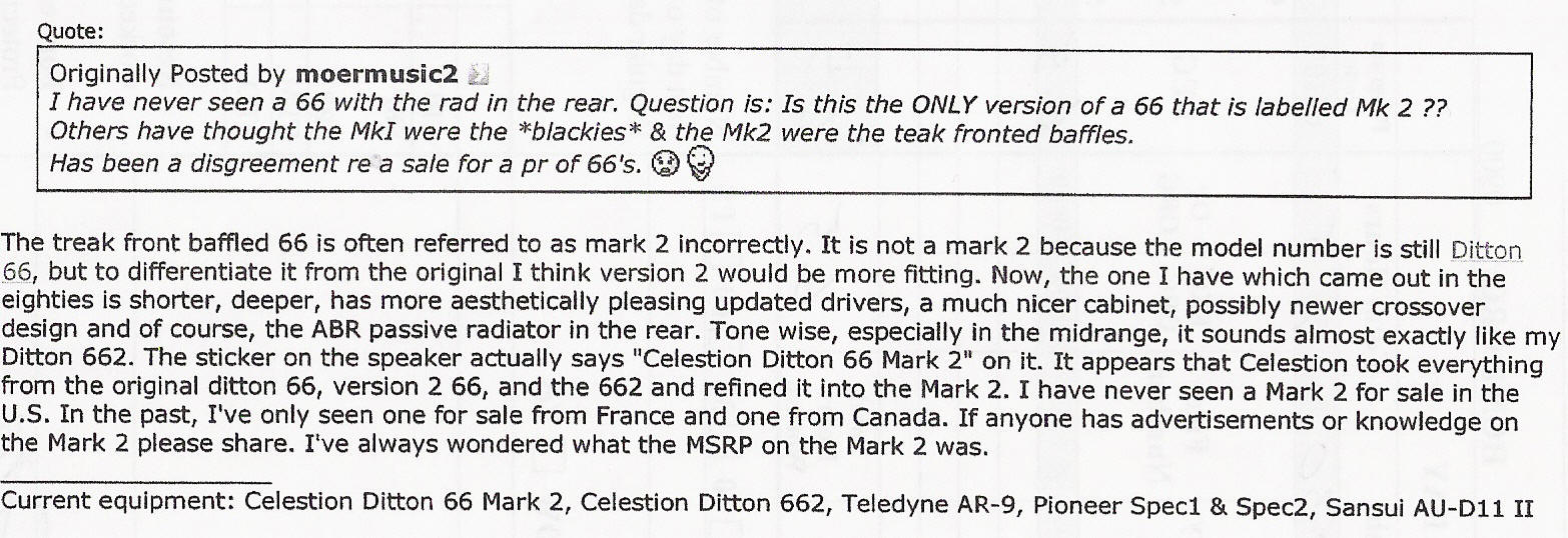

moermusic, thanks for the info. I hadn't seen the series II before, but that's hardly surprising since they're so scarce and there's no brochures, specs, or published reviews. So it's believed that this model was introduced in the early 80s and followed the 662 ! Interestingly, the series II's ABR looks like it was made using leftover woofer chassis from the original 66. Perhaps that nasty recession of the early 80s put an end to the series II before it could take off. But it might be otherwise! I'm sort of curious about the midrange sound. The MF/MD mids are well-damped soft domes. The 662 mid is a hard dome... and I don't know about the series II below.
re-issued Dittons, and the Mk I and II matter
Hi sba and Doug,
in the 1980s, and maybe even later, there were issues of at least 2, and perhaps more, Celestion models with "Ditton" on them.
One is that 66 Series II you have found.
It is, as you seem to realize, not a true 66, and seems to be a reduced size 662.
The other was labelled "Ditton 88". I have never seen one, but only a photo and I forget where I saw that.
The 88 was larger than the Series II 66, if I'm remembering correctly.
What I do remember is that both were available in a few countries only,
there simply to meet a specific market demand which was different to what most UK buyers were buying then.
The final actual "Ditton" labelled model issued in the UK, and likely World-wide, was the 332 ... somewhat smaller than the 442 and 551.
There was no 552, seemingly because there had never been a 55 model.
If any readers have these, then unless they have some of the original 66 drivers in them,
please start a new Thread if you want to re-condition them,
because this thread is now very long, so lets keep it for original 66s.
As for the Mk I and Mk II matter, this I think simply is how some owners describe the two basic versions which sba has,
and which RWTomkins posted the printed information about in #162 on Page 17 - the T.B.C. and P.C.C. versions,
and as sba and at least one other owner have posted about, there are two different crossover capacitor versions of the T.B.C.
tonedef2 refered then to them as Mk I and Mk II, but neither seem to be labelled as such by Celestion,
nor were the Ditton 44s of that era even though each had a different version of the midrange cone driver.
T.B.C. seems to mean Tag Board Connected.
P.C.C. seems to mean Printed Circuit Connected.
Thankyou for the reminder about the woofer number alternates sba !

SBA: good pics, I never did find one of the back side of the now *infamous* Mk2.
