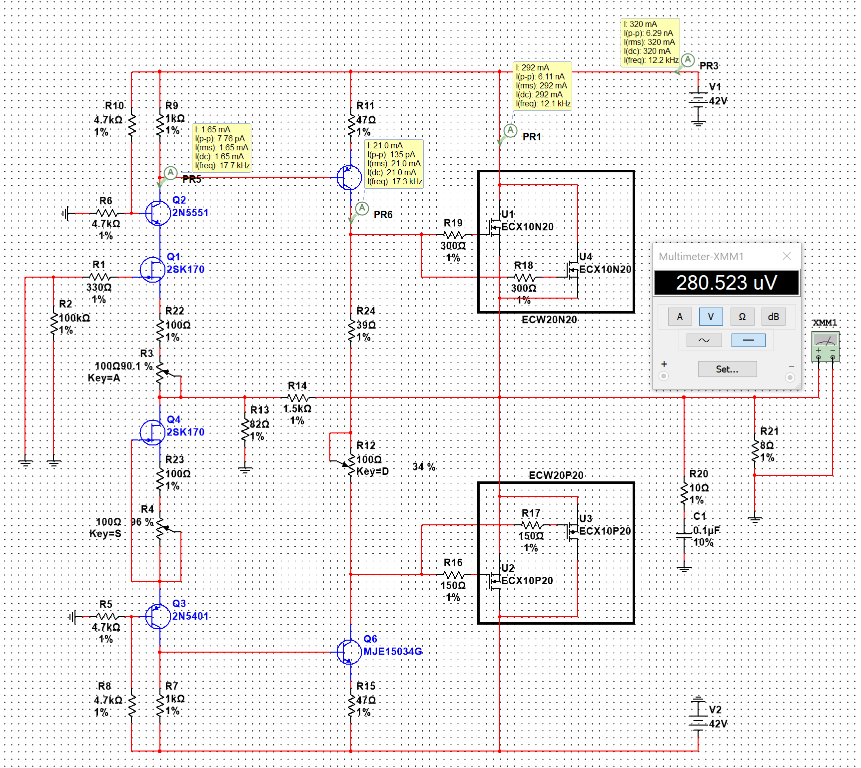

I was wondering whether I could raise idle current of the output transistors to, say 0,7A, in order to get into Class A operation, lowering the PS voltage. I really like this design of using two 2SK170 JFETs (I happen to have plenty of them, all genuine purchased back in the late 1990s), instead of the complementary pair with 2SJ74 (of which I have not as much). But I always preferred playing in Class A and, as I understand, the Cube operates in Class AB. Of course, I haven't listened to it to judge - just saying...
You can essentially take any fully complementary circuit and replace the 2SJ74 with a 2SK170, wired as constant current source.
This is the case here, but you can see the same in Wayne's line stage at the Pass forum.
You loose half the open loop gain (input stage no longer push pull).
So if nothing changes, distortion goes up by 6dB, mostly H2.
If you want to use a pair of K170s for Class A power amp, you should look at the many Kaneda designs on the net.
At least that's what I would do.

It's not a problem to push it into A class, I have a quiescent current trimmer on my PCB and the power supply is dimensioned that way, but the current heatsink does not allow experiments with higher currents.I was wondering whether I could raise idle current of the output transistors to, say 0,7A, in order to get into Class A operation, lowering the PS voltage. I really like this design of using two 2SK170 JFETs (I happen to have plenty of them, all genuine purchased back in the late 1990s), instead of the complementary pair with 2SJ74 (of which I have not as much). But I always preferred playing in Class A and, as I understand, the Cube operates in Class AB. Of course, I haven't listened to it to judge - just saying...

Nothing, but then we leave the operating points that JM imagined. There would certainly be some changes in the sound, you should try it, but this amplifier sounds good enough that it should not be pushed into the A class.what prevents us ti bias the cube in class A?

Dear grunf,
A couple of questions regarding this project.
From post #21:
As I understand, you have followed ZoltanChivay's circuitry shown in post #8. This has 2 trimmers:
R16 - DC regulation at the output
R15 - bias
In your implementations, I notice that you use 3 trimpots. I assume that the third is used to set the quiescent current, as you say that you have added that option. Forgive my ignorance, but doesn't the bias setting regulates the quiescent current? I'm a little confused here. Could you please show a schematic of the circuit that you actually built? I'm considering building this amp and I too would like to experiment with higher quiescent currents.
Thank you,
Evangelos
