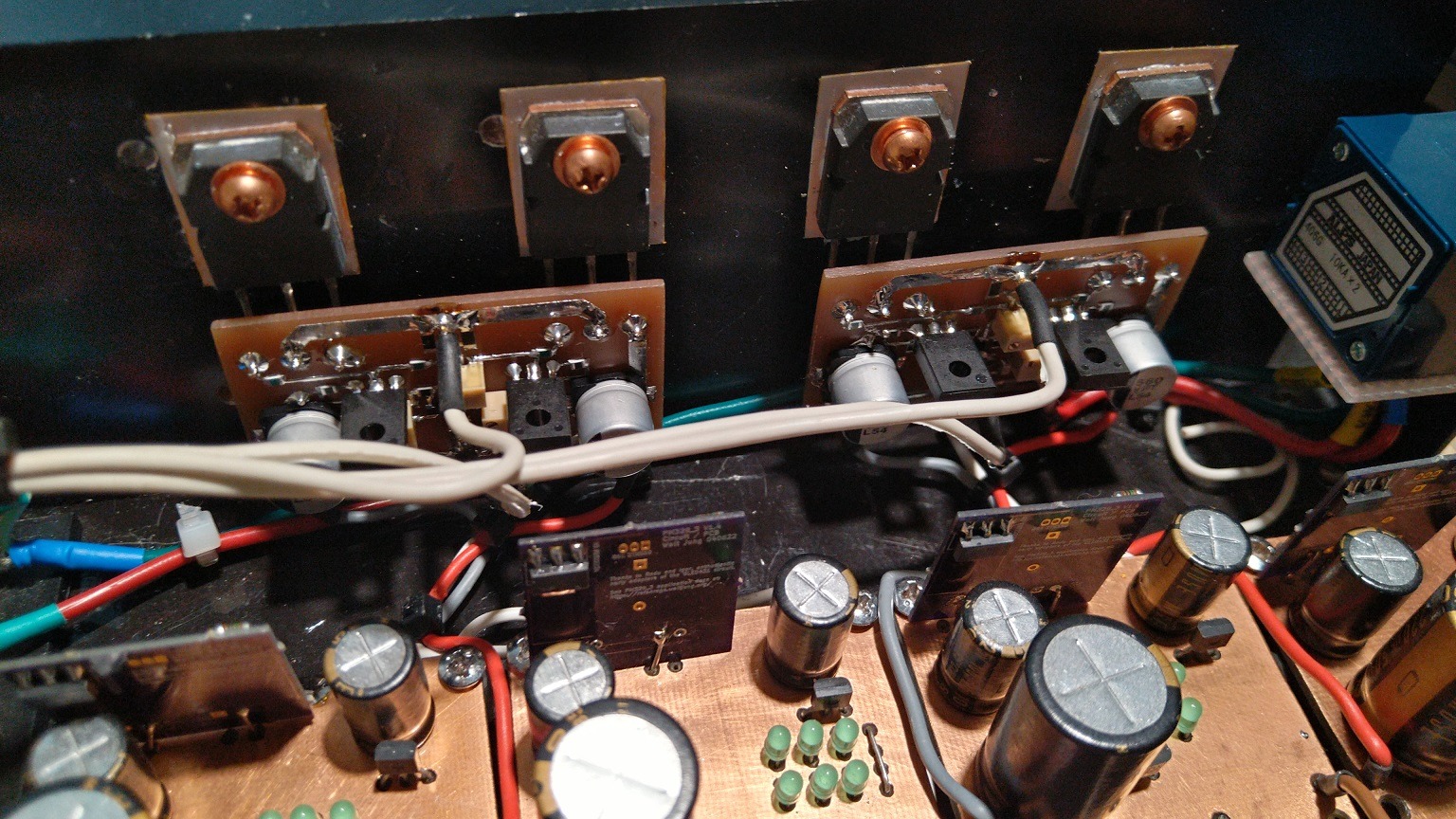

Count on some 3 - 4V voltage drop, which would roughly be 6-8W dissipation per regulator with 2A of current, for four regulators or stereo amplifier 36W max.
First this weekend I have to make a version with Dale tantalum resistors, then I will start drawing the schematic of the regulator 😉.

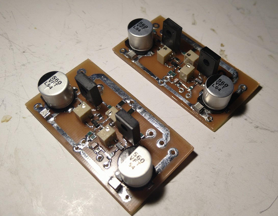

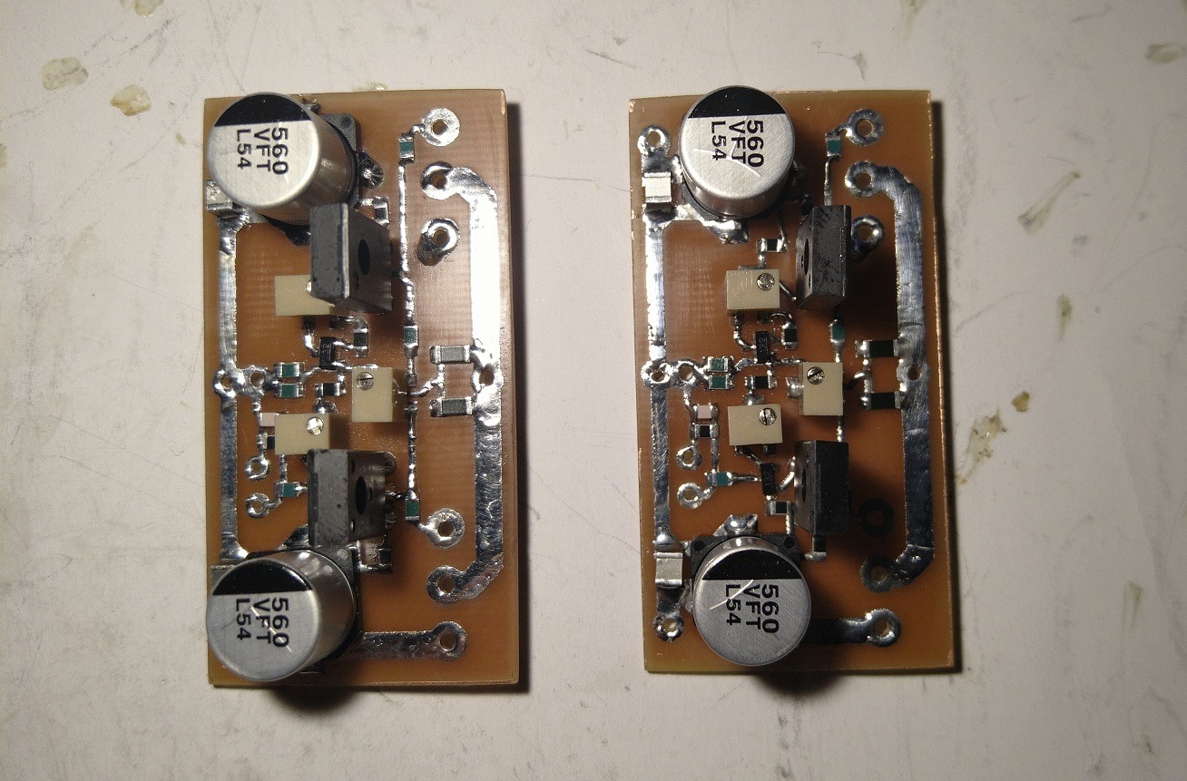

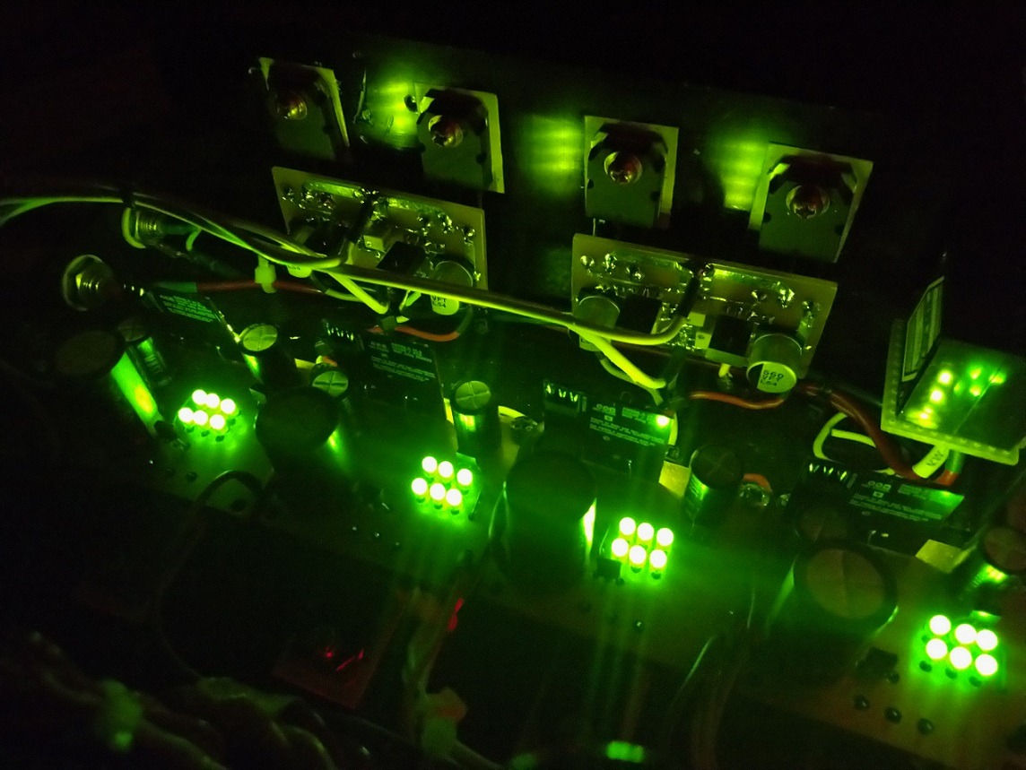

today I managed to make two small PCBs, 55x29mm and solder all the parts on them, tomorrow is the installation in the amplifier and setting the operating points

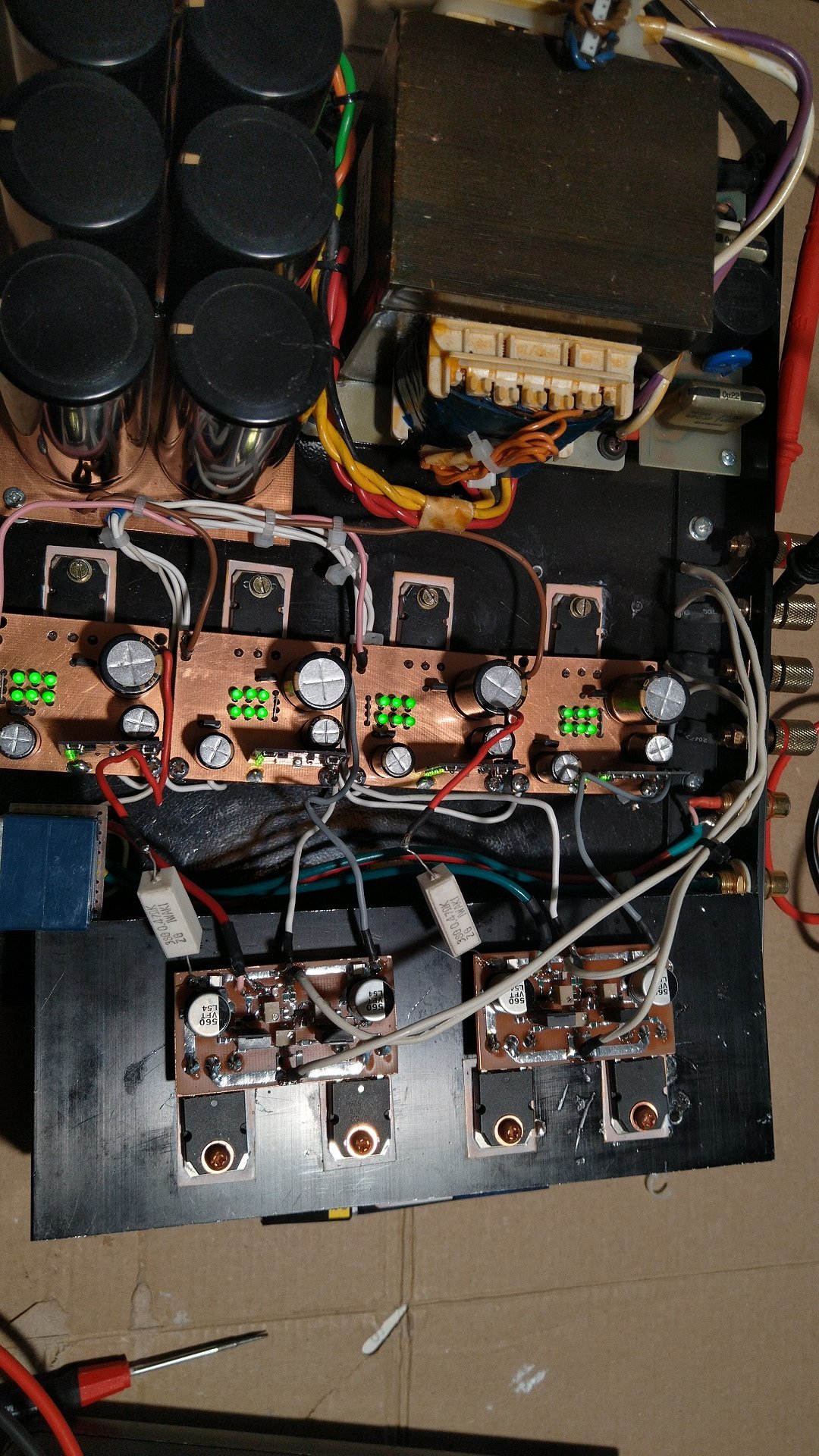

Yes, this morning, but because of Sunday's family lunch, I didn't listen until tonight. I must admit that I am delighted, you can really hear the difference between the MMA0204 and the PTN SMD resistor. Even my wife feels the difference in the sound, which is no small thing🙂.
From now on, I will definitely use tantalum resistors in the signal path or wherever excellent characteristics are important and it has an impact on the sound itself.
Here are some pictures.

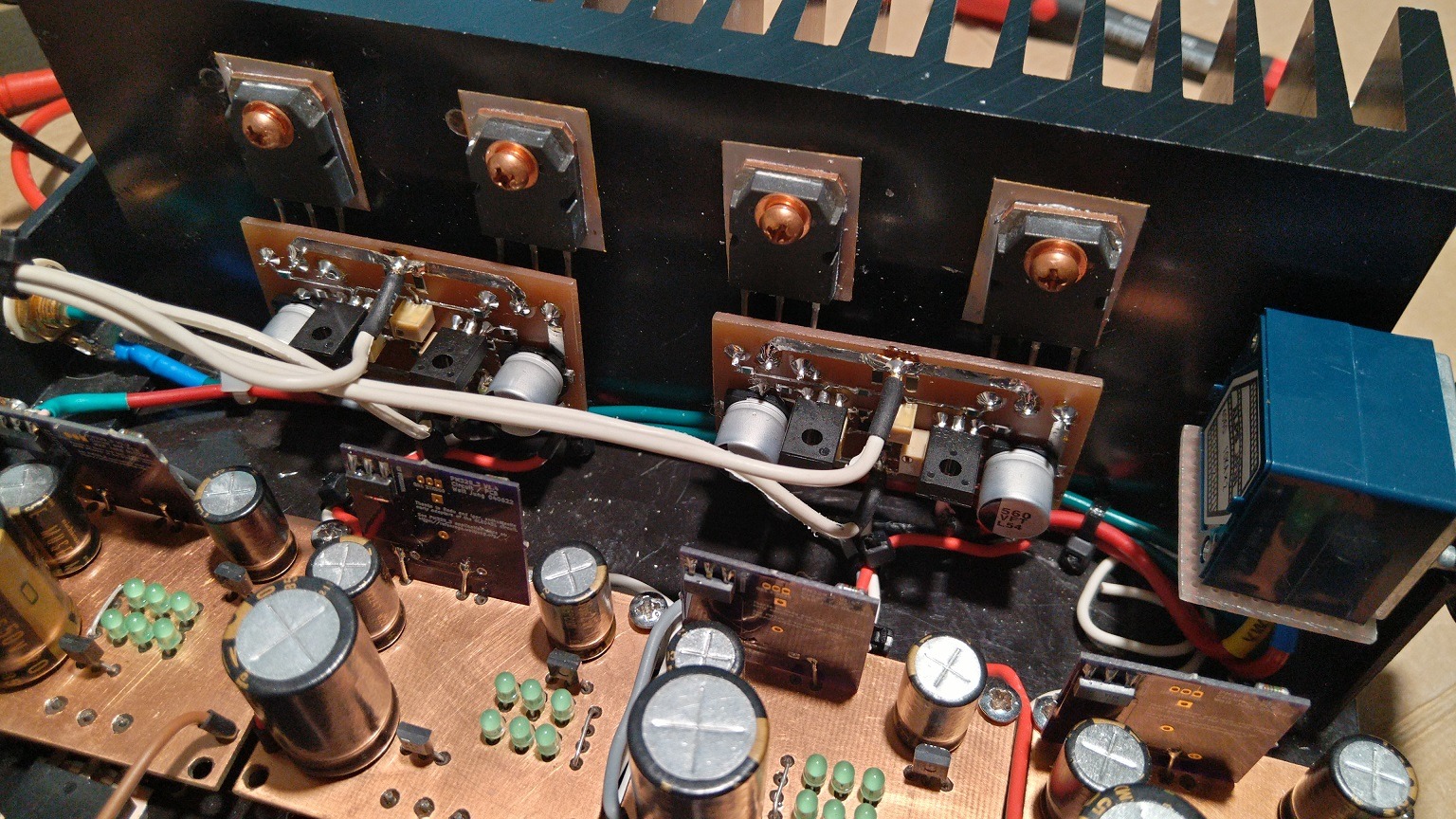

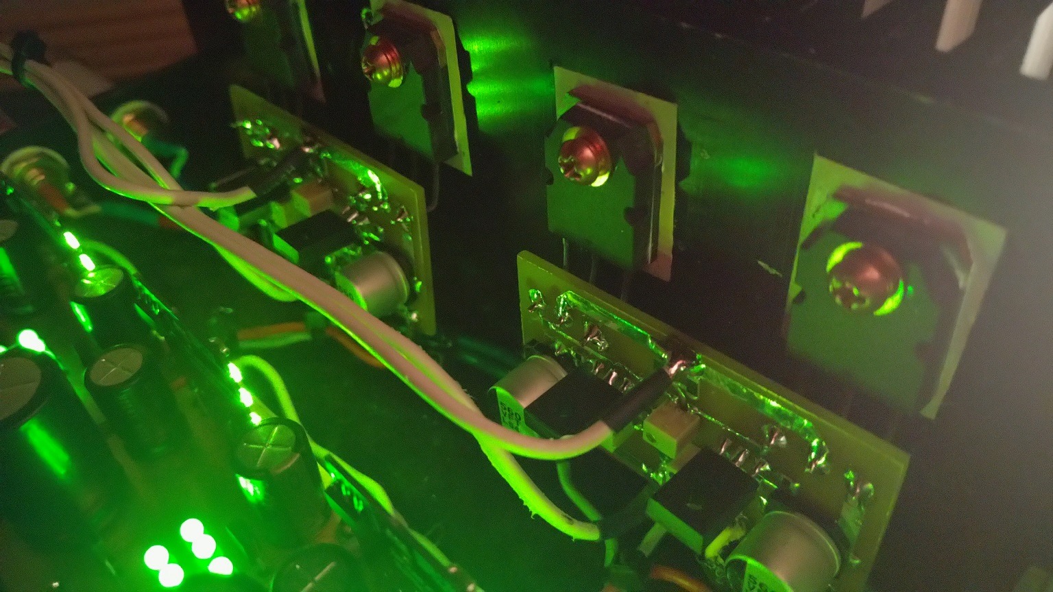

I have also made a couple of amplifiers from JM Plantefeve, but this is the best for me so far, especially when I made these upgrades with regulators and parts.

This should be the final version of the new PCB with tantalum resistors, the dimensions are 62x30mm. This is the smallest PCB I've made so far for an amplifier with discrete semiconductors. 😉

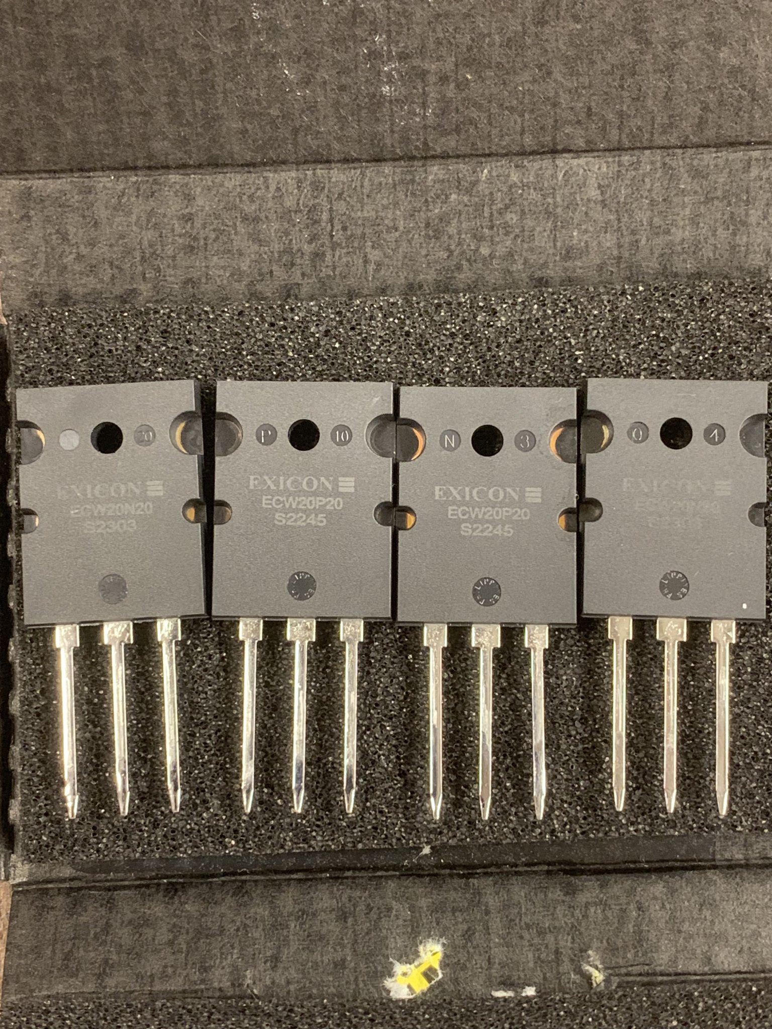

I would like to try this amplifier. I have ECW20N20 and 20P20. Can I use it in this amplifier?

20N20 and 20P20 will be more suitable for the version from post #56 or the classic version with a slightly higher voltage. The IF170A that I use has a lower Vds than the 2SK170A so in that case with a higher voltage the 2SK170A would be a better choice.
