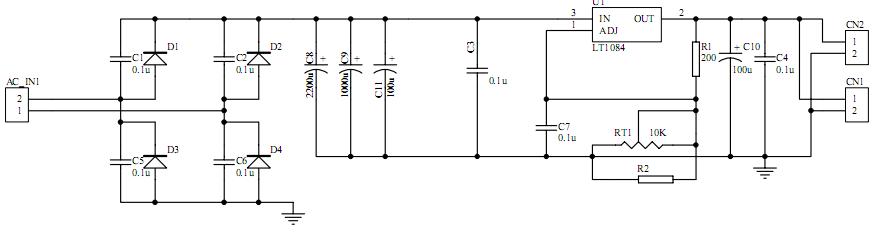

Hi Huang,
Can you post the circuit diagram? or show the back side of the board? I want to see if some inductors can be added for some filtering?. Also can you get a hold of some 10uH inductors?

Hi glt
Here it is.The ELNA-1000uF/35V is out of stock,So I get another instead.
Of course I can get some inductors what you want.

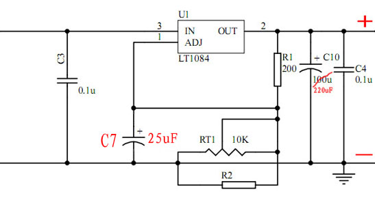

Huang,
Here are some ideas to improve your PS kit:
According to the datasheet, http://www.linear.com/pc/downloadDocument.do?navId=H0,C1,C1003,C1040,C1055,P1282,D3741 C7, the adjust bypass capacitor is too small. In page 12 of the datasheet, it uses 25 uF for improved ripple rejection. The datasheet shows 150 uF for C10. I think The original .1 uF capacitor can also be used in parallel for further bypass.

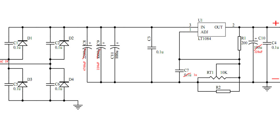

C7 change from .1 uF to 25 uF, C10 change to higher value (just following the datasheet)
Actually, C9 and C10 can be both changed to say 220uF which is a common value
If you can find all Panasonic FM capacitors, those are pretty good with low ESR and widely used by the cost-conscious DIYer. Another appealing (to DIYers) mod is to use ultra fast/soft recovery diodes.

Hi glt
Thanks for you suggestiong.Sorry for I can't find panasonic FM capacitors.It is very shortage in China.I only can find some ELNA or NICHICON FG/KZ.Is the picture correct now?

ELNA or NICHICON FG/KZ are fine too. I just thought Panasonic FM would be available because they are plentiful here in US.
C7 is 25 uF according to the data sheet

Hi glt
What kind of the 25uF capacitance to instead C7?Just like one of the C8-C11?Or use the non-polarized electrolytic capacitor?Is the picture correct now?Thanks
