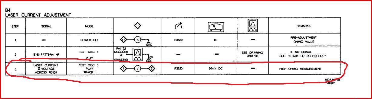

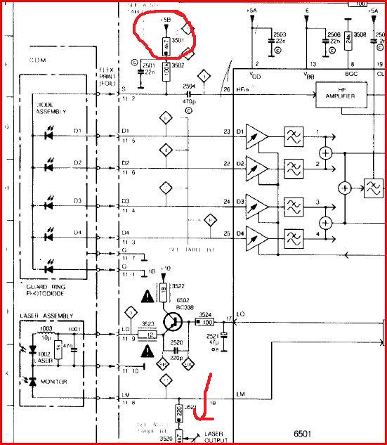

If it's the same as the CD630 then you play a good CD and measure the volt drop across the resistor I have ringed. It should be 50 millivolts DC
The laser power adjustment is arrowed at bottom if that reading is low.

After all that, I dont think that the circuits are the same. Checking in fine detail. Dont think that the manual is available for it, so cant check that resistor, being sure its the correct one, and I dont want to just adjust the power without checking the feed voltage first (I presume anyway) to the laser, surely if the laser was not getting enough power the thing would not read the TOC etc so quickly, or am I wrong.
found the resistor, and all seems fine, reads 51mv across ir, to proove it I gently turned the laser adjust a fraction, it increased or decreased the voltage, so thats fine.
That sounds fine.

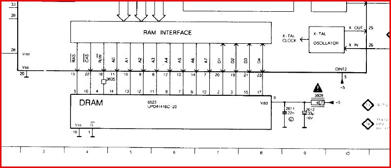

I was looking at the CD630 circuit. It's possible this problem could be caused by faulty DRAM that the data is clocked into and out of... unfortunately there's no way to prove it without swapping the DRAM chip. As always it's worth checking all the supplies, so make sure the 5 volts is exactly (within 0.2 volts) just that on the RAM chip. Also the -5 just above on the SAA chip.

Will check that later, being a novice, sorry for this, where do I need to check the voltage accross? GND and one of the pins I presume on the RAM chip and the same on the SAA chip SAA chip being the filter, is that right?
So it needs to be +5 volts across the RAM chip and -5volts at the SAA chip.
Just want to get this right. So if voltages are correct, I could always purchase a new chip (do you know if they are expensive?) and try that.

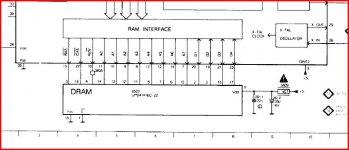

So on the CD630 voltage is 5 volts on pin 9 of the DRAM IC. Also check pins 5 and 28 (in the piccy in post #96). Yours may use a different RAM chip but it will be conected in the same place as this, to the same points on the SAA ic.

The data coming off the disc is unstable, wow and flutter if you like.
What happens is that the data is put into RAM, now once it's there it can be "clocked" out at constant speed eliminating the original variations in "speed".
This all happens in real time, the speed of the disc is compared to a crystal oscillator as an absolute reference, and by looking at the "sync" info in the data off disc to see if it's leading or lagging behind. From this an error signal can be derived to control the motor speed. That's why the CD slows down as it plays, as the laser tracks outward, if the disc rotation stayed the same then "more data" would pass the laser, so the CD format is CLV or constant linear velocity. Vinyl is CAL constant angular velocity... the needle covering more distance" per revolution at the outer edge than the inner.
So RAM is used... and in the dim and distant past I have had rare failures of RAM (as in 1 or 2 failures in all the years). There's no test that you can do to confirm or otherwise, you would have to swap the IC.
The data on all the pins is just rapid 1's and 0's... that on a 'scope look like a blur. All a 'scope might show is if the level on one or more lines were low in amplitude... then it's a case of is it the RAM, or is it the SAA ? And of course the fault may be something different.
Generally IC's are supremely reliable... but the RAM the most likely if there were a problem.
