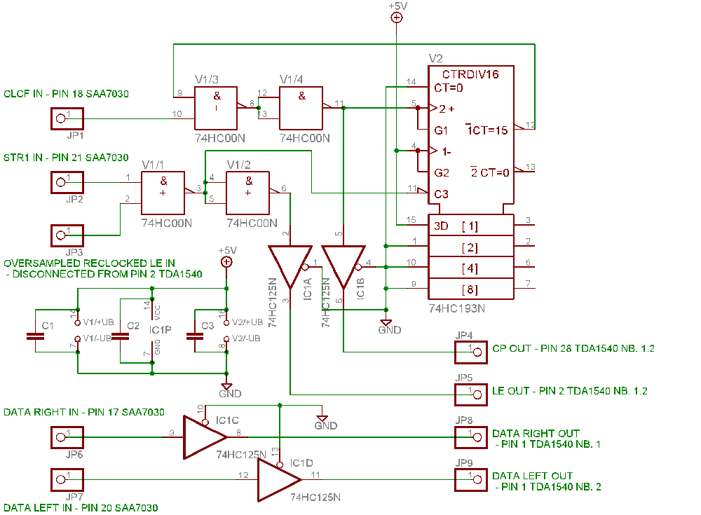

Bypassing the SAA7030 - NOS 1540
Back here to report as promised.
I cut the data clock signal to first 16 pulses, effectively changing the format to 16 bits as in the 1541 datasheet, using a 4bit counter and a few more logic gates. Surprise - no change at all. Still the same rather blurred sound. Clearly, the 1541 takes only the first 16 bits.
After playing for a few evenings with the CD300 -> TDA1541 link, I managed to "discomfort" the 1541. More on that here
My 1541 seems to work for now and I did not want to mess with it anymore. I decided to use the existing 1540 DACs, but bypassing the oversampling filter SAA7030 which causes the ugly overshoots.
I traced back input signals from 1540s. The data signals and data clock go directly from oversampled outputs of SAA7030, while the Latch Enable clock output is reclocked with master clock CLOX first (pin 19 SAA7030), by one of the 7408 AND gates on the player's PCB. BTW, this is probably the reason for the blurred sound from 1541 - I did not reclock the LE signal with the precise clock - I guess the original LE signal has a significant jitter, causing the loss of details.
I tried to feed the 2 x 16 bits signal to 1540s, hoping they were as fool-proof as the 1541. Well, wrong assumption, the resultant signal was perfect for rectangles but seriously messed up for sine. That clearly indicated the input registers disliked the excessive bits. In order to use just first 14 bits, I designed a simple circuit which passes just the first 14 pulses of the data clock.
The NOS LE pulses entering SAA7030 are too wide, almost overlapping the first data clock pulse. I solved that by ANDing the signal with the precise oversampled reclocked LE signal going originally to 1540s - it just happens there is one short oversampled pulse within duration of the NOS wide (jittery) pulse (the remaining three oversampled pulses fall into the NOS pulse gap).
The circuit below is straightforward. The final reclocked (V1/1) (inverted) LE signal presets the counter to 1 (as defined by combination of preset inputs). The overflow output is high (no overflow yet), allowing the input data clock to shift the counter upward. Upon the 14th clock pulse the overflow output (active low) disables the clock (using the NAND gate V1/3). This state lasts until new LE signal presets the counter to 1 again and the counting starts again. I used 74HC125 drivers to buffer the outputs - these could be probably omitted.
I put the three ICs with decoupling capacitors on a small trial PCB and soldered in on the bottom side of the upper PCB.
Now the NOS DAC produces perfectly clean 1kHz squares on the CD outputs. I find the sound much softer and sweeter, the harshness is gone. In fact, it's very close to my Grundig with 16bit TDA1541. Honestly, I cannot tell the 2 missing bits difference.

It doesn't matter whether you feed 14 or 40 bits to the TDA1540, only the 14 bits in the register at the transition of LE get converted.
rfbrw said:It doesn't matter whether you feed 14 or 40 bits to the TDA1540, only the 14 bits in the register at the transition of LE get converted.
Well, that was the case for 1541 which accepted the 2x16bits input. The 1540 was clearly confused until I cut the data clock pulses to 14 only. There could be another reason - perhaps the input registers are cyclical - 1541 cycled twice with the same data (2x16bits), whereas 1540 ended up with messed up information. That would explain why the 0dB square signal was correct - there were only zeros/ones in the input data chunk and the loops did not matter.

DACs don't get confused. They get subjected to an incorrect relationship between data, clock and trigger. The SAA7030 is a 16 bit device. When used with a continuous clock the position of LE will reflect this. When used with a burst clock the burst will be 16 bits long and the position of LE is less important.
The TDA1540 is a 14 bit device. Send it data intended for a 16 bit device with either sort of clock and the sign bit and the MSB of the data will be clocked out of the input register leaving the last 14 of the 16 bits.
rfbrw said:DACs don't get confused. They get subjected to an incorrect relationship between data, clock and trigger. The SAA7030 is a 16 bit device. When used with a continuous clock the position of LE will reflect this. When used with a burst clock the burst will be 16 bits long and the position of LE is less important.
You are right, the word "confused" was not chosen well. Now I know there are standard (continuous, passthrough) shift registers at the input of both 1540 and 1541. When 1541 was fed with 2 groups of 16 bits, it took the identical value of the second group and output correct signal. 16 bits fed into 1540 caused the DAC to convert only the last 14 bits, distorting the signal (the lower 14bit sine fragments were clearly visible on the scope). That is why I had to cut the data clock to first 14 bits only.
The reason I was trying to feed the 16 bits into 14 bits DAC is the faint hope, that perhaps the input register takes first 14 bits only and stops shifting afterwards, waiting for reset by the LE signal. Clearly that is not the case, as expected 🙂
The solution is simple. Delay the data by two sck cycles.
rfbrw said:The solution is simple. Delay the data by two sck cycles.
Thanks for the much simpler solution! 2 D flip flops in 74HC74? In fact, the number of ICs stays the same but the circuit will be much easier to understand and more straighforward.
