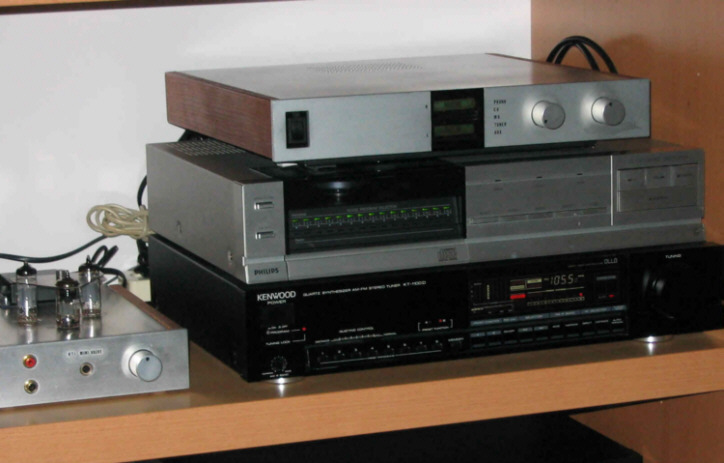

CD 300 with CDM-0 and dual 1540
Now something where its all about: last night, neighbours where having a party, and my wive went for a visit...
After a half an hour the CD300 took off and gave some fine tunes. Have Played otherwise "sharp" sounding disks (Tears fo Fears, Elemental): not so on this :tons: 14 bit "downsampling" machine!!
Didn't know what my amp & speakers where capable of.
now with jpeg

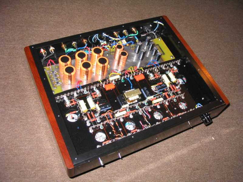

I use a CD-371 for testing circuits, and if i'm pleased with it, i build it in my Marantz CD-50. The CD-104 i have is still being modified. But take a look at the pictures of my CD-50.
Marantz CD-50 modified

Nice mods on Marantz, i see you applied the original Tent PS- scheme for the XO, i did on a CD640 non os also, but later i changed the PS for the XO in this one:
http://home-4.worldonline.nl/~t708955/schem/xoschema.jpg
Music is not so laid back anymore and because of smaller caps (mounted tantalium also) more "rhitmic" sound, i like it above Tents PS which emphasise the high bass a little, but this is matter of taste.
Ehhm, this a different supply scheme. I do'n use Guido's scheme because the voltage regulator he uses generates a lot of HF crap. The good old 7805 only produces a spike at 78 Khz, but the 100nf caps take that away, buffer it with about 1000uf and you have a pretty clean supply.
In my humble oppinion a good outputstage gives a far better result than a new XO, mesured and listend...
