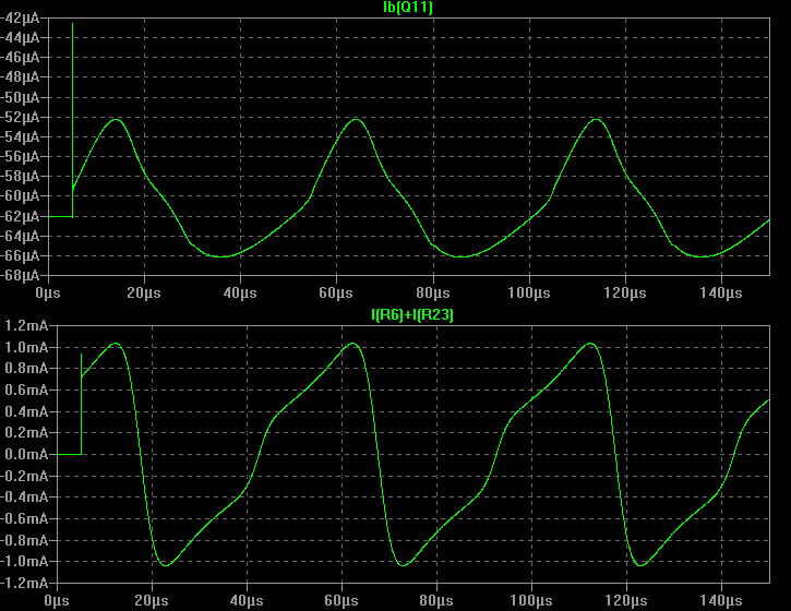

Now look at the currents "stolen" from the ~10mA CCS for either case at 20kHz and same load, to drive the MOSFETs, which one do you prefer (look at the magnitudes)? 15uA or 2mA error current sure make a difference for a 10mA CCS in terms of nonlinear error magnitude. To unload the high impedance node is always preferable for controlled conditions, you still can load it deliberately, resistive to lower DC gain and/or capacitive to shift the pole to where you need it.Lumba Ogir said:MOSFETs are genuine transconductance devices, where the the input voltage and the output current are directly related, buffering would make the conversion less accurate (meaning decreased linearity). So the driver has to provide the necessary current, cascoding helps in this regard too. Cascoding has many benefits not just stability.

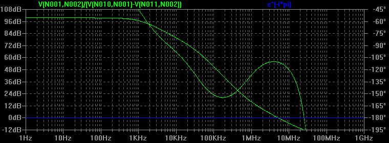

We are focusing on different parts of the whole picture. There are two situations. At low frequencies where the gate impedance is very high the system behaves as you described, but when the impedance becomes lower with frequency (in comparison to the collector-emmiter resistance of the driver) the system starts working as a transconductance device. The changes in voltage between the input and the output make the current change through the driver, and this current can't go into the ccs so it gets stuffed (integrated) into the gate of the driver. The pole i'm talking about is the frequency at which the system changes its behaviour.
Cascoding raises the "early" collector to emmiter resistance of the driver and makes this frequency lower as the output capacitance is left unchanged while the driver resistance is increased, so the point where they meet is at lower frequency.
Adding a buffer before the gate makes the output impedance look bigger (roughly multiplied by beta) so the frequency where they are identical (from the driver's point of view) becomes higher. This can also be seen as the gate seeing a lower driver impedance instead of the driver seeing a higher gate impedance, but the consequences are obviously the same.
What makes me think there is room for improovement is that this frequency is inside the audio band on the non-cascoded non-buffered version, and this may introduce a change in the character of the amp. Being this at (roughly) 1KHz it might "split the midrange". No idea if the effect is actually audible, but the circuit changes its behaviour completely there.
I have jsyt done a quick sim to see if there was a change between the distortion at 500Hz and 5KHz and it isn't there, so i might be wrong.

Ion,
Triangulation of a square wave, always a good indication of poles, lies around 42KHz IIRC. There is rounding of the square wave at 10KHz to around 25% into the horizontal.
This would indicate that the pole is probably around the 20KHz mark. I would expect it to relate to the CCS current and the gate parasitics, let us assume 700pF.

Hi Ion,ionomolo said:KSTR, your plots look uglier than mine, are you sure that you are running the mosfet hot enough?
EDIT: I have just noticed that your plots show hysteresis. I can't see a single reason why it should be so. I did read that one of the IRFP IR mosfets (i don't know if it was the P one or the N one). IR constantly says that these aren't suited to linear. I think that the post talking about this phenomenon said that it did not affect the fairchild ones, which also state that they have "good linear characteristics".
The mosfets (2 per leg, 4 in total) run right at their typical safe linear power dissipation of ~30 Watts, with ~30V that's 1A each. The "raggedness" in the waveforms comes from that change of Cdg vs. Vds. When I load the output with current only (zero voltage swing) I get the expected quadrature relation between mosfet gate and drain currents. This again would be the point where cascoding the mosfet could make a difference, higher loading though, but more linear, more true "cap-like" (unless it goes into cutoff). OTOH when Vds is high enough, then Cdg is low and quite constant, therefore the problem is mostly relevant under high voltage swing close to the rails, not the usual situation with music.
In the lower plot there also is the effect of the sliding bias which already kicked in which additionaly distorts the waveforms.
