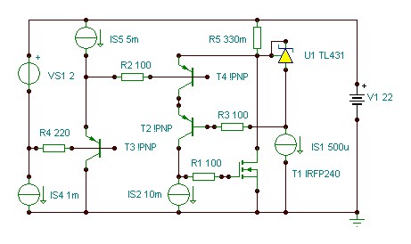

Now here the basic circuit idea (several key points still missing, of course). I continue to be quite thrilled from the performance/effort ratio it promises. Compared to my last foray into D2S realms (also in a circlotron config) this circuit is much simpler and behaves much better in several aspects (not in all, there are alway trade-offs). The circlotron is an old concept that deserves more attention, IMHO. It's not popular probably because the more complex supply. But circlotron + CPF with (a bjt master tranistor) seem to team up perfectly in the class-A domain... it's about time that I build this one i think, to get my feet on the ground.
- Klaus

AKSA said:
Ogir,
What ARE you trying to do in that little circuit?
I can't figure it out, and it's irritating me......
Hugh
It seems relatively close to the one i've just built. T2 cascodes the driver at the voltage of the zener referred to the output. The zener is biased with a ccs and the output is buffered by an emmiter follower. The rare point is that the amplifier has no output, instead it is shorted to the supply, but this must be a mistake.

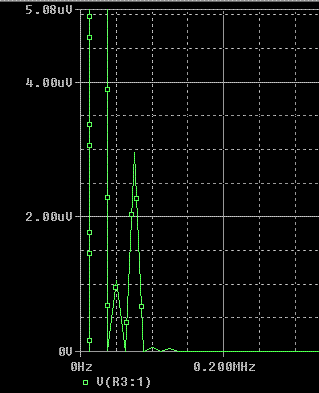

I've found that cascoding the driver cuts the [simulated] distortion by half and sends it to 8 ppm (0.0008%) at 20KHz on a 8R resistive load at full output (12Wrms).
Mine does not use the emmiter follower and cascoding is done by a couple of resistors (1K to the output and 10K to V+) plus a 100n cap in parallel with the 1K one. Mine is single-ended on a 2A sink.
Now i'm getting problems with ringing. It is extraordinary sensitive to the power supply voltage (for example a high positive voltage induces ringing at the bottom, while a low positive voltage induces ringing at the top). Do you have any idea about what is causing this effect and how could it be fixed?
Do you have any preference for ccs (both power ccs and small-signal ones) I'm using the one with two transistors and two resistors that uses Vbe of the programming transistor as a reference. Of course complexity-no-object, only performance.
BTW the cascoded amplifier sounds terrific as long as it does not get close to the ringing voltage (+/- 8-10V with +/-20V supplies). It seems to show all the detail in a way it becomes consistent with the music. It is also both neutral and warm as if it let untouched the original warmth of the music. Really really really good. No tubes so far.
EDIT: In simulations cascoding the driver removes mostly second harmonic (6 ppm instead of 15), but keeps the rest untouched so the subjective effects won't probably be spectacular.

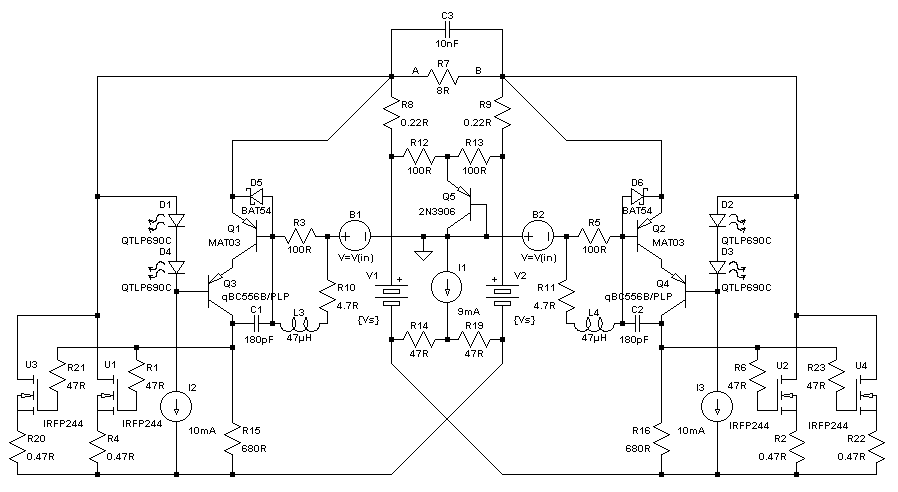

I have already tryed the non-cascoded amp and it's my current reference, but i still want to break my head a little bit more on it.
Spice confirms what you are saying about cancelling even harmonics, but the final level of everything is so low that it's worth a try.
I tryed to pm you sometime ago you because i was doing a class A chipamp and thought about using an output stage with values very close to the ones you suggested and didn't want to post anything you had developed previously. Anyways this schematic is provisional and is pretty different from the initial one, so i hope there won't be any problems if i post it here.
My quest for megalow distortion is not aimed at avoiding distortion itself but rather at avoiding intermodulation, that's why i try to keep the amp at very low distortion upper the audio band, because intermodulation products of frequencies above 20KHz that all sources give and all filters pass because they have a finite slope would fall in the middle of the audio band.
I have to say that i thank a lot all the help and advise i'm receiving from you and all the forum members.
PD: Sorry for posting the most untidy schematic ever.
PD2: The voltages may need some adjustment to prevent this from being a 160W heater.
PD3: I'm still looking for a good voltage source for the cascode, so all the suggestions for it will be very useful.
EDIT: The transistors are what i have on hand and what i have on spice.
  • amp8.pdf
